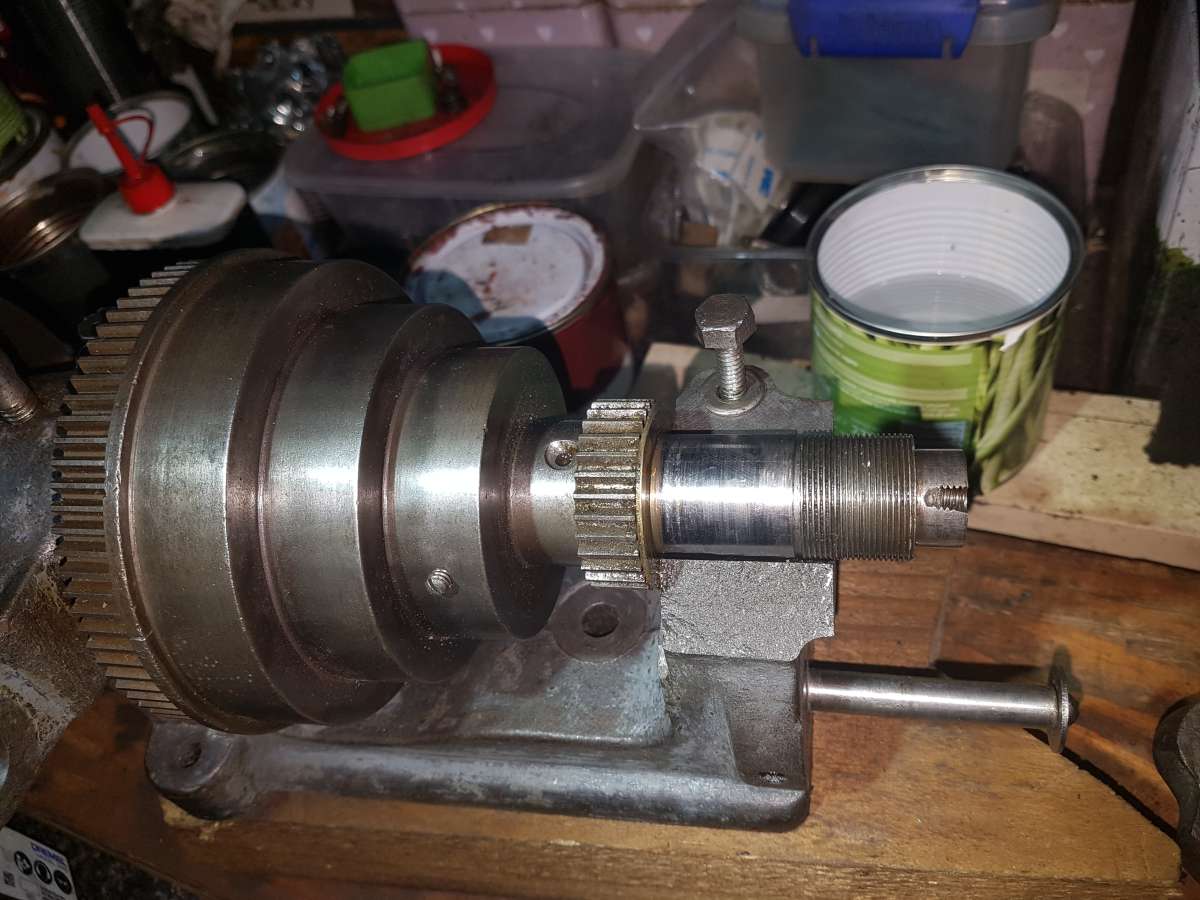

      Hey guys, Ive got a ‘scrap’ Zyto lying around that I had thought  about restoring. Its been a bit knocked about, a bit neglected and a bit ill used and has a fair bit of damage as a result ! Most of it I can deal with in time but the MAIN problem halting progress is the Headstock Casting is broken ! The rear bracket that supports and secures the spindle has cracked right through and the top can be removed after the tightening bolt is removed ! I am looking for advice on how to repair this or if this is very difficult or expensive then would a undamaged headstock and spindle be available ? My thought is that someone out there might have just what i need. ? Ive looked into repairing it and it seems unlikely with my equipment and as soon as I get a fab/eng shop to look at it then this will be too expensive considering the value of the small lathe ! Welding needs pre-heat/special rods and even then might warp the headstock, brazing seems like the best option but again requires pre-heat and risks warping the headstock. Using some form of brace combined with small bolts or screws to join the two parts further combined with some form of Liquid Metal eg J.B. Weld MIGHT work but Its not a real option as far as I’m concerned although I’ve never tried ! Your thoughts on this are appreciated. Lastly Milling a new Headstock and jig boring it etc could be done but yea :/ I’m not that inclined as i don’t really have adequate facilities to tackle a precision job like that ! My best option is that someone has a Zyto partially stripped for spares for a ‘Good’ Zyto and has a spare headstock casting ! If anyone can help I would be very excited to hear from you ! Kind Regards all and stay safe and warm this winter !

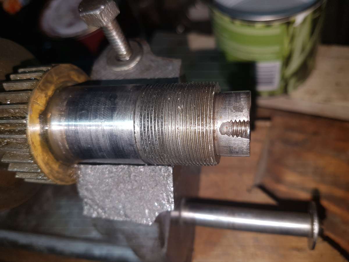

          Pictures would be helpful but having owned a Myford ML4 which Tyzack used to clone the Zyto, the failure you describe is common in these lathes that pinch the spindle to adjust clearance. Owners fail to realize that cast iron will only flex so far without a suitable spacer in the gap to close down onto.
          Whereabouts in the country are you? It might be possible to cobble a repair together to keep you going while you search for a replacement as a short term solution.

            I agree with Brian … detail pictures would help a lot
            Generally speaking, though: I would tend towards machining the lower part down to a flat surface and making a new cap retained by two fixings.
            The original is just plain cheapskate design.

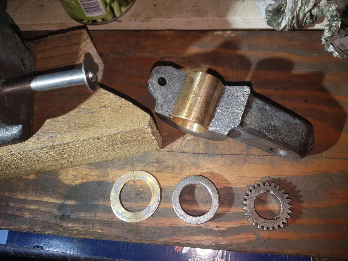

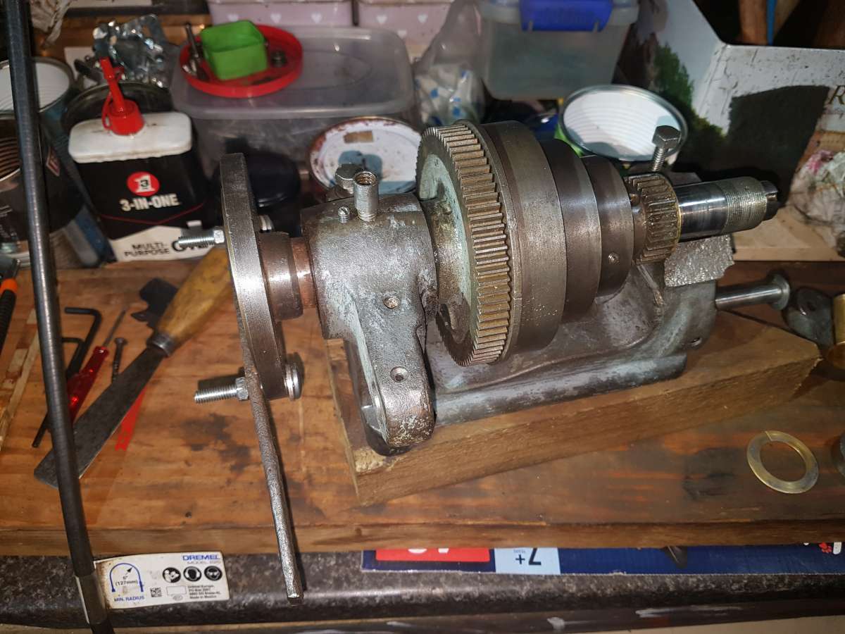

              Zyto Head Stock 001Zyto Head Stock 002Zyto Head Stock 003Zyto Head Stock 004

                      Could be quite a project to fix all the problems.
                      At least you have another lathe with which to do the turning jobs.
                      Quite crude, but if you could clamp the broken cap in place, firmly, (having spotfaced it) could you drill and tap for a second bolt to hold it in place.?
                      The crystaline nature of the break means that you have myriad location points (A method now used on fracture split con rods and caps in internal combustion engines)

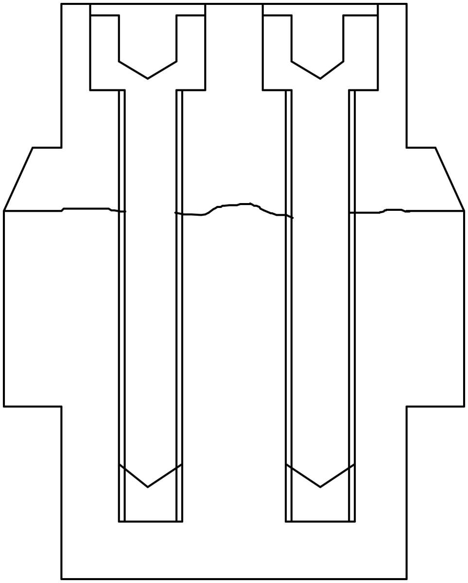

                            I would agree with simply bolting it back together across the break. That is the only way the amount of work is not excessive for what it is.
                            The first thing is to be sure the break is indeed clean and undistorted. Unless there is next to no gap when exactly seated on the bearing, success is unlikely because it will not clamp the bearing diameter uniformly. Then, I would suggest two bolts rather than one. It needs careful assessment to ensure these are positioned in maximum metal for strength in the cast iron.
                            Two possibilities are conventional hex cap screw fixing with a plain hole in the top part clamping the parts together, or instead threading right through both parts with well-aligned holes. The latter distributes the forces better in the weak cast iron, but will of course not clamp tightly. It may help in this respect if bolts are used with the heads tightened onto the top face. This will pull the bolt upwards and so largely remove the inevitable slack due to the thread clearance.
                            In this kind of situation, I find it a good idea to mull things over for a good few days to spot the potential snags.

                                            Getting back to the original question, Paul
                                            I was interested to see that others proposed bolting-up the fractured surfaces
                                            <u>There is a lot of merit in that</u>, but the problem is <u>then</u> that the resulting hole for the bearing will be some as-yet-unknown shape and size [because it was previously used, and abused, for adjustment.
                                            By all means try it … but you may then need to line-bore the resulting hole, and find an alternative means of adjustment.
                                            None of this is impossible … it’s just *rather*  difficult !

                                              It is unlikely the cast iron has been bent much, if at all. After all, it broke rather than stretch. So if the two parts are clamped round the bearing and shaft, the aperture should be little worse in circularity than it was when previously tightened to adjust the clearance. Certainly contact in the bearing will not be uniform, but neither was it before. I seem to recall that old sewing machines used this method of bearing adjustment, and they seemed to last for ever.
                                              It boils down to how much effort it is worth for something that will never be particularly good. Setting it up, clamping the broken faces tightly together, drilling two holes and threading them right though, and fixing with bolts or screwed rod should only take an hour. It might just work, and be instructive into the bargain.

                                                If a repair is attempted I’d go for a bolted and bonded approach. Similar to Macolm’s sketch but I’d use cap head shoulder bolts. These act as a dowel. Clamp broken part in place. The fracture surface will self align. Drill one hole tapping size (M4) through both parts. Then tap body and drill clearance in the broken half. fit plain screw to hold it an repeat for second fastener. Then enlarge (drill) and ream hole in both parts to depth and diameter (5mm) of shoulder bolt. Fit first bolt, repeat for second hole. Ideally this would be done with the headstock set up on a mill. Degrease, check fit and then finally assemble using loctite retainer (or similar product) on fracture surface and fastners.
                                                Robert.
