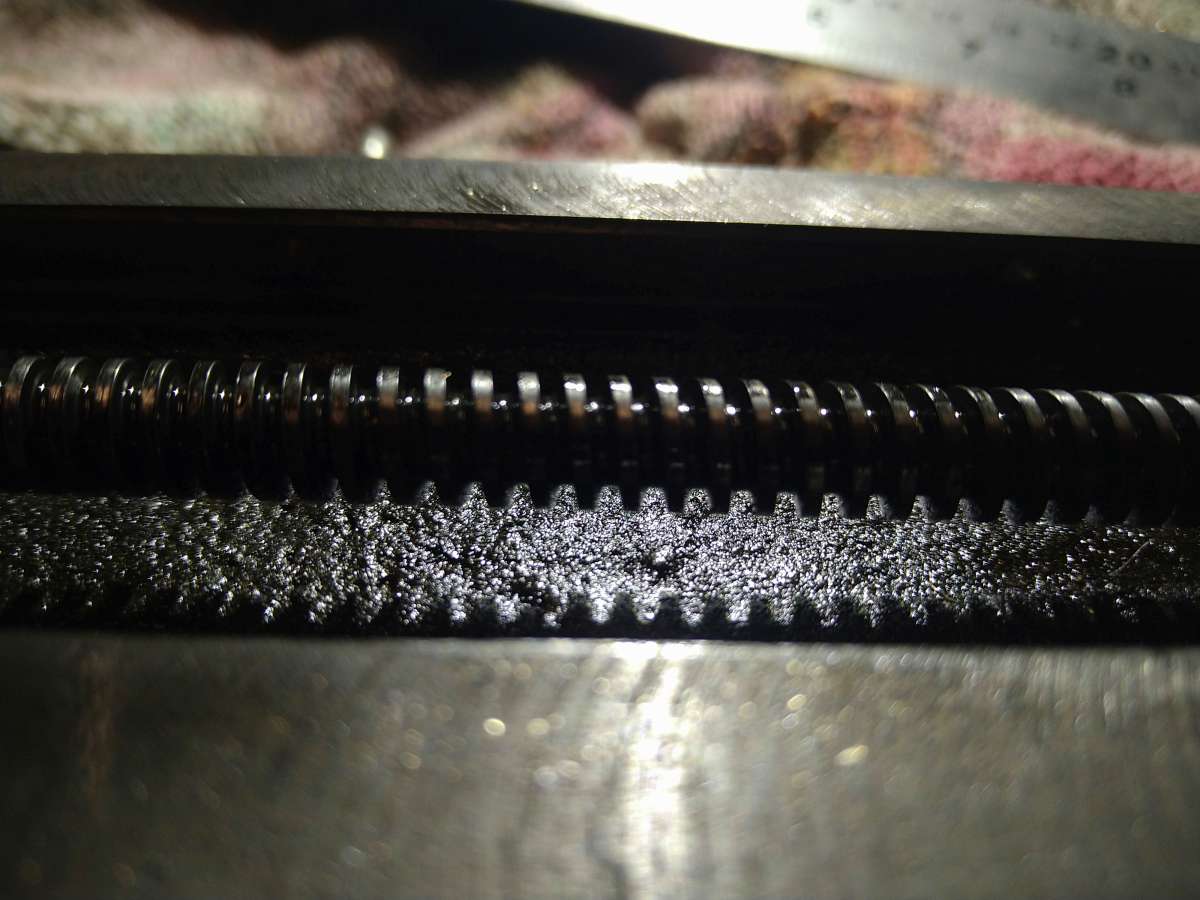

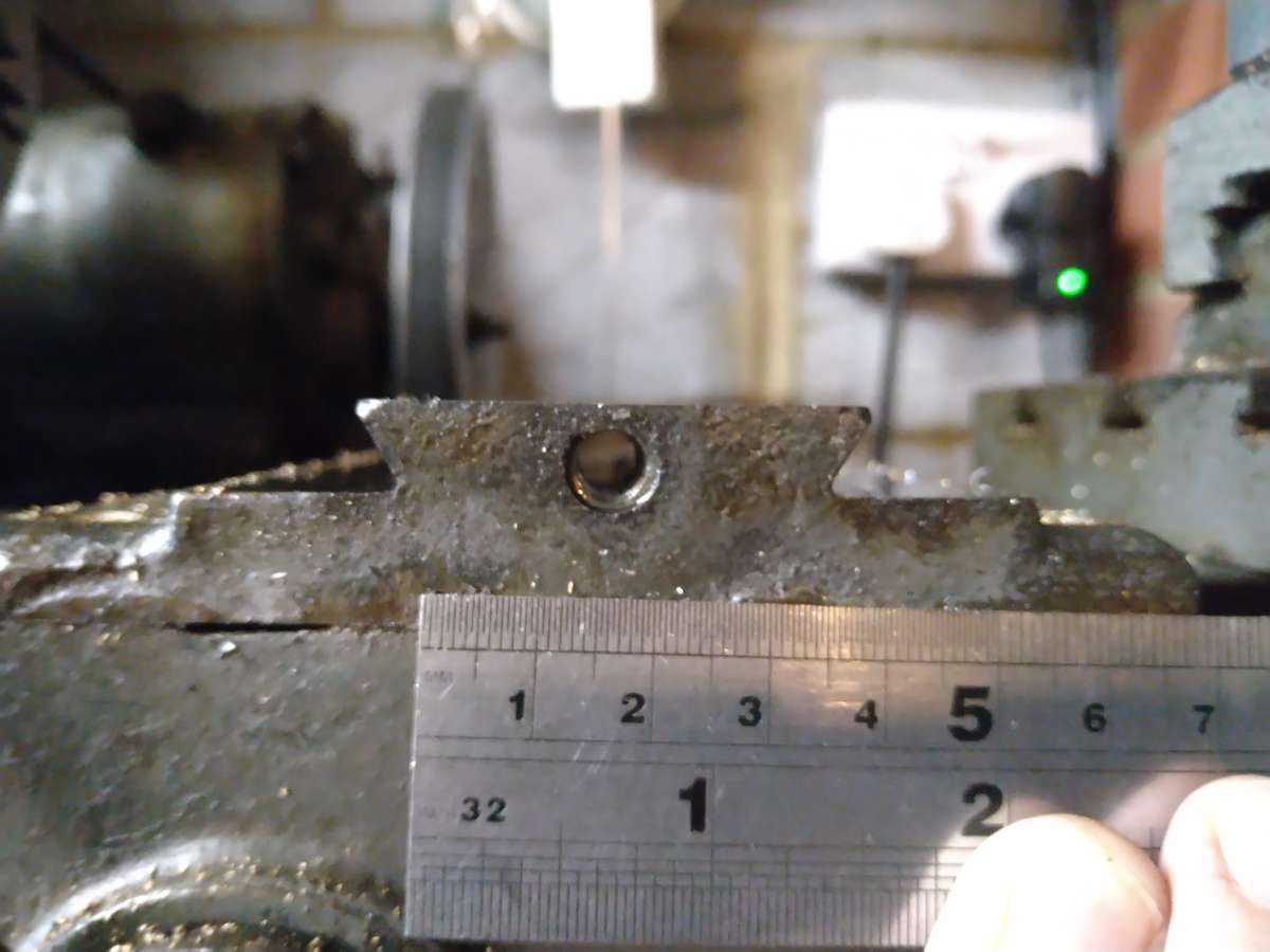

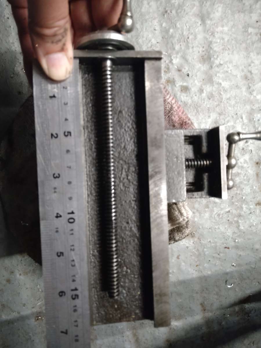

                                #755373
                                ianday1972
                                  @ianday1972
                                  I’ve had a better look at it tonight, there’s about 25thou free movement in the cross slide along most of its travel. There’s a point where it tightens up when it’s most of the way forward (away from the operator).
                                  I’ve attached some pictures, it may be Acme thread as it looks like there’s an angle rather than square, what do you think?
                                  As you can see there’s not much material to play with where the thread is cut into the casting. Bazyle I think I follow you with your suggestion and I was thinking something similar myself although probably not as well worked!
                                  Ian

                                    #755394
                                    Hopper
                                      @hopper
                                      Can’t tell if it’s Acme from those pics. You need to photo it in focus in good light with a piece of paper behind the screw so the thread profile is visible. But if I had to guess I’d tend to think it might be Acme but not sure.
                                      If you bore out the casting and fit your own Myford style flanged nut with retaining screws, you can use whatever thread you like as long as it matches your new screw. Acme is easier to buy threaded rod and taps for. Square thread not so much.

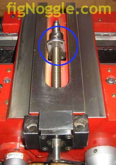

                                              #755487
                                                Now the worst has been revealed, the screw running direct in the casting, triple yuk, is it possible to attach a nut running inside to the cross-slide?   This is how ‘better’ lathes are made, the advantages being backlash compensation and being able to replace worn nuts.
                                                This example is of a mini-lathe conversion, where the simple nut provided by the manufacturer is replaced by a ball-screw.  It shows the principle, replacement nut ringed in blue:
                                                figNoggle
                                                Then the nut is attached to the slide.  Lathe nuts aren’t complicated: this example from a mini-lathe.
                                                https://littlemachineshop.com/images/products/480/1203.480.jpg
                                                I’m not familiar with the Zyto, and can’t say how easy or difficult the mod would be.  Zyto did what they did for cheapness, not because it’s best practice.   Remarkable the lathe lasted this long before wearing out.  Is it time to replace it?
