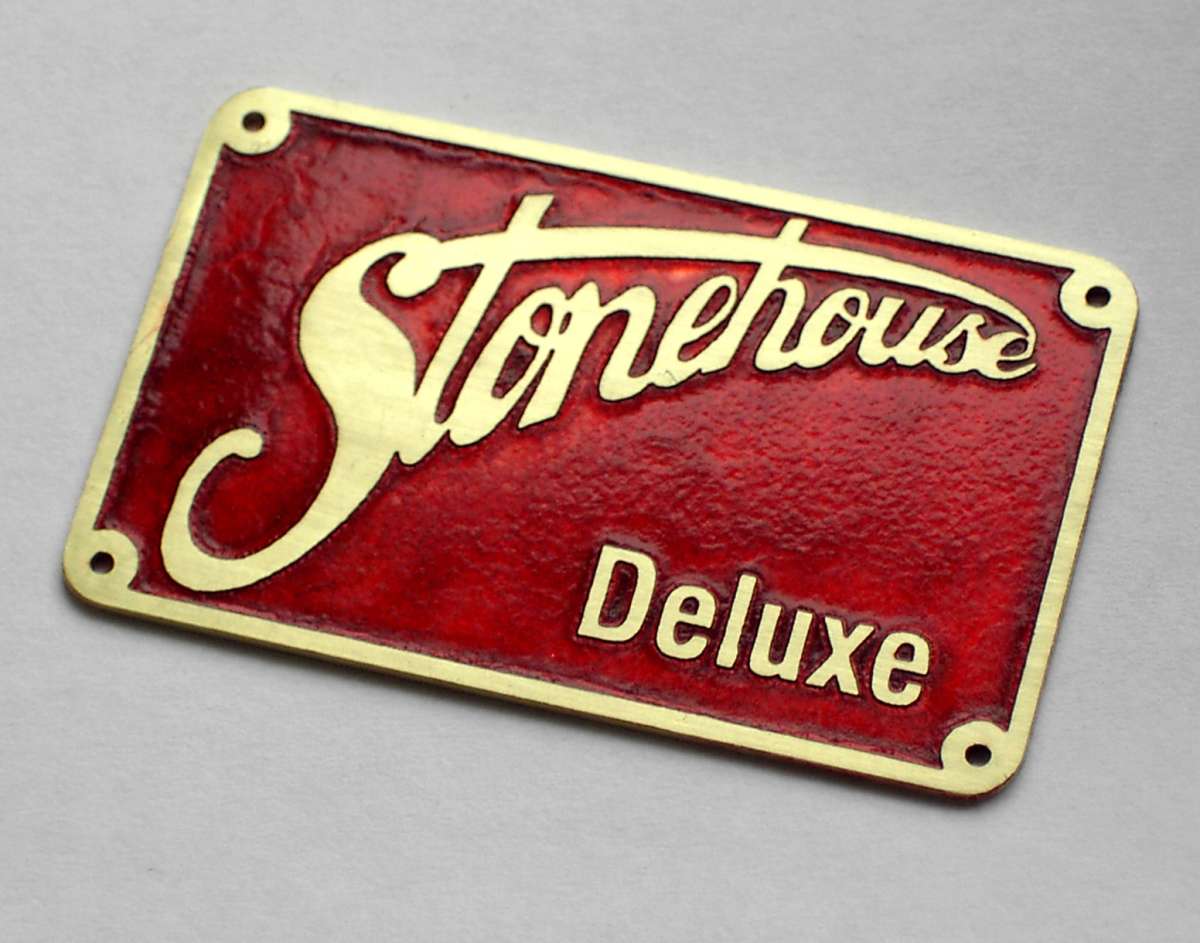

                                I used to use ferric chloride for PCB etching but when it got too expensive switched to hydrochloric acid + hydrogen peroxide. It’s fast acting and I also used it to etch nameplates in brass. It gives a good depth for cold enamel filling and a precise edge without undercut. I’ve also used the same mix on aluminium enclosures. Not tried it on zinc, though.

                                  Thanks Mick.  What are you using for the mask on brass nameplates?
                                  #751492
                                  Mick Bailey
                                    @mickbailey28509
                                    I use the toner transfer method. A laser printer is used to print onto gloss inkjet paper. Using a domestic iron set to cotton, the paper is placed printed side down onto the cleaned and degreased surface and the back ironed thoroughly. When cooled enough to handle the paper is soaked off in warm water. It peels away to leave a thin residue which is rubbed off.
                                    Once etched to a satisfactory depth and rinsed off, the toner resist can be removed with acetone or fine steel wool. Very little etchant is needed – much less than with ferric chloride. I use a shallow plastic tray and rock it to agitate the solution over the surface.
                                    The laser printer settings should have any toner saving option turned off and be set to print at the highest density
                                    Some people print onto glossy magazine pages with good results. I havent tried that. To economise on photo paper I cut a piece out about 1/2 inch bigger than the size of my pcb or nameplate. This is then fixed to a sheet of regular paper using gumstrip (the brown paper sort you lick) where the image is to be printed – just across the top and bottom edge and this is fed into the manual feed tray.

                                      Mick Bailey
                                        @mickbailey28509
                                        Here’s a guitar amplifier badge from when I was building music equipment. I wanted the look of a casting so the etch was quite deep. It was an early attempt and my etchant was too strong, though it etched in just a few minutes with the hard brass sheet I used for clocks.
                                        Nameplate</p>
                                        #751680
                                        MikeK
                                          @mikek40713
                                          Look good, Mick.  Thanks for showing.
