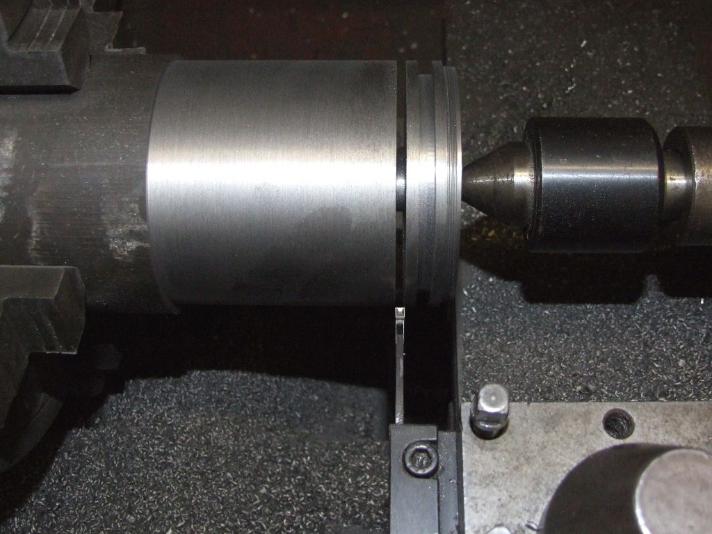

                    Anonymous
                      Posted by Robin Graham on 17/05/2020 00:21:57:
                      My question is – can I part 3" diameter with the right tool and technique, or am I wasting time trying?
                      Shouldn't be a problem. Although I didn't completely part off the item shown below due to the overhang and tailstock support I had no problem cutting the groove:
                      The OD is 3-3/8" and material is cast iron.
                      Andrew
