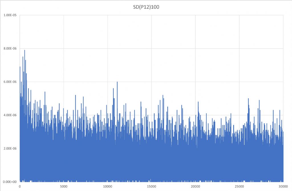

                    Now have first results from the lash-up, without amplitude control other than varying the drive voltage to the L298 that drives the Helmholtz coils. The trailing edge of the centre opto pulse clocks a D-type which is connected as a divide-by-2. The Q and nQ outputs are connected to the L298 control inputs to set the drive direction. The D-type toggles on the trailing (+ve going) pulse edge. The amplitude opto at the moment is just driving the "set" input of the D so that it "knows" which side the pendulum is. Initial tests were done with the supply voltage set to 7.5v which is a bit more than the minimum value to make sure that the 5v regulator that feeds the logic and picPET works. This proved to be more than enough to drive the pendulum to a maximum amplitude of 34mm (target 20mm) so plenty of drive in hand – I think I need some resistance in the coils to reduce the current. As the L298 drops nearly 2v in both sides of the drive the coil voltage is ~3v and current about 60mA. Should be around 40mA at target amplitude. The plot above shows the standard deviation of the pendulum period averaged over 100 successive measurements. Here the values are significantly less than 10us and of the same order as I was seeing in run-down tests without impulsing. The combination of the new spring, more rigid pendulum rod, and revised impulsing method seems to have done the trick. Now I can make progress!

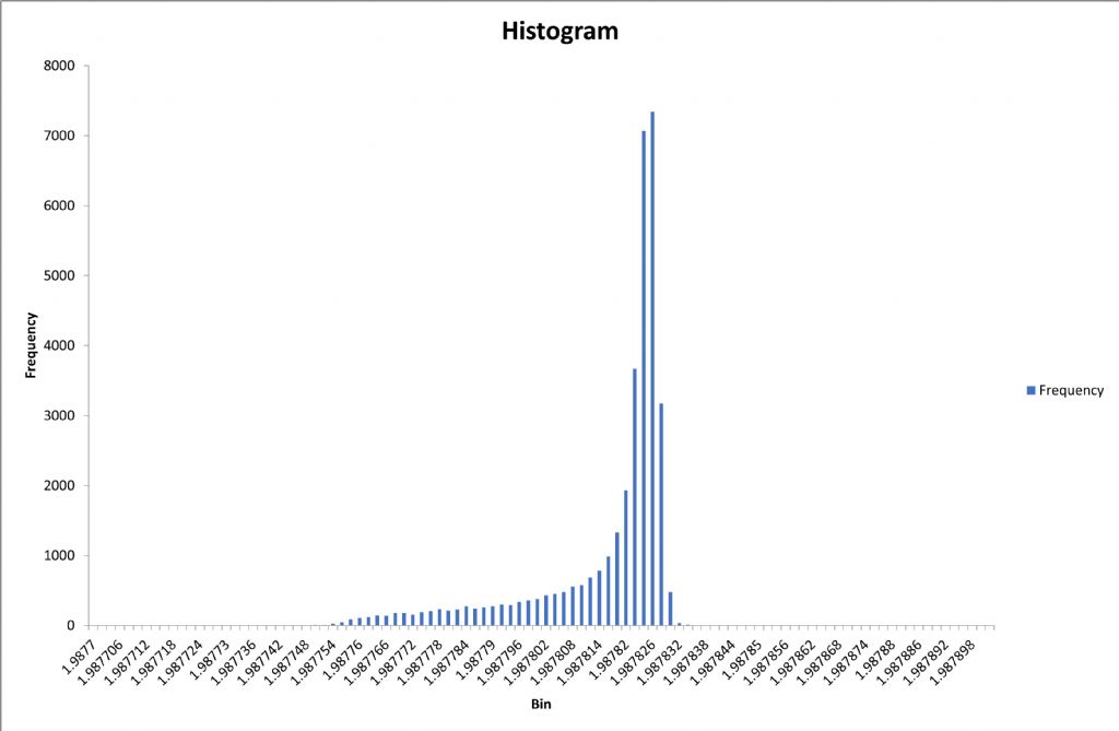

                      And here's the histogram of the period.

                        Posted by John Haine on 01/05/2023 11:48:36:
                        Fascinating – I'd never have thought of the recoil trick.
                        Does applying recoil explain the bias towards shorter periods shown in the histogram? Or could it be caused by the amplitude control system?
                        Although the histogram shape suggests something isn't quite right, period only ranges over about 100uS, which is good in my experience.

                          The tail at the left is because the run started at a lower amplitude which built up to a steady-state value about 20,000 seconds in.

                            Posted by John Haine on 01/05/2023 12:58:58:
                            It's remarkable how long pendulums take to settle after a cold-start. By default I ignore the first 200 beats, sometimes more.
                            I've begun planning my start up procedure, which may take ages, mainly because the bob has to stabilise twice. Briefly:

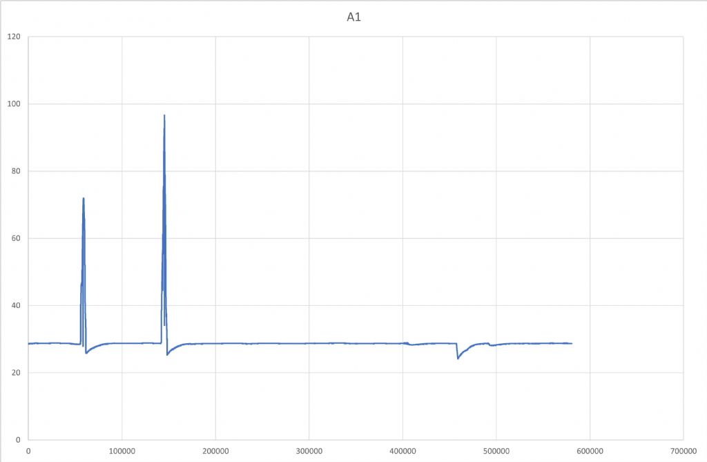

                                Having bodged shading all round the clock I logged a long run, here is a plot of amplitude vs. time over nearly a week.
                                Most of the time it jogs along at ~28mm but with occasional glitches. The first two are a day apart, and after these I added some extra shading. Then we had a couple of dull early mornings so there was little change, but you can see a slight wiggle just after 400,000s. A day later there's a rather bigger one at ~460,000s. With this and some additional measurements using some special logging software that gave a real-time amplitude display I finally worked out what's going on.
                                Basically, the photo-interrupter is (no surprise) sensitive to ambient light. As the pin on the bob breaks the beam, because the beam has finite width the intensity of the light reaching the sensor ramps down as the beam is occluded, then ramps up again. Somewhere on the ramp the internal schmidt triggers. However the sensor responds to a wide wavelength range including the visible light, though the LED radiates mainly IR, so ambient light raises the whole sensed waveform up, and shortens the apparent pulse length which is interpreted as an increase in amplitude. This isn't real of course as the bob couldn't possibly respond this fast. There's also an apparent period error.
                                What's interesting is that there is also a real amplitude reduction from which the pendulum slowly recovers after the light effect has stopped. This is because the illumination does actually reduce the pulsewidth, and that in turn reduces the impulse for as long as the illumination by direct bright sunlight persists. With the real-time amplitude (actually pulse width) logger, I can see that actually the sensor is affected by quite sall variations – for example if I stand in front of the pendulum. So I've introduced another environmental influence on the pendulum! Ho-hum.
                                Apart from putting the whole thing in a light-tight box, there are a couple of simple ways to reduce ambient light. One is to fit a filter that only passes IR in front of the photo detector – I've found a source of this and it could be an easy win. The other is to put a collimating "tunnel" in front of the sensor to reject light not coming from the LED direction – that's a bit harder as it makes the gap narrower.
                                #646491

                                  Posted by John Haine on 25/05/2023 18:23:27:
                                  If your sensor is sensitive enough can you move them further apart before adding the tunnel? I happen to have just ordered a sensor (for something else) which said it has up to 1" range and I had assumed I would use it at 1/4" but now you are making me rethink ambient light complications.
                                  #646499
                                  John Haine
                                    @johnhaine32865
                                    Bazyle, exactly what I'm thinking if the filter and short tunnel don't work.
