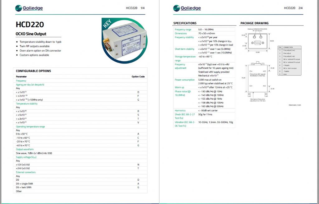

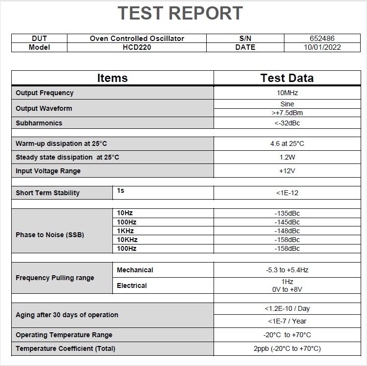

                  Posted by Michael Gilligan on 15/02/2023 00:53:43:
                  There appear to be contradictory ‘stability’ figures in the description, and its easy screwdriver adjustability seems rather counter-intuitive for something intended as a reference device.
                  A useful reference for CB radio's maybe… else its just an exercise in frustration! All high quality Ref oscillators will have some form of adjustment but with limited range – the NDK osc you reference can be changed by 500Hz typ with that trimmer, which is a ceramic trim cap, with its own poor temp performance and mechanical stability. Would not touch it with a trimmer screwdriver – or a barge pole for that matter..
                  One of the OCXO's I use as an example:
                  And the test sheet:

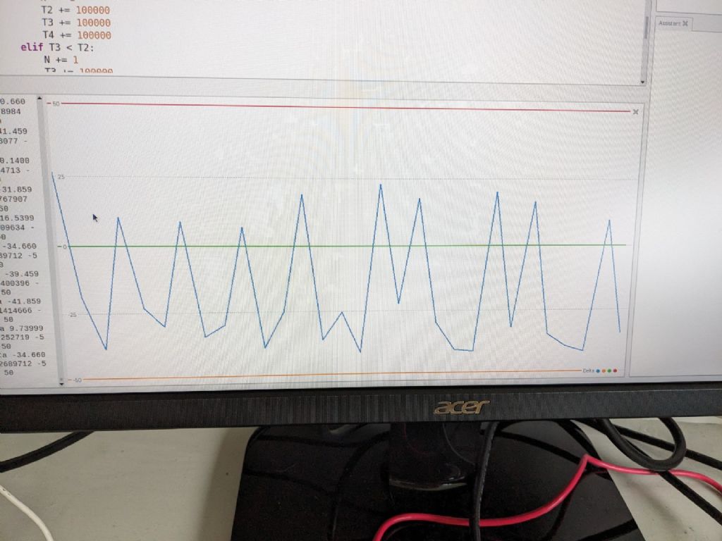

                                Well not going as well as I hoped – I feel for Dave in his frustrations! Looking more at the data to try to extract some regression coefficients I got increasingly concerned about the apparent noise in the time measurements and by extension in the amplitude calculations. After quite a lot of playing around there are a number of things to investigate.
                                • I think some of the problem may be accidental rounding in the Python code that reas the data from the picPET. The pP encodes each timestamp as a 13 digit BCD decimal with a decimal point, so 7 digits after the point and 6 before. The count rolls over at 100,000 seconds and the code has to detect a rollover between any two edges and adjust itself to add an appropriate number of 100,000 seconds. I was storing each measurement as a float but the precision of that in Python is limited in the number of decimal digits. When I looked at some of the recoded data I could see that though there were 7 decimal places the actual precision was more like 5 as some rounding took place. It seems that I should be using "Decimal" types rather than float which is the next thing to try.
                                • There's also electrical noise on the sensor and worse perhaps on the picPET. The whole thing is powered from a switched-mode 12v wall wart, with a buck converter to 5V for most of the electronics and boost to 18v adjustable for the drive coils. I'll see if I have a 12v transformer type wart and fit a linear regulator for the 5v.
                                • I'm also concerned that there could be some pendulum wobble, either in the spring compliance or the rod bending (or both!). Whether that matters I don't know – I think it would show in the ADEV plot so maybe not. But the measurement noise must be affecting the ADEV, of course the snag with electronic monitoring is making sure that I'm looking at the pendulum and not the tester!
                                Ho hum.

                                  Welcome to my world! When a pendulum clock is tested in the ordinary way, I suspect a multitude of sins are covered up because many errors tend compensate out on average.
                                  Collecting a lot of fine-grained data, especially with a Precision Event Timer watching individual swings through a statistical microscope reveals a multitude of anomalies, as does watching drift and amplitude vary over longer periods. Possibly many a clockmaker would be shocked to see just how variable clocks are when closely inspected. No shame in it, because even the world's best timekeepers have limitations. I found recently that Atomic Clocks don't have wonderful short-term stability, and are often complemented by an OCXO which do. The OCXO doesn't have excellent long-term stability, but that part of the problem is covered by the Atomic Clock. Team work!
                                  Which picPET are you using? Tom provides a number of variants and one of the others may be more suitable. (An advantage of my ardPET is the source code being available allows a C-savvy user to program the output in any format.)
                                  I've managed to avoid using 64bit floating point in the Arduino by working within the limits of long integers, for example using a pair of them to represent seconds and microseconds rather than a narrow float. Likewise, I've just avoided python Decimal, which is good because they're slow to compute and the numpy module is designed for speedy doubles. Special care is needed to avoid and spot underflow and overflow problems.
                                  Electrical noise is a problem, but I'm pretty sure most of mine is coming from the pendulum and the beam break sensor. My pendulum is relatively poorly made. In particular, the suspension is prone to twist whilst the spring is also liable to be biassed by levelling and alignment errors. Most test runs after a mechanical adjustment show prolonged small changes that gradually disappear and different oscillation modes. I think these are due to the suspension 'running in'. The different oscillations appear when impulse is increased and are probably due to the rod 'twanging'.
                                  Understanding "wos goin on" is interesting, but only important if the goal is a high-performance clock, one delivering high short-term and long-term stability. That can be built by me on the cheap!

                                                    A bit more experiment seems to confirm that I have a case of the dreaded wobbly rod. I modified the logging code to just compute and print successive periods, or rather the deviation of the period from the mean, that latter being slowly updated as a moving average over 100 periods. Then used the plot function in the Python Shell to see what the result is.pxl_20230305_113812882.jpg
                                                    A typical plot showing how the period varies by +/- 25us between periods. What I think is happening is that because the rod is rather flexible, the impulse torque "winds it up" since the bob can't be instantly accelerated – the actual impulse is then delivered late and the rod probably has a flexure oscillation mode as well that will create additional measurement error. So I've decided I need to change tack and will make a kind of "yoke" that fits at the top of the bob with "wings" at either side in which will be mounted neo bar magnets. I've bought a couple of the "crossover coils" that Neil mentioned to use as the impulse electro-magnets. I have a scrap bit of tufnol that will do the job, just drawn it up in Cambam for the CNC mill. A side benefit is that I can try using a thinner pendulum rod – I have some 3mm CF tube which should have a smaller aerodynamic profile.
