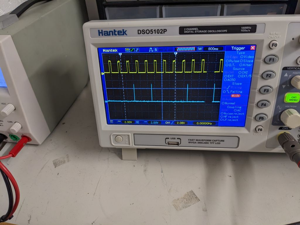

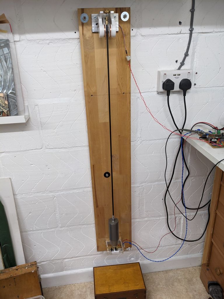

                                                John Haine
                                                  @johnhaine32865
                                                  Back on the wall. Actually much quicker than I expected. It does seem to be happier with a more solid mount, one can see from this.pxl_20230127_170445882.jpg
                                                  Top trace is the pendulum sensor, which is also the drive pulses if enabled.  Bottom trace the amplitude sensor, each blue pulse is where it just catches the amplitude peak.  When that happens the following two drive pulses are disabled.  In this trace you can see that the 4th and 5th pulse are disabled, also the 6th and 7th, then there are two where there will be drive pulses (then it's actually the previous trace…).  So more or less the control system is doing hit/miss alternately.  This is doing significantly better than when screwed to the bench as I hoped.  Now to rebuild my time measuring system…
                                                  Also I can now walk round the workshop without having to carefully avoid the thing.
