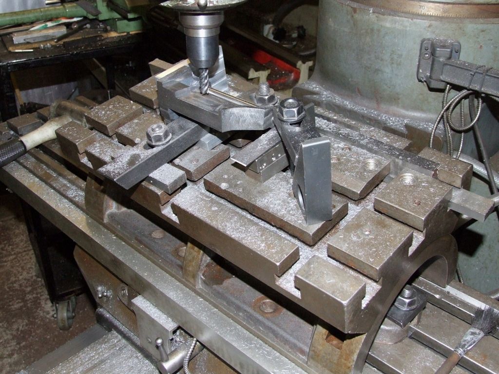

          Anonymous
            When I was looking for an angle plate I only considered the second pattern. All round much more rigid, and easier to adjust. Can't help with precise size requrements, as mine was bought secondhand. It's knocked about a lot, and is a tad on the large side for the Bridgeport (10" x 18" ), but nothing is going to shift it while machining:

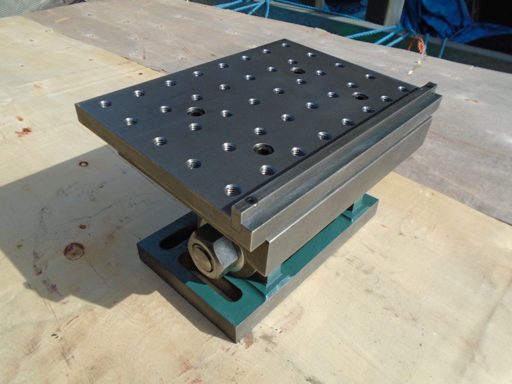

                  Fabio, whatever angle plate you buy, consider fitting a fixture plate with threaded holes like this, It makes it far more usable,

                    Thanks again to everybody, the toe clamps idea is something I had not considered even if somehing I use quite often and would solve several problems. I could also use the same tool on different mills
                    and I also like very much your fixture plate Richardyes.

                      here's some more views, I've found this fixture plate far more useful than the slots, which never seem to match up with anything you need to clamp to it.
