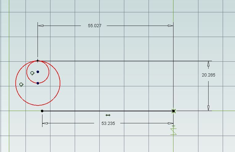

      Could someone point me in right direction please. Milling an internal triangle shape with 9mm corner rads with the Seig KX3 the cutter did not go round rad but returned along the path it came, when trying to cut rad the usual up & down sound of the motors was different mainly just one level sound, stopped m/c & returned axis to zero & Y axis was out by about 3mm the axis were all running OK manually but Y axis sounded a bit rough. the Mach 3 simulation showed correct path. Is there a minimum rad size these m/c's can handle it was 4mm dia cutter.

                DOC 0.2mm to check shape then 2.0mm, L61 Al, Brand new centre cut Carbide Garryson 4.0mm endmill, dry cut
                Andrew & Barrie
                N010 G0 G21 G49 G40 G17 G80 G50 G90
                N020 M6 T3
                N030 G64
                N040 M03 S3000
                N050 G00 G43 H3 Z30.0
                N130 G00 X-28.84 Y14.74
                N140 G42 G00 X-28.84 Y11.74
                N150 Z2.0
                N160 G01 Z-0.2 F10.0
                N170 G01 X-53.2347
                N180 G02 X-55.2074 Y20.2845 R4.5
                N190 G01 X-30.8127 Y32.1831
                N200 G02 X-24.34 Y28.1386 R4.5
                N210 G01 Y16.24
                N220 G02 X-28.84 Y11.74 R4.5
                N225 G01 X-29.5 Y10.5
                N230 G00 Z3.0
                N240 G40
                N250 G00 Z30.0
                N260 G00 X0 Y0
                N270 G00 G53 G0Z0
                N280 G49
                N290 M5
                N300 M30

                        First thing that looks wrong to my very little G-code knowledge is that a cut of R4.5 won't give the 9.0mm radius corners mentioned in the first post. If R is the ctr line of the cutter then 7.5 would be needed.
                        Also looking at the first two lines where the table moves
                        N170 G01 X-53.2347
                        First line starts from Zero and moves -53.2347mm in X
                        Next like has a 4.5mm radius cut ending -55.2347 in X and 20.2845 in Y but that is further than the diameter of the circle away from where the previous cut stopped?

                            Jason it looks like Raymond is using cutter comp in which case you programme the profile as seen on the drawing not the cutter path
                            the control will work out the tool path a drawing of what he wants would help

                              Posted by geoff adams on 14/02/2019 08:04:59:
                              In which case should he have entered R9 if that is the radius he mentions in his first post? and even then how can the end of the arc cut be over 20mm away from where the first straight cut ended I would have expected 18mm at the most.

                                    must apologise for error it was a long day yesterday, the part is a steady for 3 x 9.0mm dia rods so corner rads are 4.5mm it is a internal right angle shaped pocket, the prog uses cutter comp G42 cutter offset right conventional mill.The cutter was originally 6mm dia hence allowance of 3mm to start comp in Y axis lines N130 & N140 tried 4mm cutter to see if giving m/c more room to move round rad would help. Line N225 above is wrong Y should be 12.5 it is 5 years since I have done a prog and had forgotten that prog can't finish with an arc so entered line manually was changed before running it. Unfortunately there is no drawing I was given X & Y projected dimensions of a right angled triangle and told to blend corners with 4.5mm rads over the phone I think sizes measured with CMM m/c. The missing lines N050-N130 are for tool no.2 a 10mm slot drill plunge cutting out surplus

                                      I imported the code into my backplotter program (NcPlot) and it generated the expected toolpath shape and stepping thorugh the code the tool stepped round exactly as I'd expect. So it may be an interpretation problme in Mach3.
                                      Having said that there are some odd features of the code. Presumably it was hand written? I've never felt the need to use cutter compensation, I just let the CAM software sort that out given a stock allowance and a tolerance.

                                            Just tried again & Y axis ballscrew just turned a few degrees & motor sounded like it was struggling while cutting rad it stopped as it started up the angle face although the readout showed movement of both axis the cutter returned along path of 1st cut, stopped it after about 10mm homed m/c & Y axis moved normally manually
                                            Andrew Home posn is intersection of X & Y sides of component
