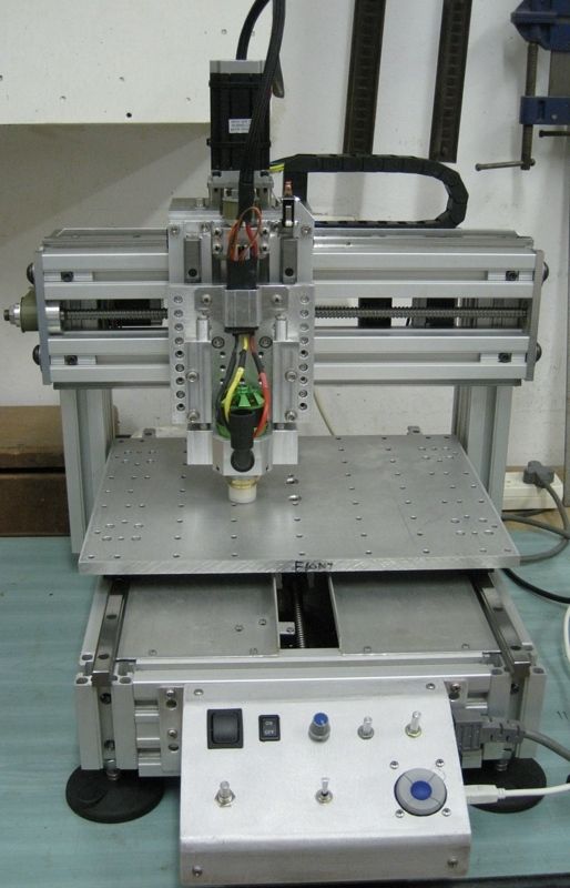

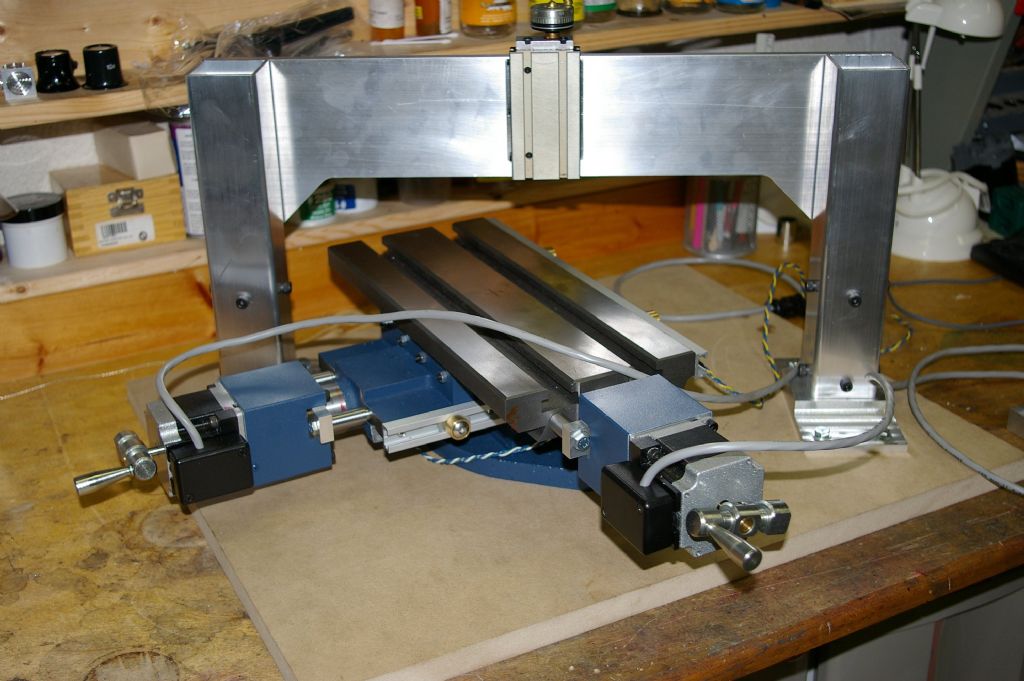

                Anonymous
                  Something like this:

                        My 'engraver' – very sturdy – table is a bit bigger than A4 size. Table moves in Y. Machine weighs around 36kg.
                        Mini-Router/Engraver
                        Peter – this looks interesting – the gantru appears bolted down so I assume this is the operating construction – interesting kinmatics here with a linear angle transform. All perpendicular cuts require angular transforms…

                        #577063
                          I have always considered gantry type machines best suited to larger XY and smaller Z movement. Now that you have given an idea of what you want to machine and sizes I would view your machine more as a vertical mill or VMC with an additional support to the column in which case have XY movement on the table and Z only on the head/gantry.
                          You have not said what sort of spindle you are thinking of using? integral ER collet or something that will allow tool changing like the ATC spindles with their small BT20 taper. This will affect your Z clearance which at 150mm (to table? ) sounds quite small to me.
                          Will you be wanting to reach to the bottom of that 100mm cube or cylinder with the same tool that was working on the top edge? in which case you straight away need 200mm clearance. Then any tool holding like a drill chuck will add close to 100mm and what about holding the work? you need to allow vice height or a 100mm dia billet that is best held in a chuck mounted jaws up
                          I'd go for an epoxy concrete bed with inserts to fix your rails to and also insert sat the side to take the gantry supports. maybe even fill your gantry and it's supports with the stuff as it all helps damp vibration.
                          I don't think Peter's design would need any angular to linear adjustments as table just moves in XY and head being only Z can me supported in anyway so makes no difference. Could save some room though.

                                #577176
                                Anonymous
                                  Posted by JasonB on 28/12/2021 07:14:55:
                                  Exactly. I just threw this in as one example.
                                  It's a construction I came up with some years ago (I just checked – the CAD files are dated 2014) as a device for learning about basic CNC. The z-axis is manual at this stage but the intention was to fit a stepper to that axis too as time went on and I learned more. There are lots of ways you could go … this suited me at the time. The XY table was a commercial device to which I fitted ballscrews. I also constructed a bunch of driver electronics in a cabinet.
                                  Unfortunately "things" happened resulting in me never getting back to it – nor indeed getting back to serious workshop activity at all.
