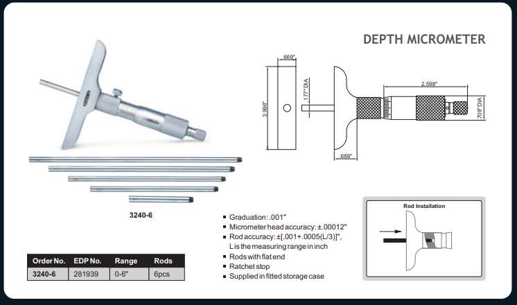

              It looks to me the same style  as the Insize one here on Page 21; seems to just push in and lock on the taper.

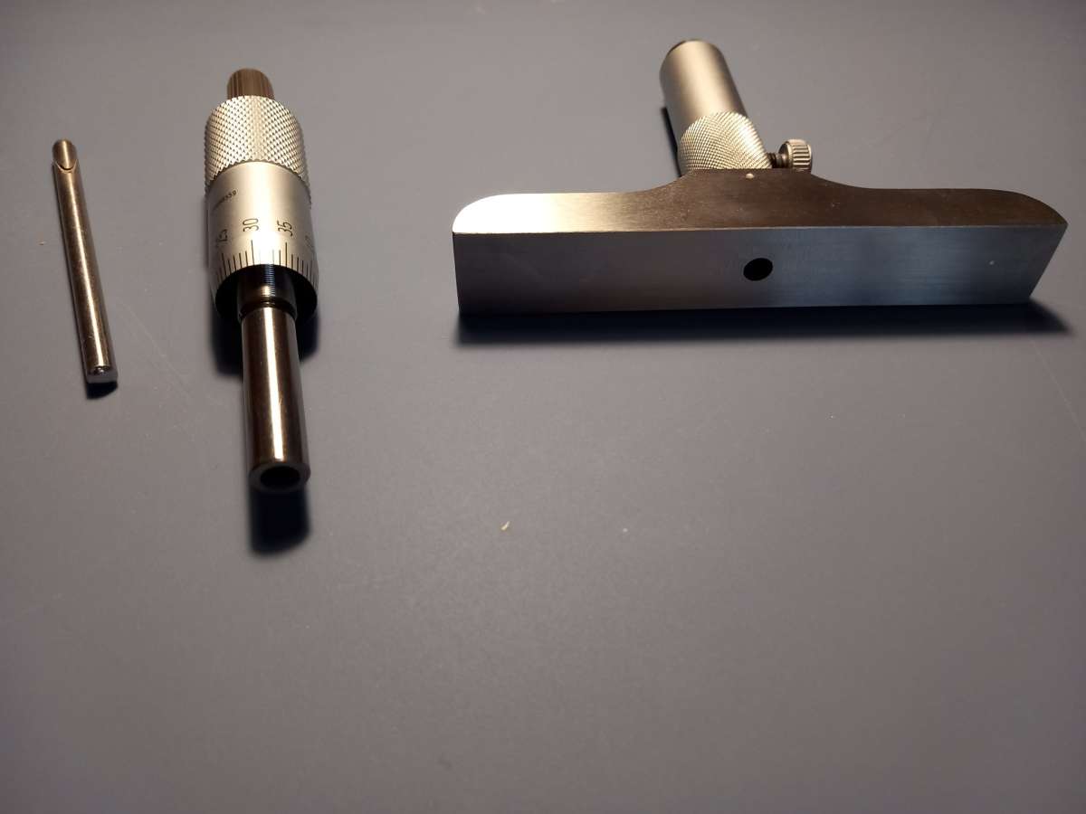

                Here are two photosMicro 1

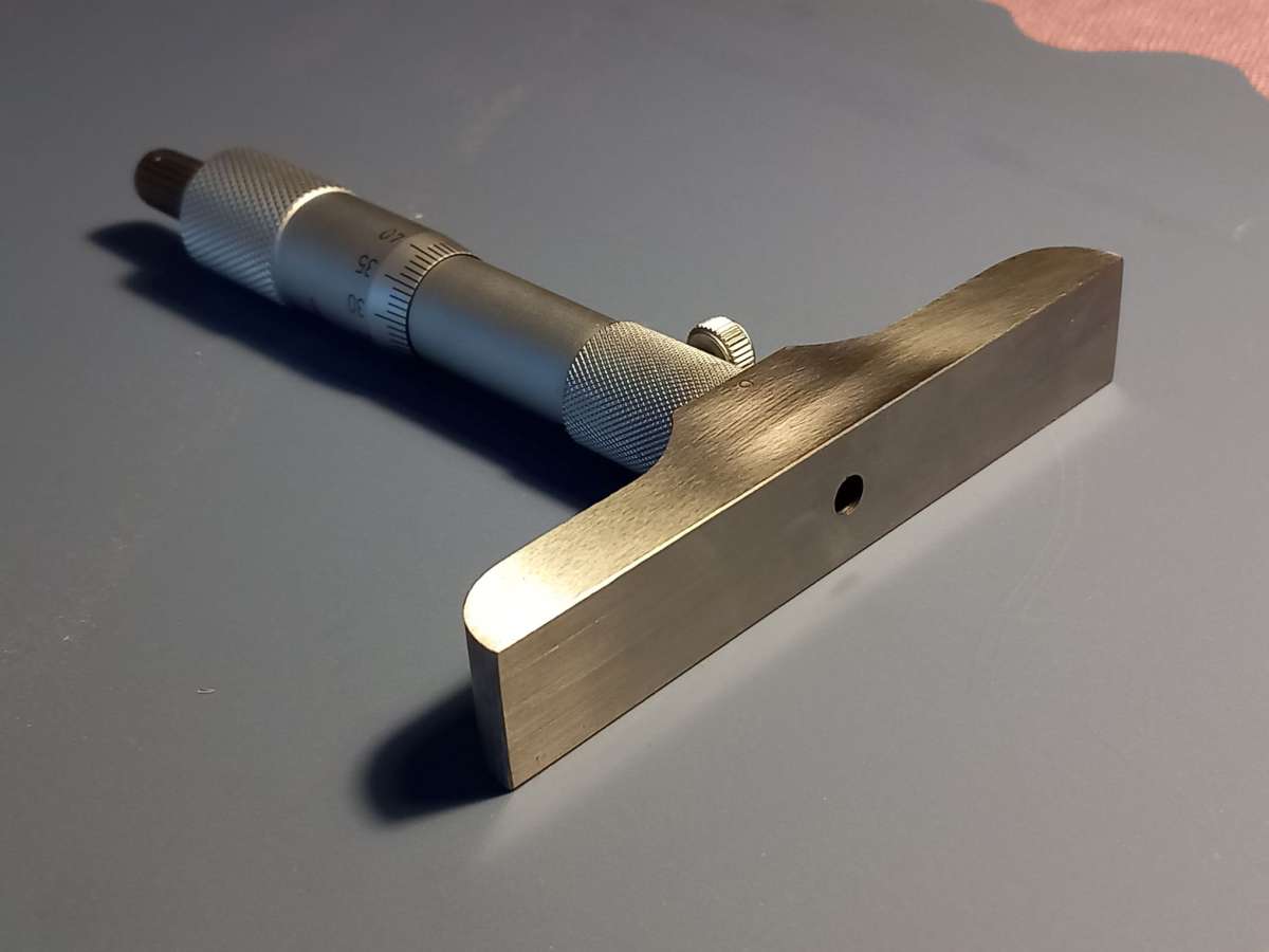

                #693830
                Martyn Nutland 1
                  @martynnutland1
                  Photo 2Micro 2

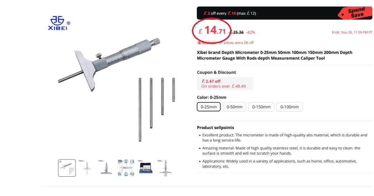

                    Ok. I think I may have identified where the issue is with it.
                    Mic
                    #693873
                    Martyn Nutland 1
                      @martynnutland1
                      I take your point.  I paid more than that…

                          This may be of help to other folk  who might be tempted to buy an Xibei depth micrometer.
                          I was a little bit put off by Robin Dufton’s ‘smart arse’ reply that my problem was caused by buying a ‘cheap’ product. The Xibei was certainly not – or not in may wallet, perhaps his. Not all of us have the resources to ‘fork out’ on a Starrett or ‘Mit’.
                          The answer, in the case of the Xibei, is that the rods are held in the body of the instrument by friction. The nasty little snag at the top of the rod increases the latter to hold the rod in place. Not as elegant as a Starrett etcetera but it works.
                          When I ‘sussed’ this methodology the Xibei works perfectly. It is nicely made and presented. The satin finish is excellent and the graduations perfect. Calibration is a pain because of the stiffness, but this may improve with use.
