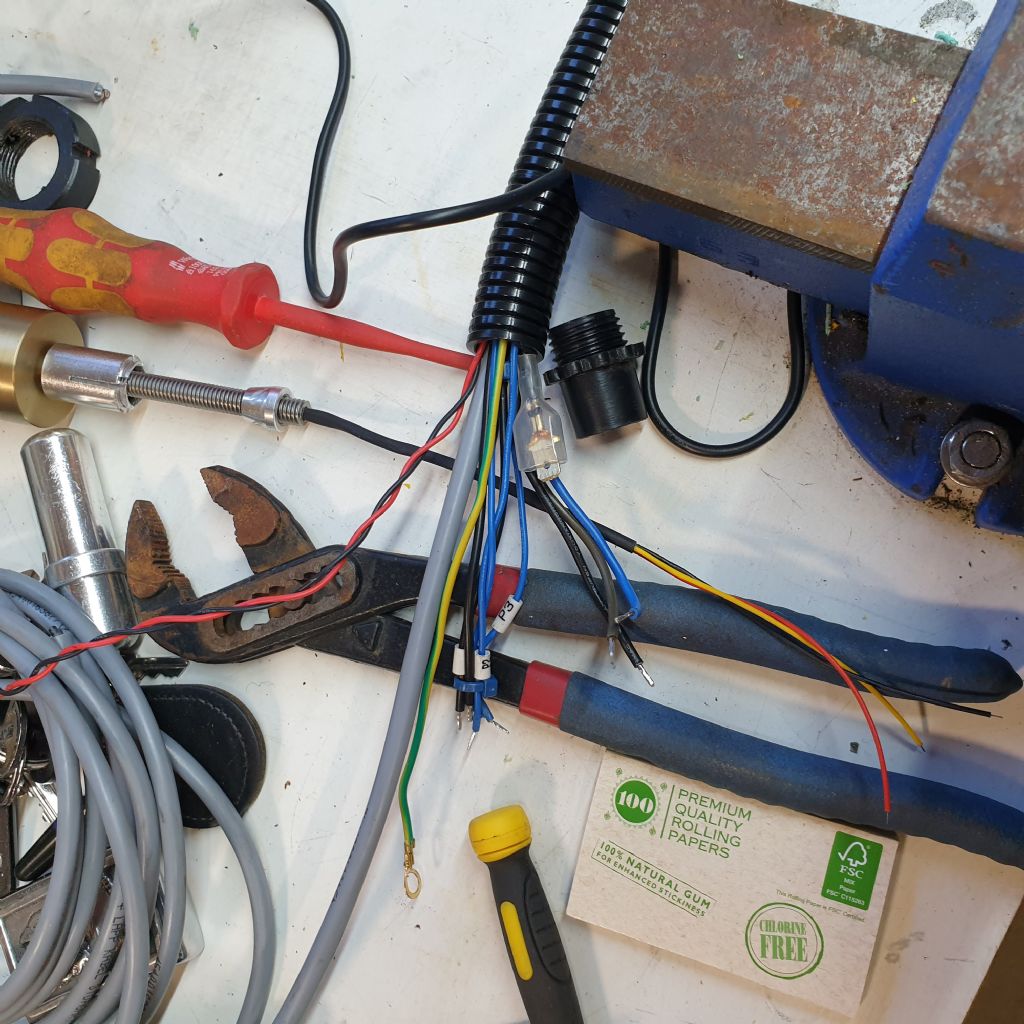

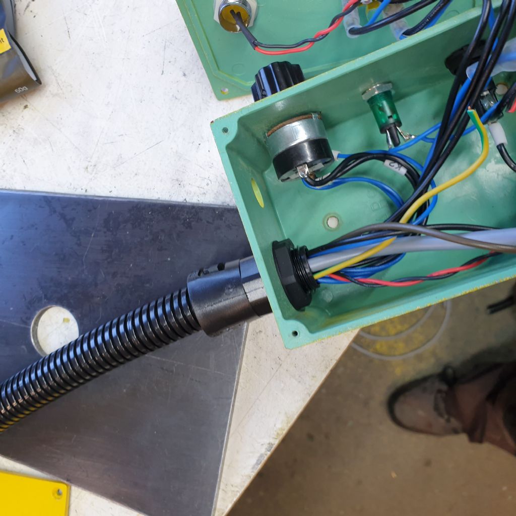

                  #580805
                  Robert Munce
                    @robertmunce32684
                    Just in the process of adding extra electronics and cabling
                    Removed 16mm conduit changed to 20mm conduit to give me 12v and 24v in the switch unit.
                    #580807
                    Robert Munce
                      @robertmunce32684
