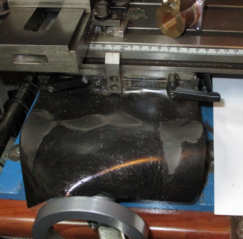

      Hi
      Has anyone made any way covers for their mill as the ones what come with it are a bit naff
      Would love to see your ideas please pictures would help me loads
      Thanks in advance

          Hi Robert,
          My milling machine didn't come with any waycover for the front so I simply used a rubber sheet that I attached with some screws:
          You can buy covers/machine bellows.
          Thor

                #585173
                Peter G. Shaw
                  @peterg-shaw75338
                  My X2 clone, actually a Warco MiniMill came with corrugated plastic covers for the Y axis. (Is that right? I'm referring to the forward & backwards slide as distinct from the side to side slide.) These quite quickly cracked and split in the folds of the corrugations. I then replaced them with other corrugated plastic stuff supposedly meant for this job but which also quickly cracked and split. In the end, I used an idea by, I think, Harold Hall and that was to use polyurethane varnished cardboard from breakfast cereal packs, lightly scored where I wanted folds. These are lasting much longer than the plastic stuff. The downside is that they are stiff and get in the way when up against the travel limits, mainly up against the column. Hence, as I approach the column, I use a slim rod, screwdriver, whatever just to lift the cardboard such that it then bunches up above the slide.

                  John Hinkley
                    @johnhinkley26699
                    I replaced the supplied sheet "rubber" Y-axis way protector on my Warco VMC mill in pretty short order and substituted **LINK** . They are well into their sixth year of use and show no sign of wear or tear. Like Peter, I lift them out of harms way when the table is traversed to its maximum extent towards the column. Highly recommended. No connections, etc.
