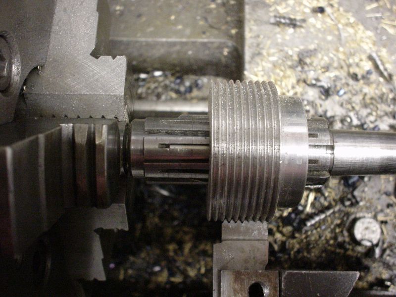

      A plunge cut works just as well on a steel pully. Ian S C
      #100101
      Sub Mandrel
        @submandrel
        Hi Pekka,
        I ground a v-tool a bit sharper to match 40 degrees on my angle gauge.
        Procedure is simple – set index wheel to 0 just as tool contacts the work. Plunge in 2.5mm.
        Wind out, advance to slide across 2.34mm and repeat.
        I made the key seats in the pulleys by filing.
        #100103
        John Stevenson 1
          @johnstevenson1
          For the J section poly vee pullies an 11 tpi thread chasher is a bang on fit.
          I know the purists will say the angle isn't correct but been making these for ages like this.
          Some pulleys run 8 hour days, 6 days a week at 9,000 rpm.

              Thank you,
              MichaelG. & All. Thank you very much.
              I actually have a thread mill insert, and I was eyeballing it, but it's not right pitch, nor correct angle…..
              PekkaNF

                          Here's a cutter insert for the PolyVee enthusiasts
                          I wonder if they are available in the UK. ???
                          #100738
                          Clive Hartland
                            @clivehartland94829
                            At a minimum order of 100 I doubt it Michael, there are not many people cutting 'V' belt pulleys at the moment and they are all on here !
                            There are some highly specialised tool bits from that firm and mainly for high production rate machines.
                            If an 11Tpi chaser does the job then OK. thats what I will use if I need to cut a pulley. I know I have one.
