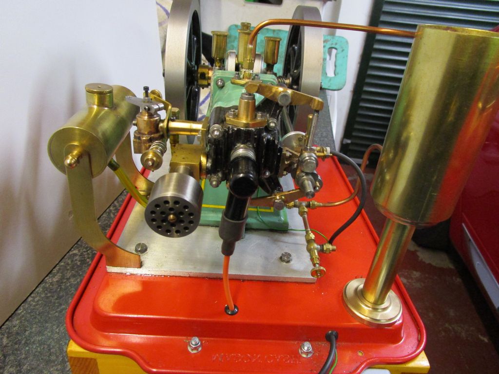

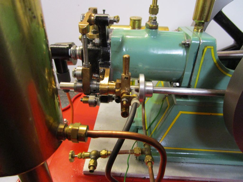

          WyvernWyvern
          Jim. You can do your own thing with the exhaust on the Wyvern, my version shown in the picture, I used a Hall sensor for my ignition by Minimag Link , however you can use points and coil ignition.
          I run my Wyvern on petrol, you can use propane but I am not up on that method but it would be worth looking into.
          Hope this helps.
          MichaelR.

                Michael R – Thanks for some great photos of you engine, it’s given me some ideas for exhaust and cooling methods. Presumably you exhaust is a steel tube with holes in the blanked off end. Is it willed with some sound deadening material? The ignition system is interesting and so I will have a look at the Minimag and if ok get back to you for some fitting advise ?

                      MichaelR
                        @michaelr
                        Jim. My exhaust has no sound deadening just the expansion box, sounds not to bad noise wise.
                        MichaelR

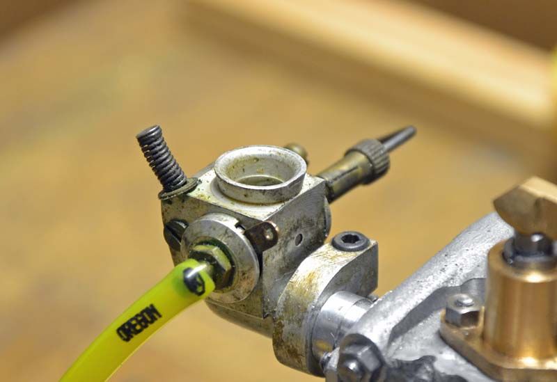

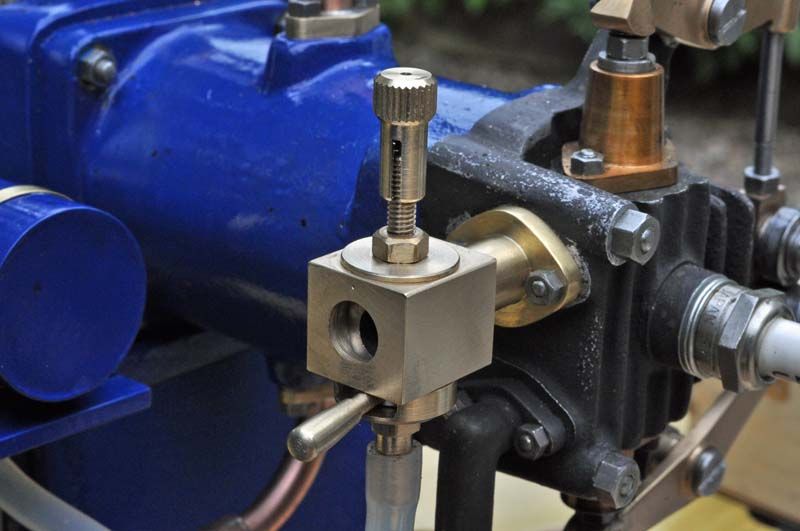

                            JIm,
                            I couldn't get the ETW carb to work on mine. I had great results using the carb I made for the Matador 10cc glow engine. Very flexible running.
                            I tried to replicate this with a brass copy with the same internal dimensions as the Matador carb.
                            This runs ok but not as well as the Matador carb. I didn't put an air bleed on the brass version and I think it runs too rich at lower revs – something I intend to put right but I have now developed a leak on the inlet valve so some major work is required.
