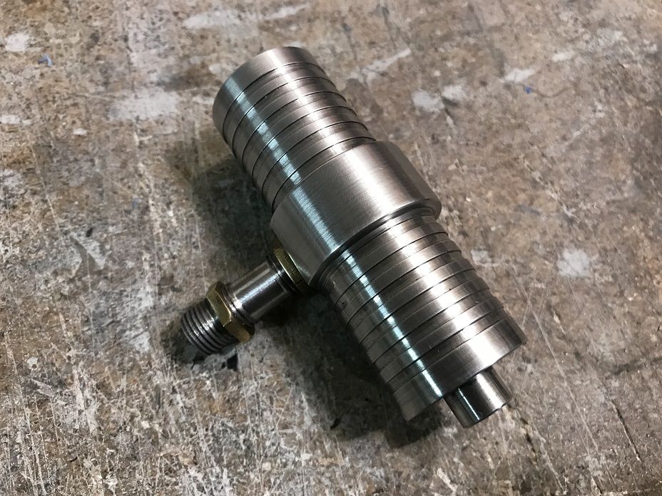

        Third item, tried to aluminium weld the silencer pipe. Made a mess on the thin wall so have redesigned it with a threaded connection.

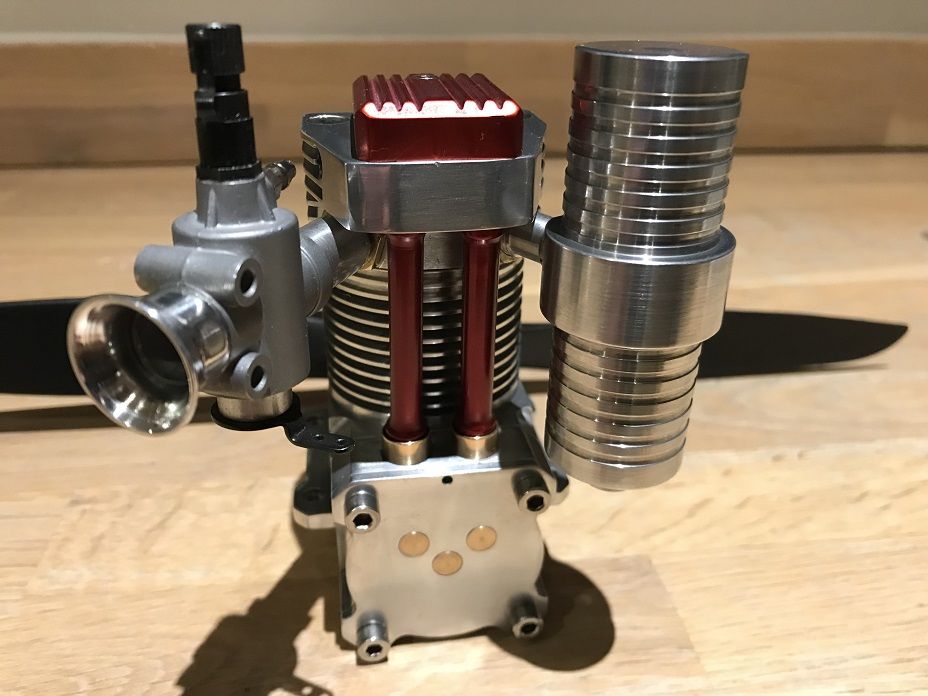

          Final role call before assembly…

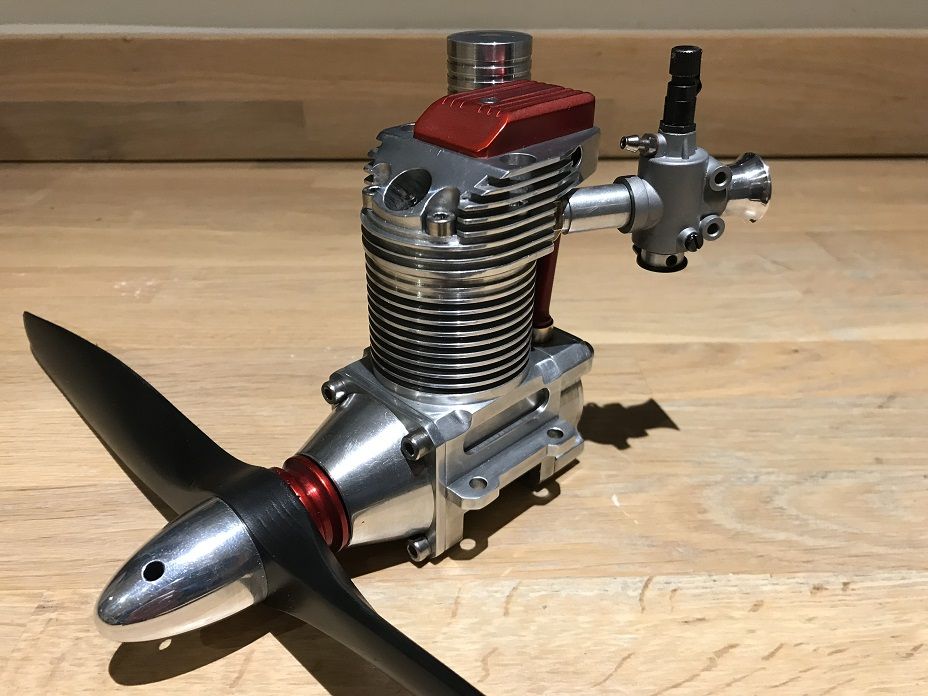

                  It's alive!!!! It works smiley
                  Very very happy after the first runs today. Started super easy, idles well, and has good throttle response.
                  Only put 1.5 tanks through it and didn't want to pusjh it hard, so looking forward to getting it run and tuned in.
                  I don't have a tacho so not sure what the RPMs where but certainly souned like a good range.

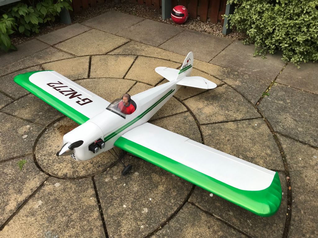

                  And heres the plane shes going in. Can't wait to get it finished now. smiley

                        So I put 2 tanks of fuel through the engine over the weekend and borrowed a tacho. As I said, the idle is great, down at 1500rpm and smooth, but am a bit disappointed in only revving to around 3500rpm which I thought was a bit low.

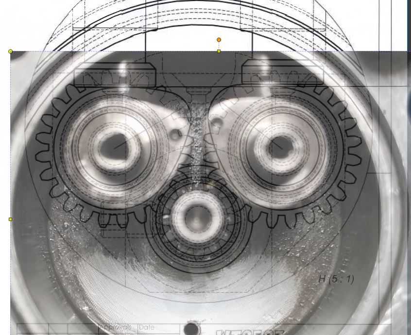

                        I've stripped her down to inspect everything and check for anything rubbing, wearing, or loose. Everything seems ok, but I did discover that the timing gears were one tooth out, i.e. 15 degrees retarded from where it should be. What I'm hoping is that advancing will give it more power/higher rev's but not sure. Looking forward to trying it again to see the difference.

                              Small update. Ran the engine again with the timing gears in correct location. Definitely an improvement at the top end rpm, up to around 5500rpm.
                              Interestingly the bottom end is now not so smooth as it was before, but not too bad.
                              My next plan to improve the rpm is to try making another set of valve springs that are a bit stiffer as I suspect the bounce back on the valves could be limiting.

                                            thanks guys. The engine is now running solidly up to 8000rpm on a 14×8 prop and has had another 6 or so tanks of fuel through it. Reckon she is ready to spread her wings this weekend weather permitting.
                                            A double maiden of the plane and the engine.

                                                  Just to wrap this thread up, below is a link to successful maiden of the Spacewalker with the WT2527 engine. Just gave it a short flight and landed (sucessfully) so I could check everything. Happy with results. Hope to get her out again soon.
