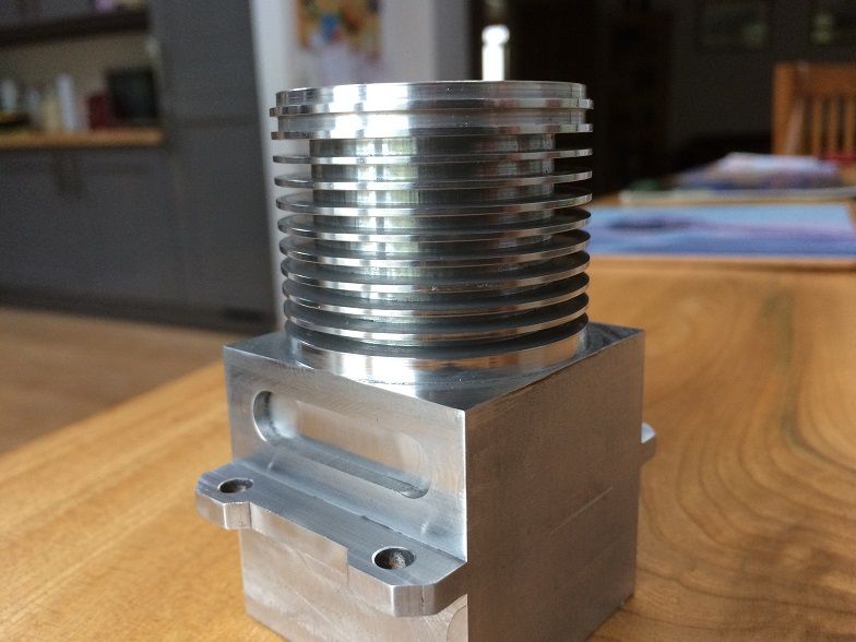

  • #353303
    Craig Booth 1
      @craigbooth1

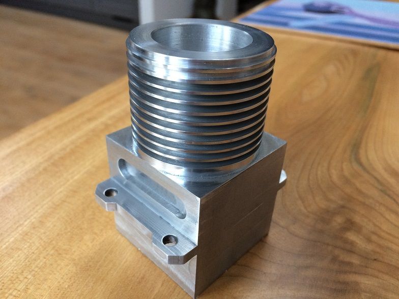

      a bit more progress today. Turned the cylinder, cut the fins (1mm fins/2mm spaces), and bored out ready for liner.
      #353306
      LADmachining
        @ladmachining
        Nice work – looks like you are making good progress! smiley
        #353312
        Trevor Crossman 1
          @trevorcrossman1
          Good progress Craig​ ,neat finning , what do you plan to put it in for its first flight? Trevor

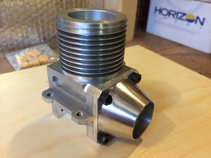

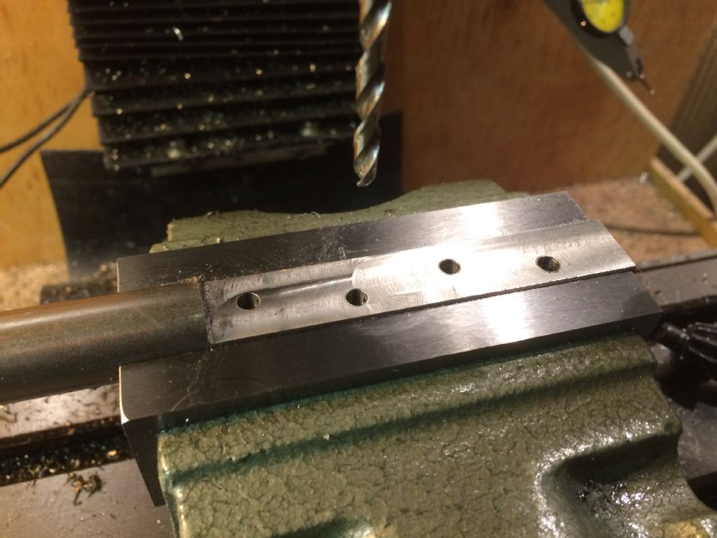

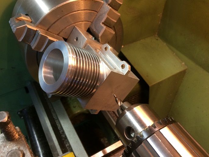

            #354795
            Craig Booth 1
              @craigbooth1

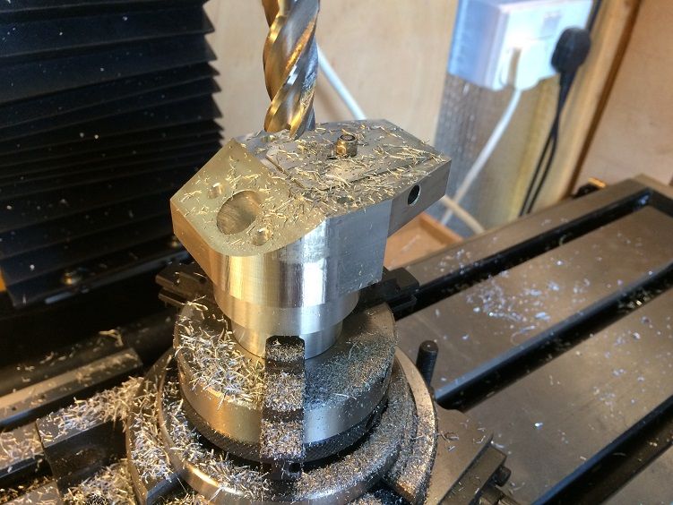

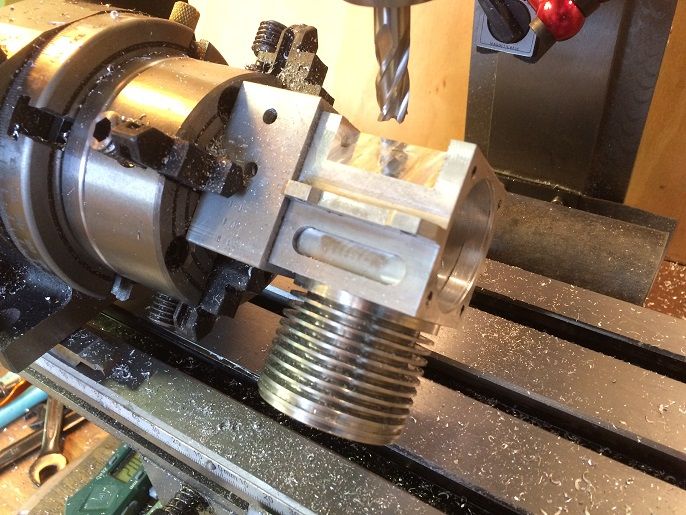

              Had a few sneaky days off while I built a kit set radio control car for the kids (well me actuallywink).

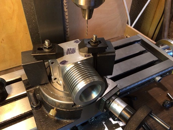

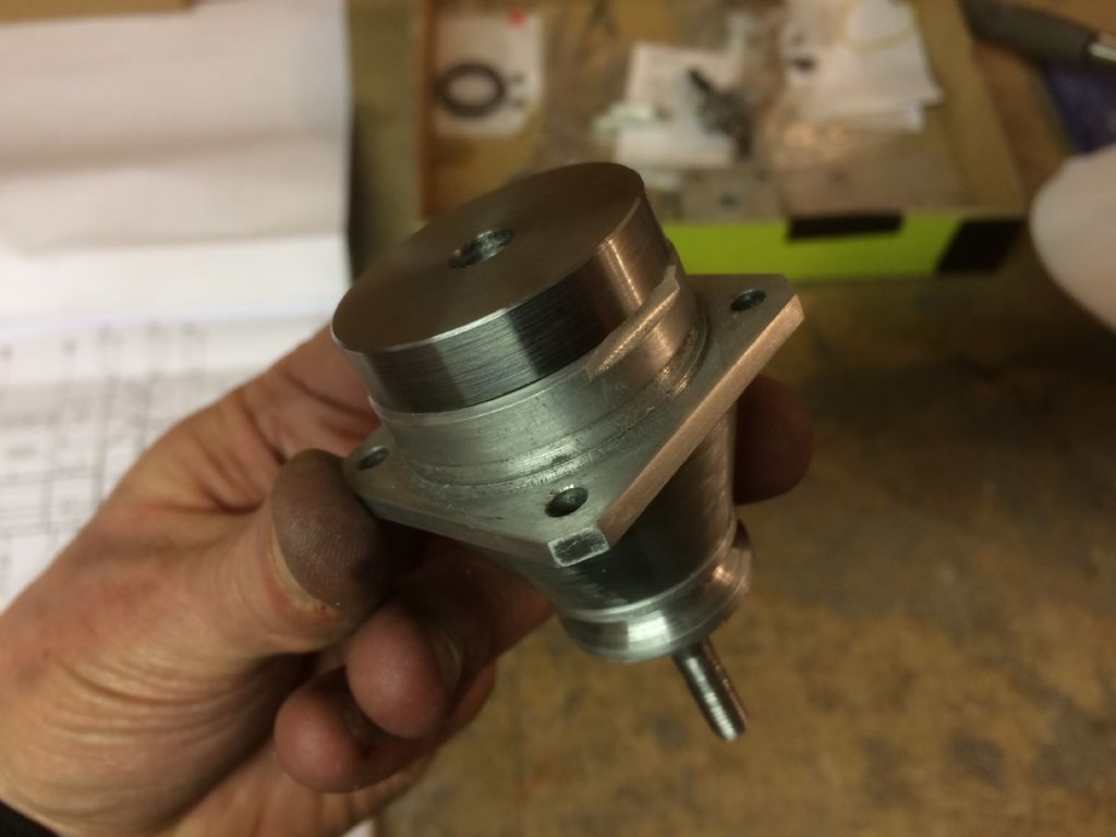

              Next on the engine was onto the rotary table to mark and drill out and tap the four 4 mm fixing holes front and rear.(I did use a centre drill first).

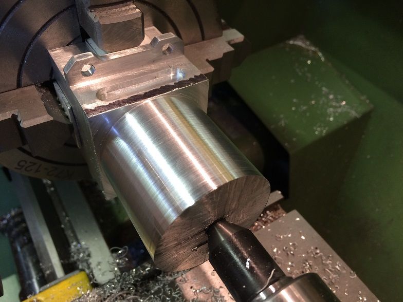

              Using a piece of scrap I made a holding jig so that I could put it back in the lathe to bore the tangential hole.
              Then back onto the rotary table to trim a few corners. I think what I'm finding now is that I'd wish I spent a little more on the next size up mill. Mine is a WM14 with 280mm spindle to table distance. Even with the smallest rotary table I could find I do struggle for space with some of the setups.
              Crankcase pretty much finished with exception of trimming the rear corners once I make the rear crank housing.
              #354808
              Hopper
                @hopper
                Very nice work. Amazing what you find hiding inside blocks of metal isn't it.

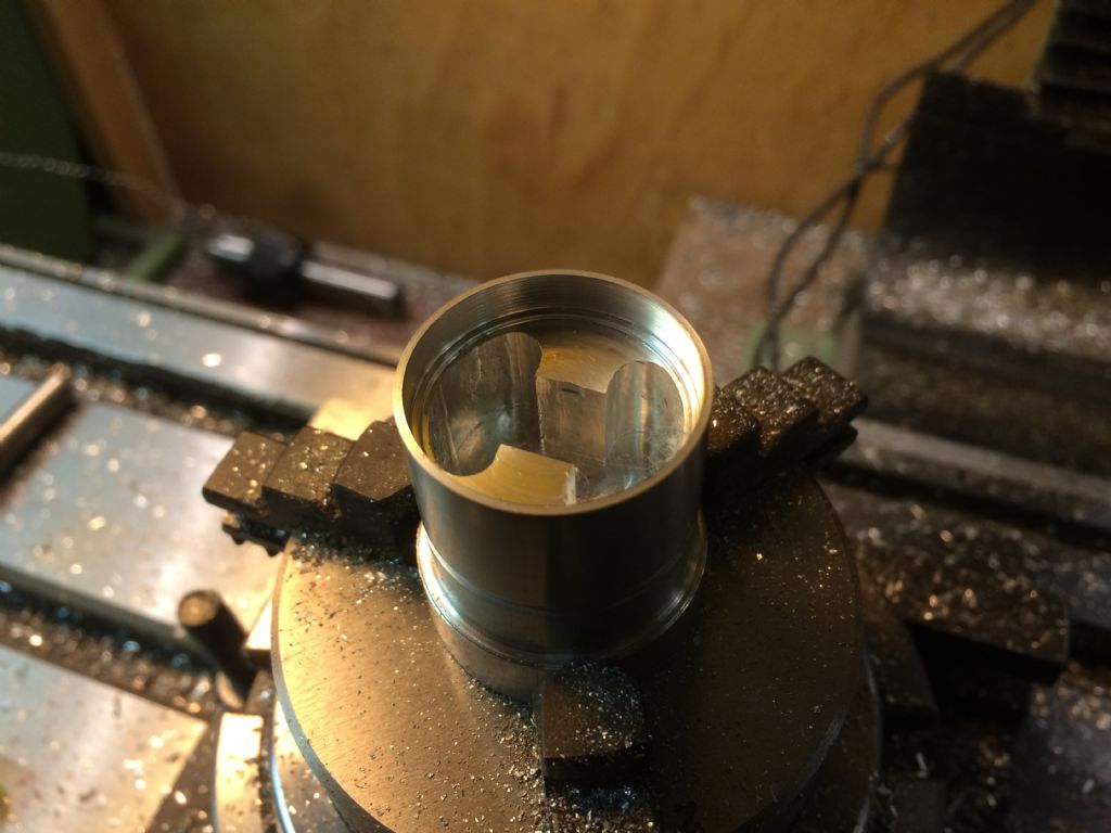

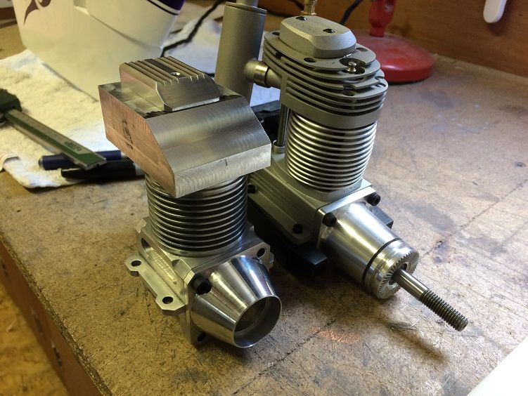

                    Made the cylinder liner. Had some problems with boring the cylinder and getting a nice finish which I suspect was down to my lack of experience but possibly also the EN16M material which I understand is slightly less machinable than EN8. Perhaps I could have just used EN8 for the liner?
                    Anyway seem to corrected the problem with a lap and now all seems ok.
                    I also have EN16 for the crank, but if it is going to be that hard to machine then may look to change. Any opinions? Would EN8 suffice?

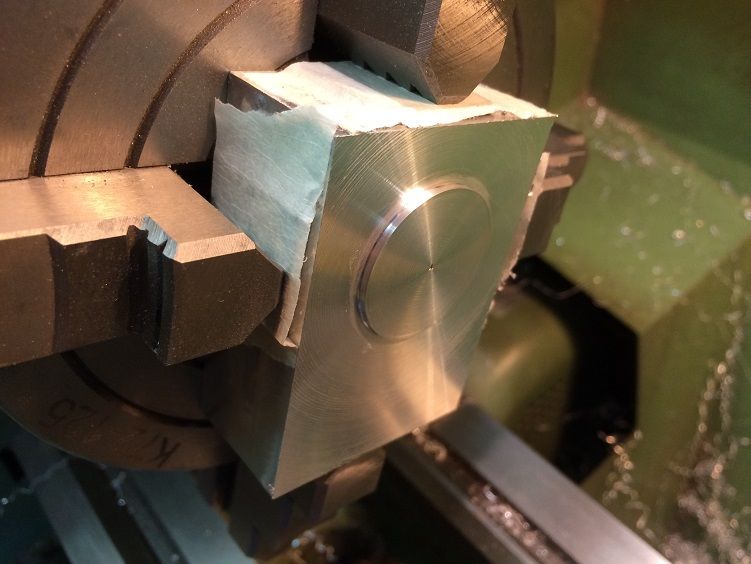

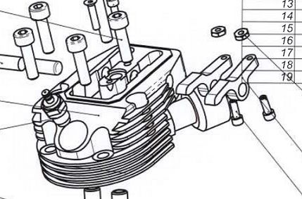

                    Also started making the blank for the cylinder head. That is going to be the hardest part for me to date. Plans look pretty complicated with plenty of angles and different steps. Trying to break it down into the right sequence.
                    I have made the block and cut the part that sit in the top of the cylinder liner. I have then made a mirror jig of that out of aluminium 40mm bar. This should locate the jig exactly centre. Next I will drill the head bolt pattern using the mill and use those to fix securely to the jig. All other steps can then be carried out using the jig to hold it.
                    I am relying on a new Mill I have on order to help me. I currently have the WM14 but have been struggling for vertical space once i get the rotary table on, so have decided to upgrade to the WM16 and have also ordered a DRO set. I am hoping this will give me some better accuracy on my mill work.
                    (PS if anyone wants a WM14, 7 months old, little use, let me know)

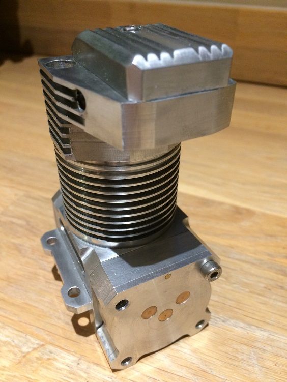

                    Here she is so far side by side with a Laser 100 which is currently destined for my Spitfire which is currently competing for my time.

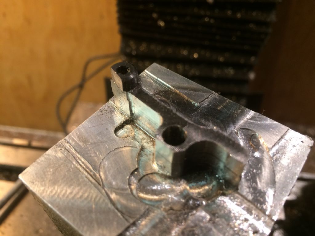

                    #370984
                    Craig Booth 1
                      @craigbooth1

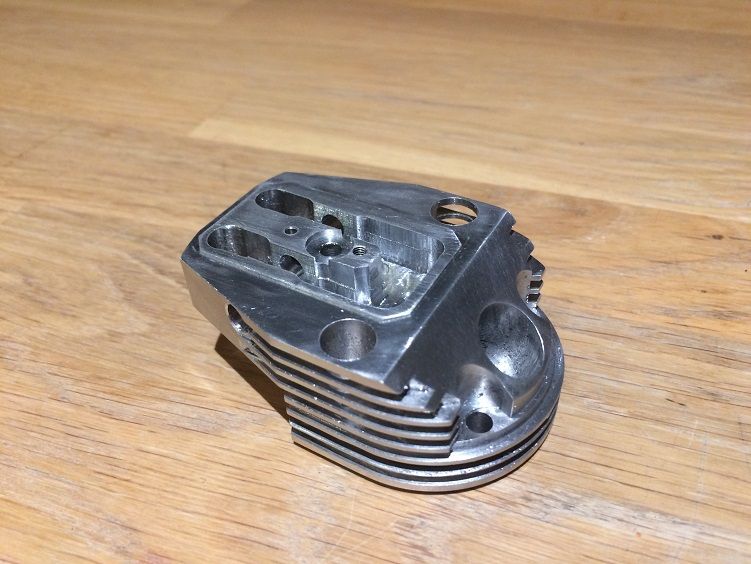

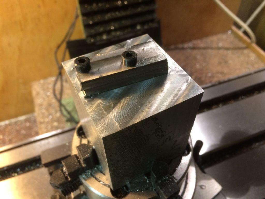

                      Had a new toy to play with today. A new WM16 mill with DRO. What a difference having a DRO makes.
                      Used it for the first time to to do some more work on the cylinder head.
                      Learnt two lessons today. One – spend more time reading the plans, two – use lubricant with a slitting saw.
                      You can see the mistake on the first fin at the bottom of the cylinder head. Was supposed to be a 1mm fin at bottom, not 2mm. And the second fin is less than 1mm due to the slitting saw ripping.
                      Fortunately these are only cosmetic, but a bit annoyed with myself.
                      Edited By Craig Booth 1 on 08/09/2018 21:15:54
                      #371127
                      Craig Booth 1
                        @craigbooth1
                        and today milled the cylinder head slots for the rockers.

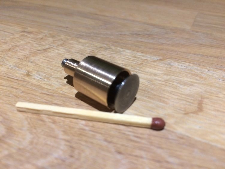

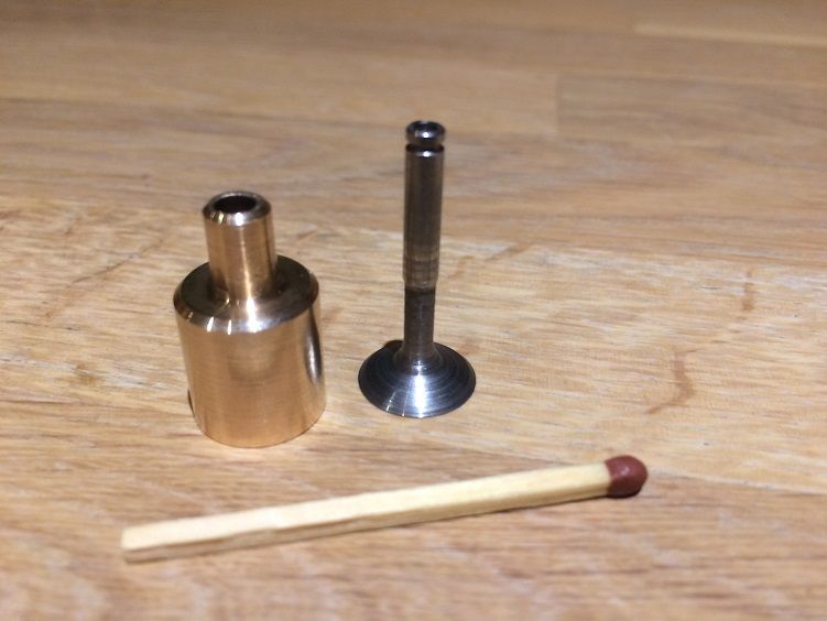

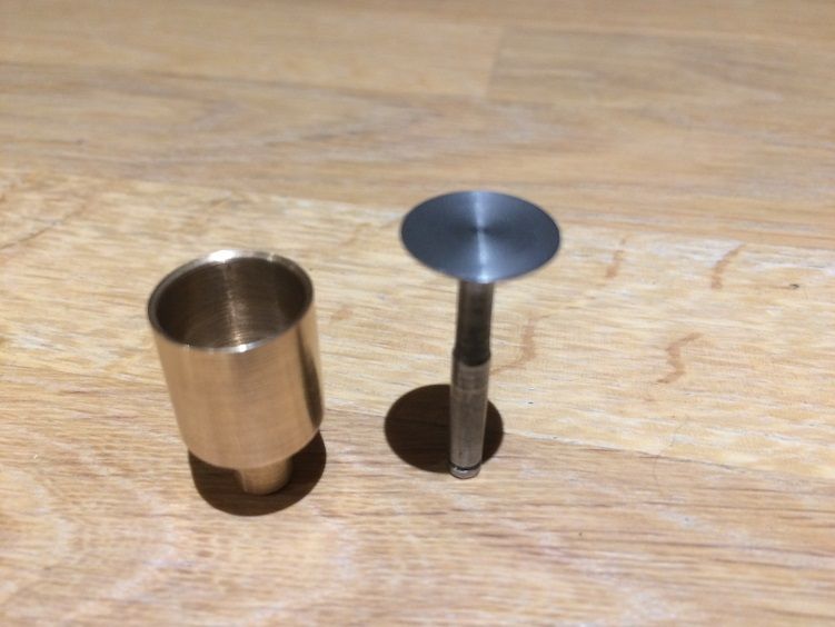

                                  Over the past couple of days I've been working on the exhaust valve (SS316) and valve liner (Colphos).
                                  The plans call for an OD on the valve liner of 13.5mm, and therefore obviously the same size hole to fit in the head. I looked at a 13.5mm end mill but to be honest was scared away by the cost for something I will probably never use again, so have reduced the OD to 13mm. Hopefully it does not make too much difference to the performance. If my maths is correct it is a 7% reduction in area. Might be able to make up for it a bit by some port and polishing.
                                  The valve liner will be an interference fit in the head.
                                  My other cheat was the valve shaft hole in the liner at 3.5mm. Again I do not have a 3.5mm reamer and looked at prices and decided just to drill. Although the valve feels smooth in the liner, I'm just not sure. Any slop here and the exhaust gases will pass. Of course I did not think of a hand reamer which are much cheaper. So I think this set I've made will be put down as learning curve and practice and I'll re-do it properly once I get a reamer.

                                  Hopper
                                    @hopper
                                    Wow. The match stick really sets things in perspective! Nice work.
                                    For future reference, cheap but quite reasonable quality reamers are readily available, like this one here
                                    **LINK**
                                    two for $8.95 including shipping.
                                    I have found them quite good enough for home hobby shop use.

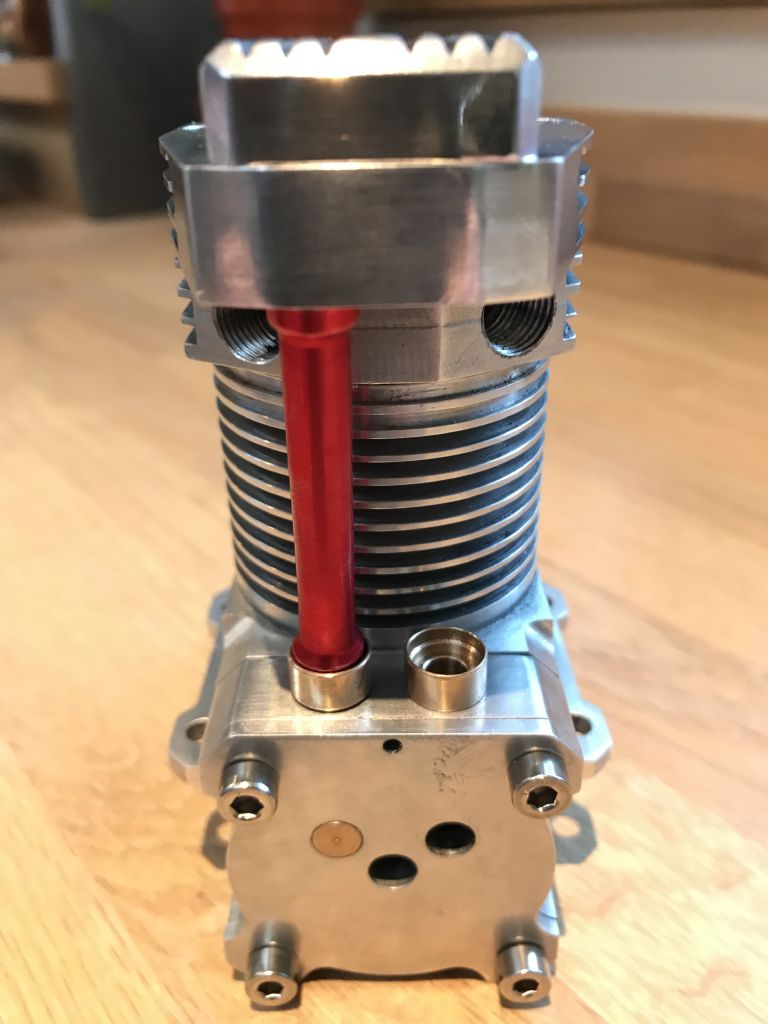

                                      Hi all, Merry Christmas to all. Well it's been a while as I've been working on the Spitfire which is almost finished, so I've managed to find some time to get back onto the engine. The next couple of posts give an update of the last weeks work.

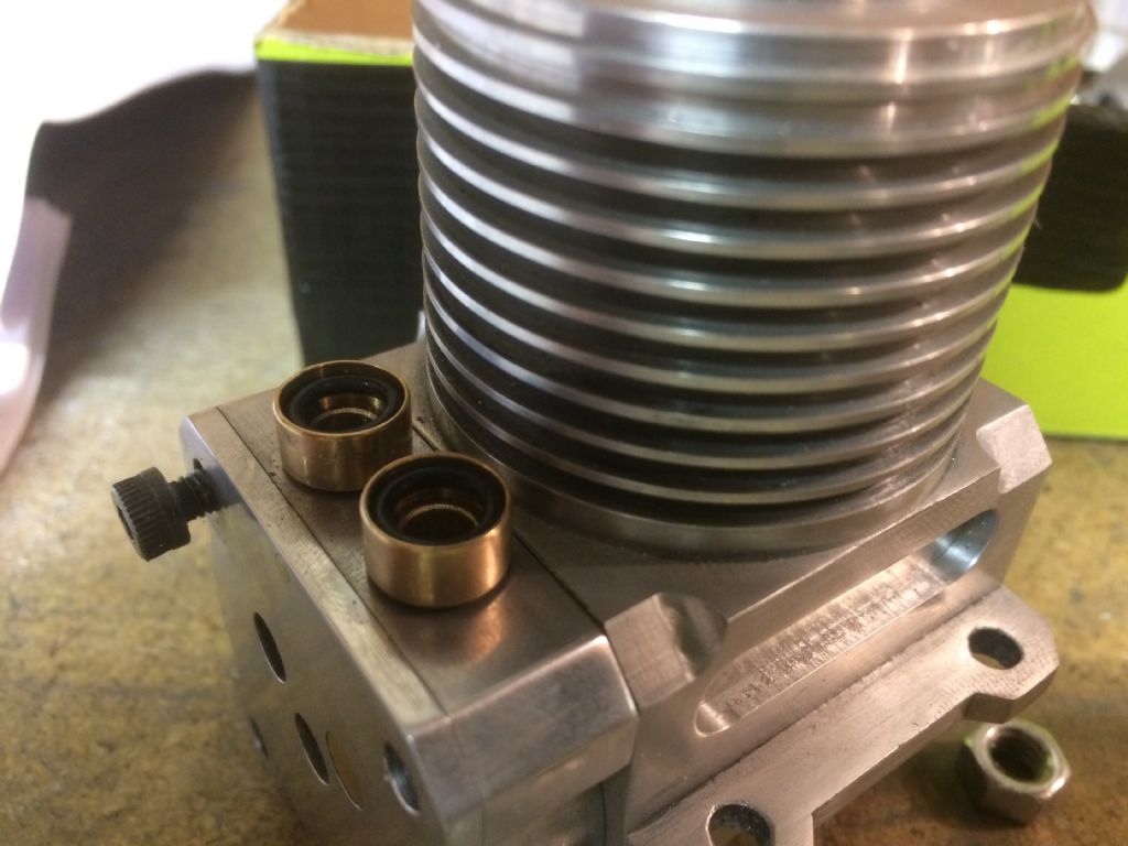

                                      Cam follower guides from Colphos made. You can see the o-rings in the photo below.

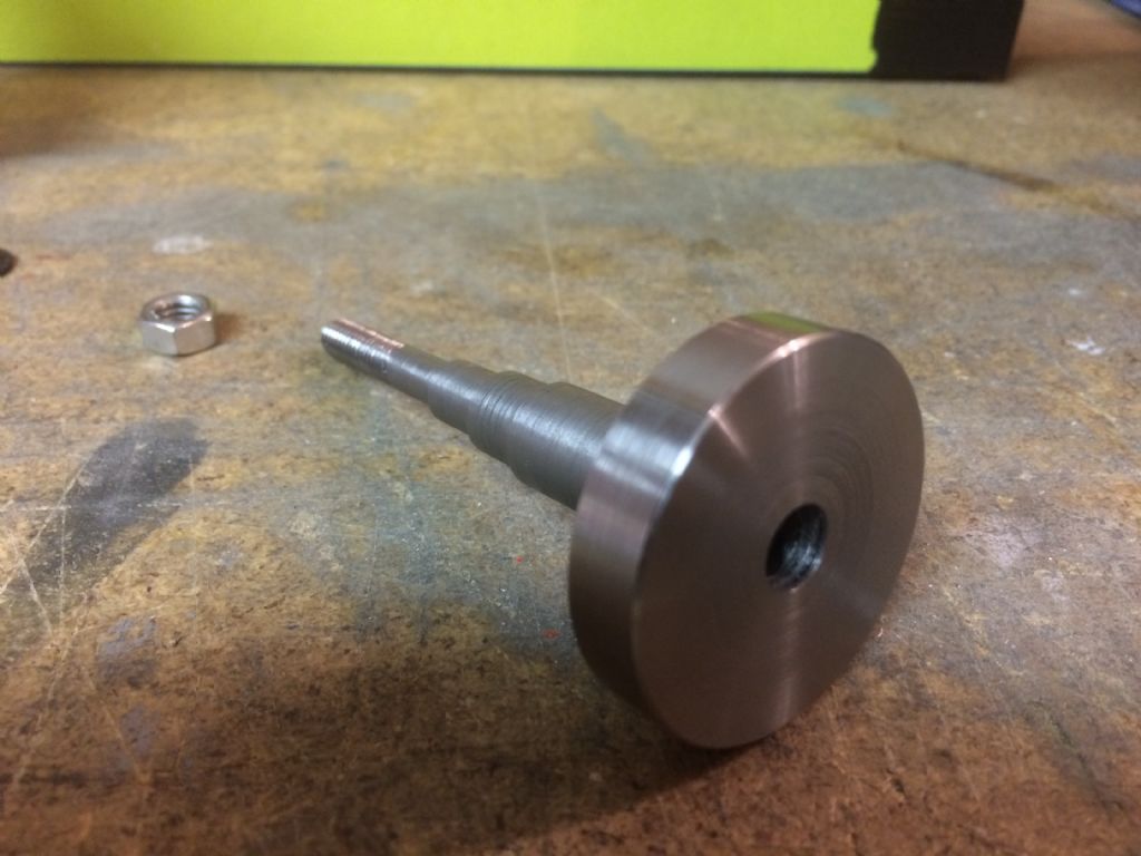

                                      #388165
                                      Craig Booth 1
                                        @craigbooth1

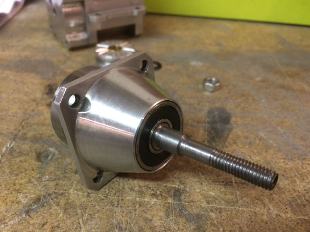

                                        I had a go at the crankshaft (EN16T) which started out well but I ended up taking a bit too much off the diameter for the big bearing. Only a margin but enough that I can feel a bit of slop in it.
                                        So once I get some more material I'll make another one. I'm also going to up the thread size from M6 to M8. That feels a bit better for an engine this size and will also fit the standard 8mm diameter on the props.
                                        Edited By Craig Booth 1 on 29/12/2018 20:57:03

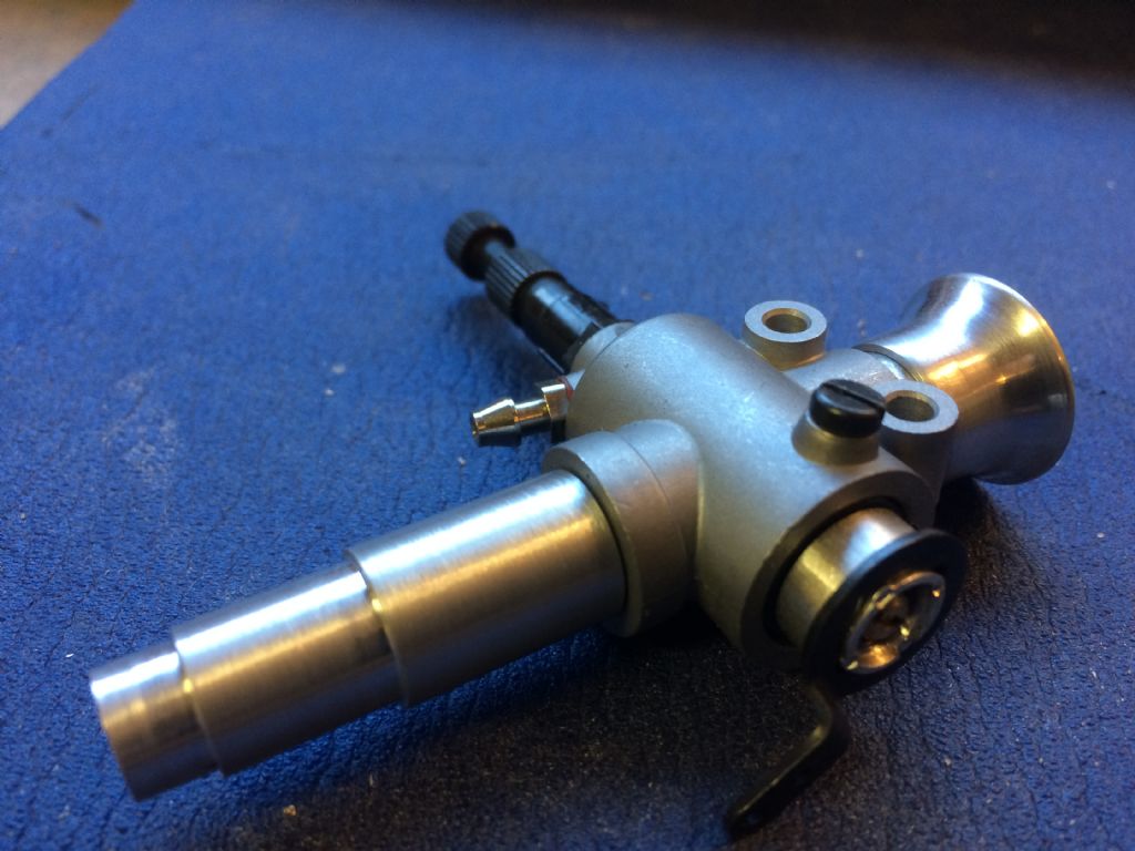

                                        Craig Booth 1
                                          @craigbooth1

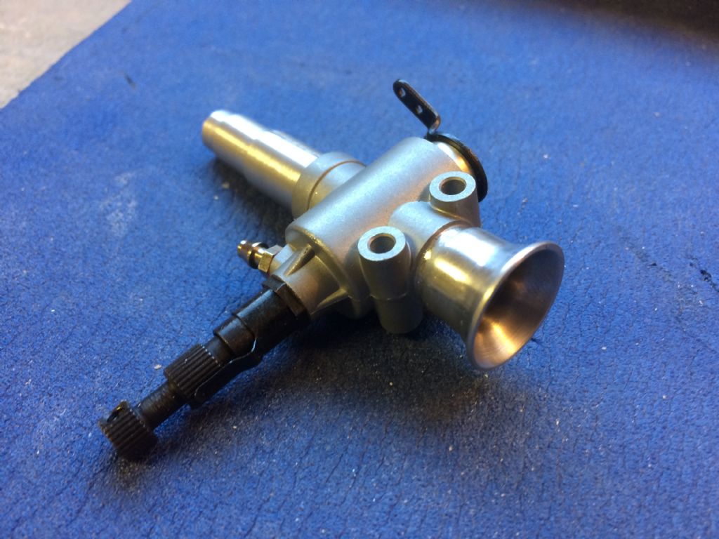

                                          For the carb I am using a standard unit from an A.S.P. engine and needed to make an adaptor that will fit the head.
                                          The end will receive an M10 thread to fit into the head inlet.
                                          I also had a bit of a play and made an inlet trumpet.
                                          As an aside I am also starting to organise the bits I need to do some DIY anodising. The trumpet, and rocker head cover will get a red anodising (if successful)
                                          #388168
                                          Craig Booth 1
                                            @craigbooth1

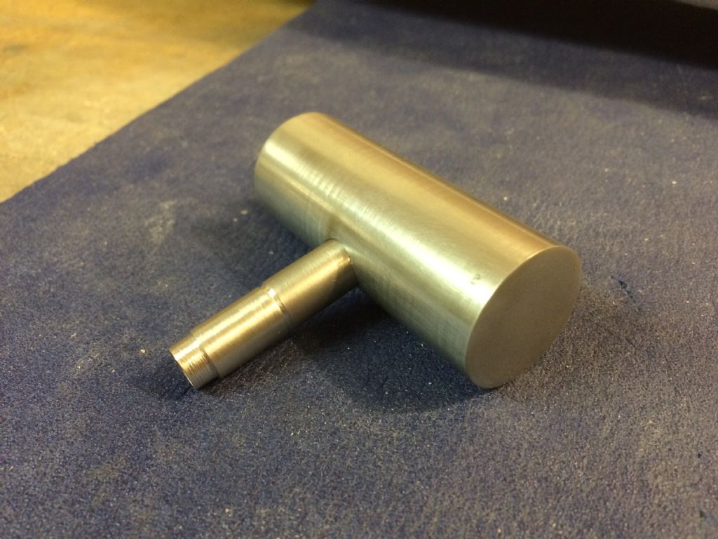

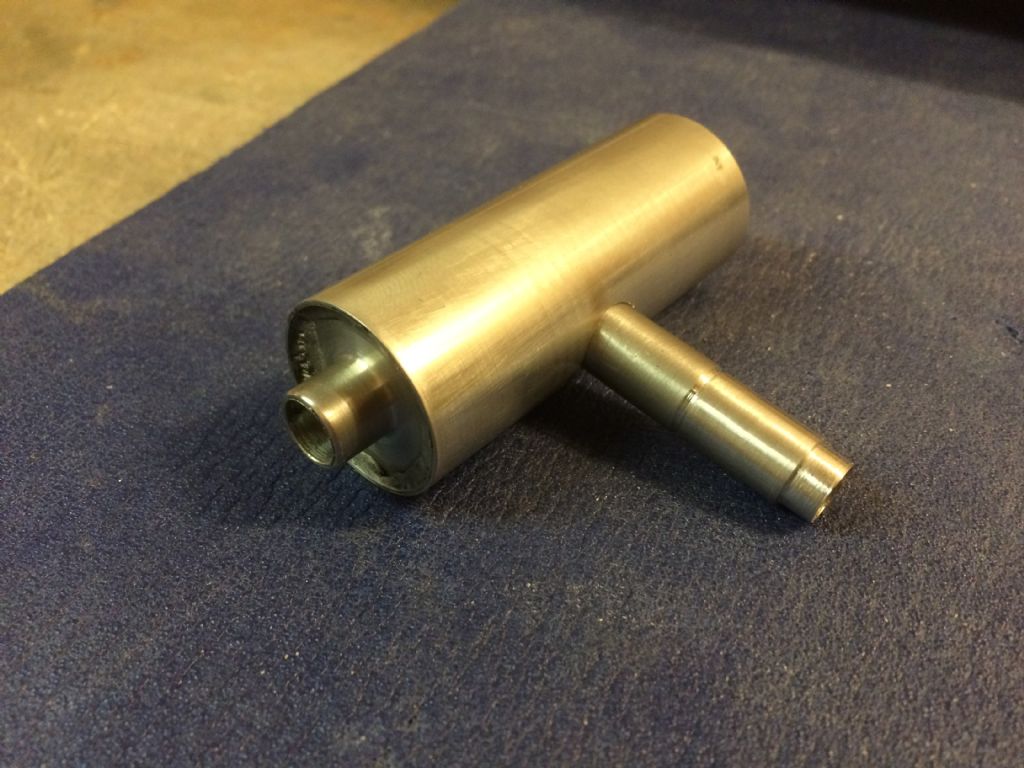

                                            On the exhaust side I deviated from the 2-piece unit on the plans and bored out from a single piece, then made an end cap with integral exhaust hole which I aluminium soldered into place.
                                            The head connection piece will also get soldered in once threaded.

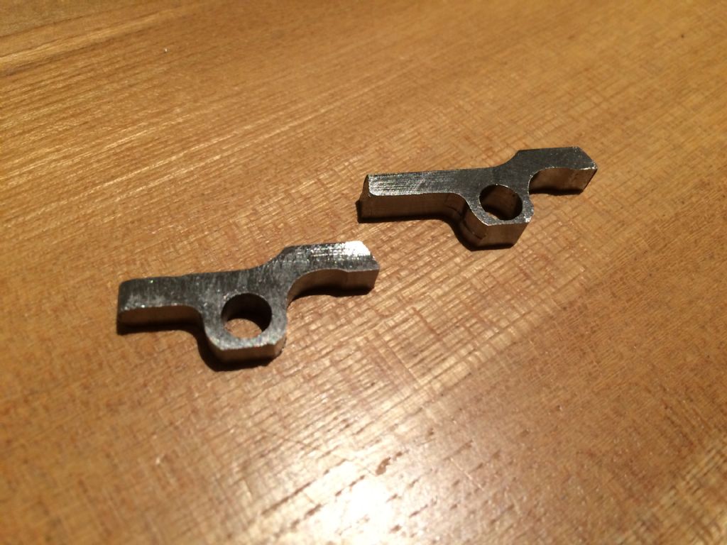

                                              Lastly, one unsuccessful attempt to make the rockers. Made from silver steel which I had to firstly machine out of 12mm round. Then made a jig to hold in place on the rotary table.
                                              All was going well, but made a silly mistake with dimensional error when I took a radius for a diameter and cut off too much length. So will be starting those again too. At least I have the jig to use.

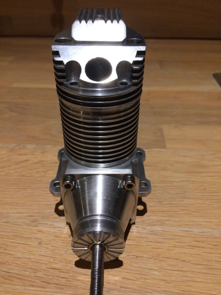

                                              #388365
                                              Craig Booth 1
                                                @craigbooth1

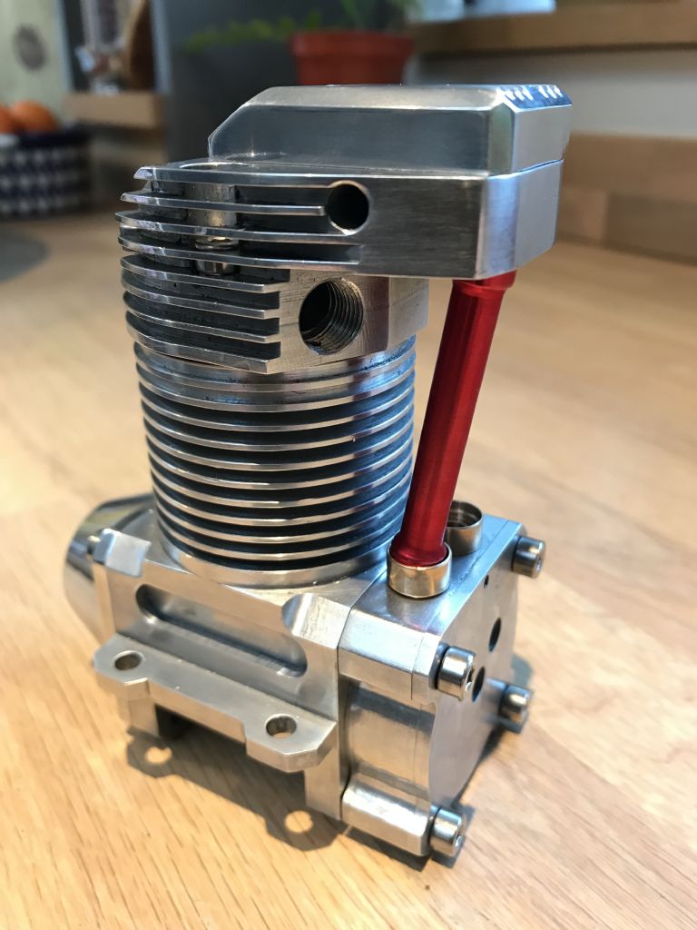

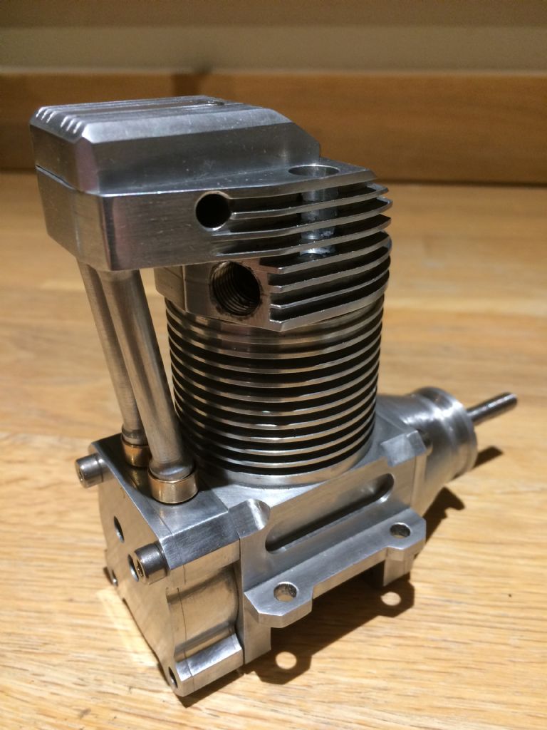

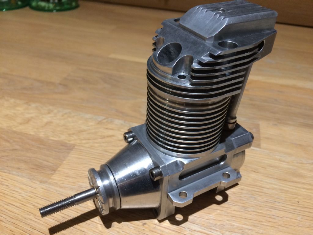

                                                Couldn't resist a temporary assembly

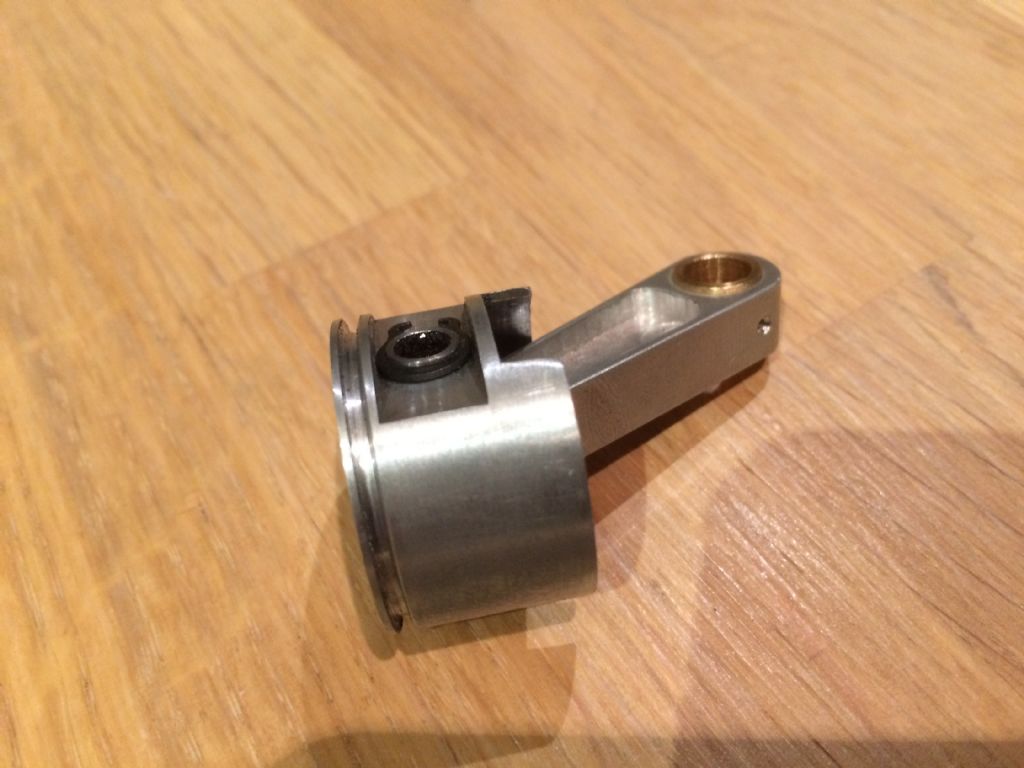

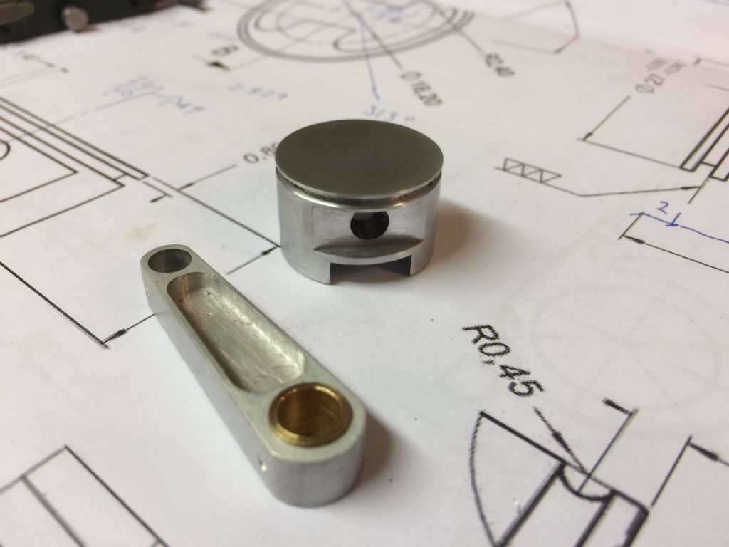

                                                  Ploughing on and tonight I got the piston and gudgeon pin finished. Happy with the fit. Piston is 0.06mm undersize to the liner.
                                                  What I'm not sure about is how I will fit the circlip on the other end of the pin. Looks pretty tight between the faces. Maybe need to try an E-type.

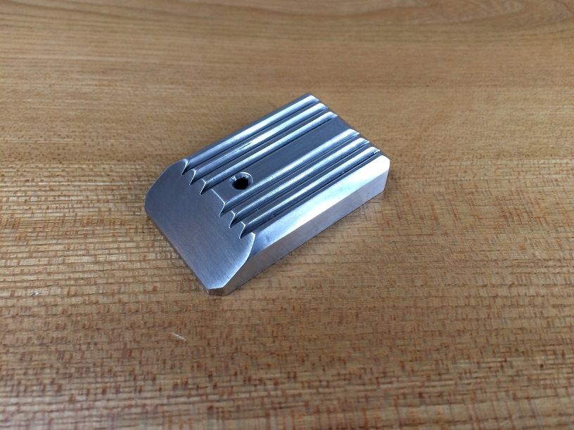

                                                    no real machining progress, but have been playing with a bit of home anodiziing. Mixed results. With sulphuric acid not available to the home user due to the new laws (unless you get a license), I've gone with using Sodium Bisulphate.
                                                    This part turned out alright. Think I'll also try doing the rocker cover.
