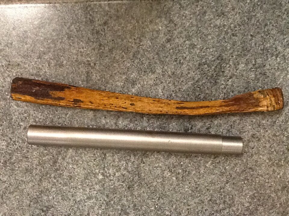

      I got hold of an old rusty keel bolt a few weeks ago, clearly wrought iron and badly corroded as well as bent like a banana. I salvaged two lengths, about 300 and 500 mm, cleaned them up with a hammer (!) and then roughed them down on the lathe. I reckon they can both be finished turned to give me about 25mm diameter. But what can I use this material for? Is it any good for model engineering work (stationary engine parts for example). I was thinking I could make some nice machinists jacks from it but I don't want to waste it if there are any better uses it can be put to.

                                                A photo showing the shorter of the two pieces I machined, and the remaining offcut which is probably a bit too far gone. The hammer heads look superb Jack. Is there anything else I can use to etch it with? I have a can of mortar cleaner in the shed, would that work?

                                                    Posted by Steve Pavey on 02/01/2016 20:47:24:
                                                    Ferric chloride is used to etch circuit boards and you can get it from Maplins. That is the accepted 'best' for etching patterns in metal.
                                                    You want a weak acid I think. Vinegar will do something. Lemon juice will reveal the pattern but may not etch deeply enough to preserve it for long. Some people claim coffee works.
