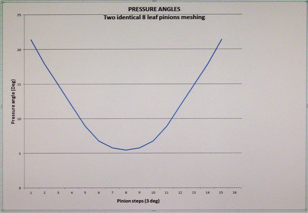

          I was totally wrong Bazyle.
          Rotating meshed identical 8 leaf pinions through 45 degrees in steps of 3 degrees, the pressure angle plot is parabolic, symmetrical about the vertical centre line, and dipping from about 22 degrees to 5.5 degrees (and back again).
          The trace of the line of contact wobbles slightly, tracking at an average of about 13.7 degrees.
          As with previous results and following the BS 978:Part 2 design parameters, the 'wobble' results from the radius of one tooth contacting the flank of the opposing tooth for at least 50% of the trace.

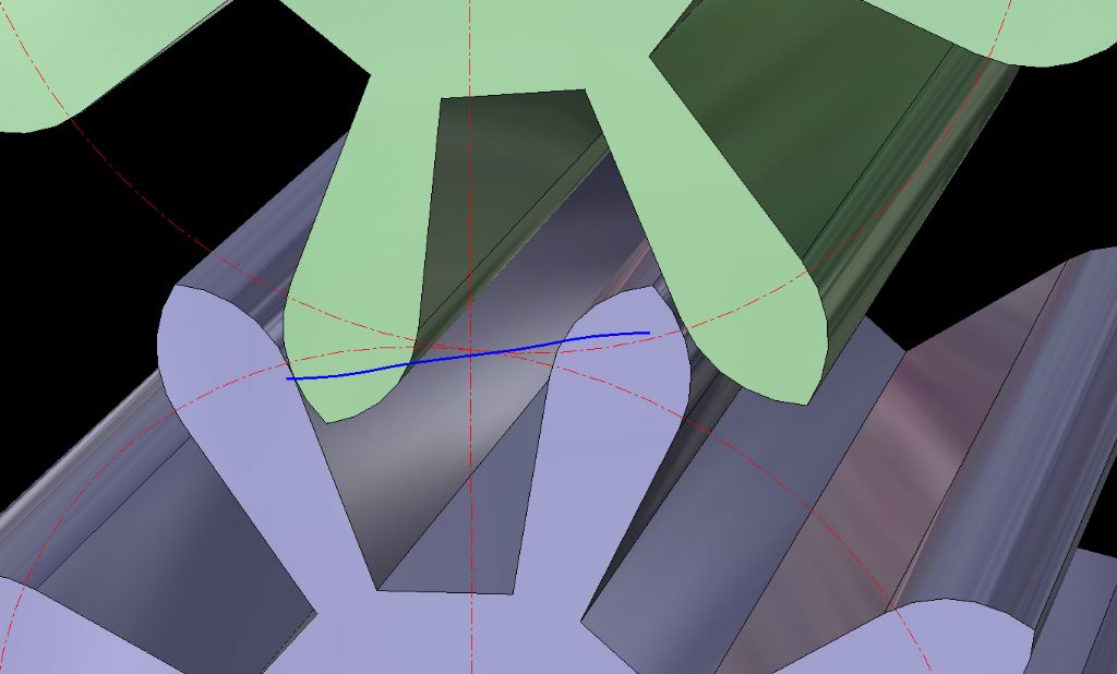

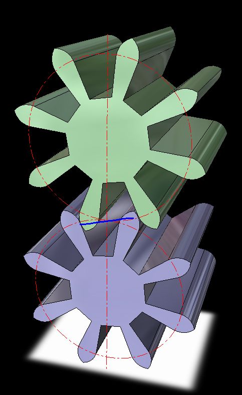

                From your question Bazyle, here are two identical ‘gears’ in mesh.
                I chose to use the 8-leaf pinions as a simple and quicker method to get the results. When I was doing the 290-tooth wheel meshing with the 8-leaf pinion, it was quite laborious ‘chasing’ a pinion tooth with a wheel tooth. There’s nothing in my CAD package that allows any sort of dynamic interaction.
                This close-up shows the contact trace, a slightly wobbly blue line at an angle of about 13.7 degrees.
                I have to confess that in view of the symmetry and a somewhat lazy attitude, I flipped (mirrored) a half-trace (left to right and top to bottom).
                Here's the plot of the pressure angle, also featuring the mirrored data.

                I couldn't bring myself to reduce the depth and plot each one as I did for the 290-8 and 198-7 pairs.
