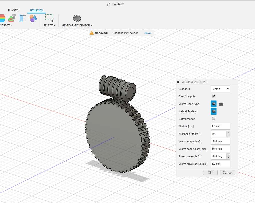

            Do you use a CAD program?  Not my go-to one, but I occasionally use Fusion 360 for those jobs that Alibre Atom doesn’t do.  Gear design is one such.  You can download and install an add-on to Fusion called “GF Gear Generator” to do the donkey work for you.. For example, I just knocked this up using random values:
            Worm drive
            From there, you can save the file for manipulation in your CAD program of choice.
              Is the add-on sufficiently asinine to draw the 2mm circular pitch 15 degree pressure angle item that the OP wants?
              It would be useful to know if it can cater for ‘non-standard’ gear parameters.
              And given that the trapezoidal thread will be used as a hob (where the thread depth is pitch/2), the ability to use/model a non-standard dedendum would be useful.

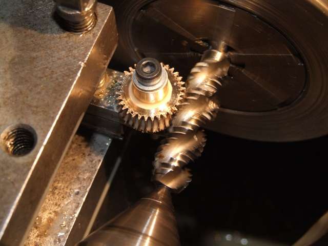

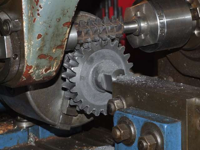

                      Cutting a worm wheel from a blank using a tap as a hob works well (a spiral flute tap is advantageous as there is always one section of the tap cutting):
                      Governor Worm Wheel Hobbing
                      But it is a bit of a crap shoot as to the number of teeth on the worm wheel and the consequent centre to centre distance.
                      If a specific number of teeth and/or a specific centre to centre distance is needed then it is better to start with a formed blank:
                      Worm_Wheels_1

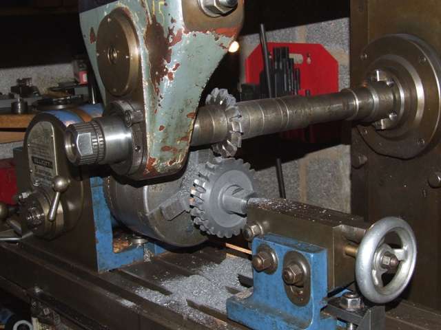

                      Gash the wheel with the correct number of “teeth”:
                      Worm_Wheels_2
                      And lastly free hob the final involute tooth form (the hob shown is home made):
                      Worm_Wheels_3
                      Andrew

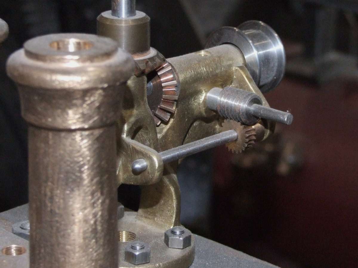

                                    To add to Andrew Johnston’s post above, I used this exact method to make the steering worm wheel for my 4″ McLaren traction engine. The home-made hob was made when making the worm. I made an extra long section of worm and used some for the actual worm and the rest was gashed and case hardened to make the hob.
                                    I too used Ivan Law’s book. I used it to make all the gear train and the diff. bevels.

                                        Correct, when gashing the table is set over at the helix angle. When hobbing the table is straight, as the helix is set within the hob. Setting over the table is simple as my horizontal mill is universal, ie, the table swivels and not the common, but incorrect, meaning of having vertical and horizontal milling capability. The same as Les the big worm/wheel set is for the steering gear on my traction engines:
                                        2024_03090004
                                        To the OP: It is of course perfectly possible to free hob a worm wheel using a tap. Don’t get too hung up on the OD of the blank. The trick is to feed fairly aggressively towards full depth so the tap cuts only one pattern of teeth. I’d be concerned that the tap mentioned is quite coarse with a small core diameter, so will be weak in bending. It will need the outer end supporting. For the specified application I’d use a standard V-thread. In the application I showed the thread is 7/16″ UNC and is used on the governors for my traction engines:
                                        2024_03090001

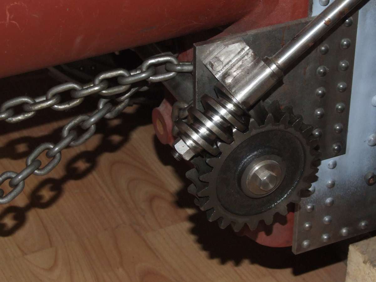

                                          I’ve also the question of what to use for my steam-wagon steering-gear. It is enclosed in a box bolted to the floor, so not easy to determine the original though the box’s shape and proportions do suggest worm and quadrant.
                                          That Denbigh is plain horizontal, no universality, so traversing a worm-wheel blank at its helix-angle to gash it would not be possible. In fact the only way I could do it with my equipment, is on the vertical mill (a Myford VMC), with the dividing-head set inclined to the horizontal by that angle. It would have no tailstock support though.

                                              The angle for gashing is not especially critical. Just set the dividing head on the Denbigh table at the appropriate angle, without using the T-slots. If necessary remove the alignment blocks on the bottom of the dividing head and tailstock. Getting the cutter centred over the blank so that material is removed symmetrically is more important than the precise angle.

                                                Question 2: If using a commercial tap to cut the worm wheel then it is not necessary to form an arc on the periphery of the worm wheel first. A tap will cut on both root and crest whereas a (home made) hob will likely not cut at the root. So a tap will naturally form the arc. In theory the arc should be designed to clear the core diameter of the worm. But in this application it is not necessary. For the tap free hobbed worm wheel shown above I started wtih a plain cylinder and let the tap cut as needed. For the worm wheel formed with a home made hob I preformed the arc to add clearance. This wasn’t a precision job; done with files in the lathe and checked against a marked out and filed template, as seen in my first post in this thread.
                                                Question 1: As a minimum the depth needs to be at least the depth of the thread on the tap. Beyond that it is really up to the machinist although it will depend, to an extent, on the width of the worm wheel. On my examples above I cut the worm wheel made with the tap sufficiently deep that I had the full thread form on the outer edges. The centre to centre distance on the governor casting was machined from the worm/wheel combination to suit. For the steering gear set I machined to a specific depth, determined by calculation, as the centre to centre distance was set during the design process. On the steering gear worm wheel note that the full depth of the teeth does not extend to the edges, there are small flats at the edge. This is common on commercial worm wheels as the sharp edges are delicate and don’t add much, if anything, to the power transmission capability.
