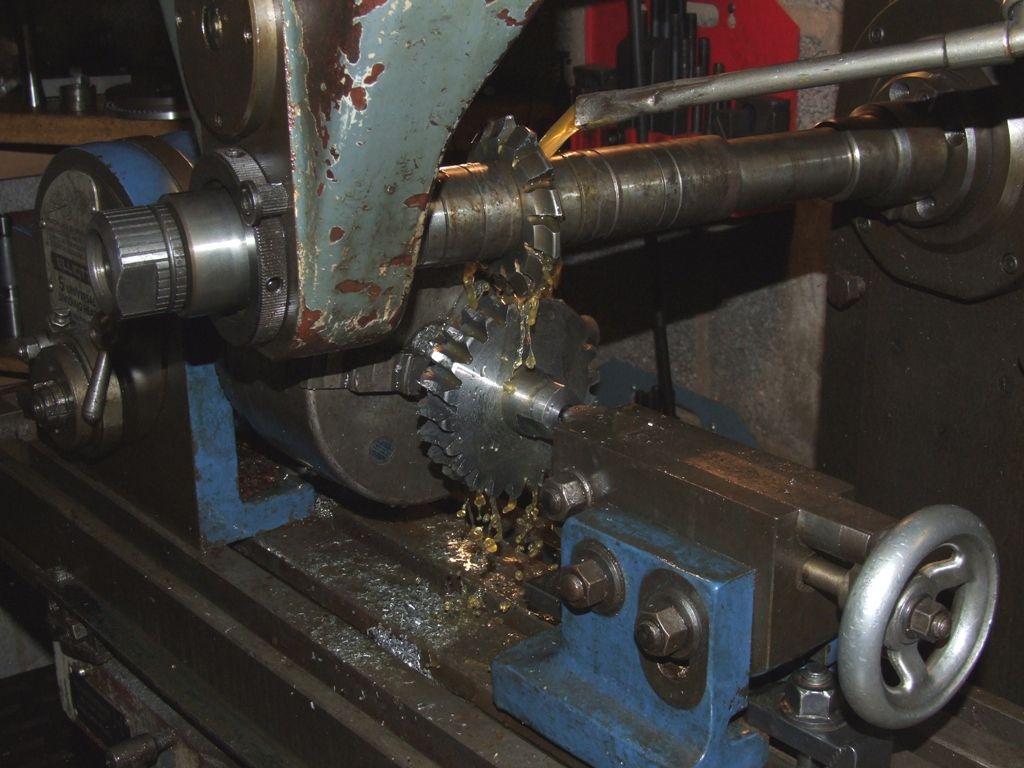

          I had a go at free hobbing a worm wheel today. A blank was hogged out of a lump of hot rolled flat bar, 'cause I've got loads of it and didn't have an aluminium blank of the correct size. The first milling operation is to gash each tooth. Ideally one uses an involute cutter of the correct DP, the right number of teeth, and the same diameter as the worm. I had a 6DP involute cutter for 21-25 teeth, which is close, but it's much larger diameter than the worm. A quick sketch in my CAD system gave me the maximum depth of cut without over cutting at the edges, which was about 89 thou less than the full depth. For gashing the mill table is set over at the lead angle of the worm (make sure you set it in the right direction wink) and the gashing cut is straight down. Here's the gashing set up:
          For free hobbing the table is set back square and the arbor on which the worm wheel is mounted fitted with spacers to allow the worm wheel to rotate freely. Since I hadn't been able to gash to the full depth I was a bit worried that the hob wouldn't engage and drive the worm wheel properly. I needn't have worried. I calculated that the full depth of cut was 11.75mm, and I was able to wind the hob in by 10mm before it started cutting. My horizontal mill has a clutch, which is really useful for tip-toeing up to the cut, allowing the hob to rotate, but slipping the clutch if there's a dig in. In the event the whole thing was a non-event. Here's a picture of the hob in action:
          Note the bodged support for the outer end of the hob, utilising a piece of steel clamped into the over arm support. The hob cut smoothly with no vibration or noise, despite the somewhat iffy, ie, non-existant, relief on the teeth. I cut to the required depth using the machine dials, and was pleased to see that the witness marks from the gashing just disappeared, which means I got my maths right for the various depths of cut.

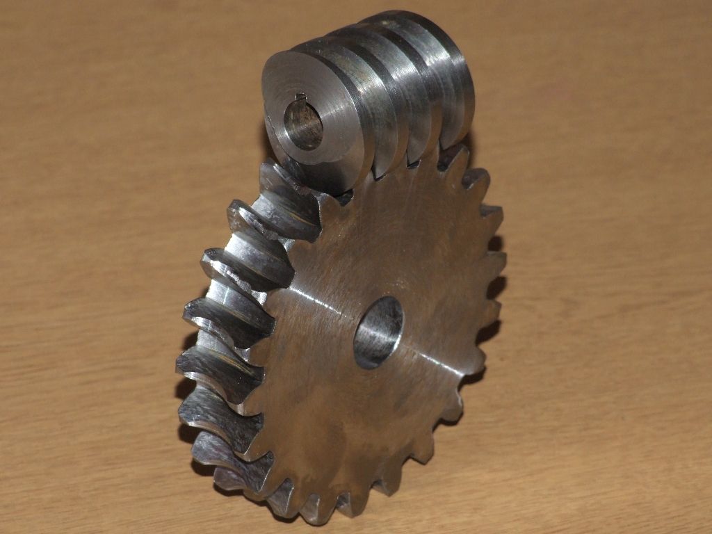

          Here's the worm wheel and worm:

                Jason: I was concerned that the hob wouldn't cut that well in hot rolled, as it has zero rake, and my experience of hot rolled is that it tends to 'smear' if the tools aren't sharp with positive rake. However, having had a close look under a magnifying glass I don't think that the hob was the basic problem on the throat of the worm wheel. As designed there should be a 25 thou gap between the throat of the worm wheel and the core diameter of the worm, and hob. But it looks like I didn't quite get the hob centred over the worm wheel, so at maximum depth of cut the core of the hob has contacted the throat of the worm wheel on one side and smeared some of it over a portion of the throat. Carelessness on my part, and being in a hurry to see if the hob would actually work, or if the whole experiment would end up in discombobulation.
                This is where the theory and practice diverge. The books glibly say centre the cutters (involute for gashing and the hob) over the blank and commence cutting. But they don't tell you how to centre the b***y cutters! I should have made a better job of centring the hob, but the involute cutter for gashing is more of a problem. The instructions say centre the cutter in both X and Y over the blank and then swivel the table. But the cutter will only stay centred if the blank is exactly over the point where the table swivels? So I swivelled the table first and then attempted to centre the involute cutter. In the Y direction, at right angles to the worm wheel axis, I used the trapped ruler method, which I think is probably good enough. However, in X, aligned with the worm wheel axis, I winged it by estimating when the cutter was just nicking each side of the throat and took that as the centre. I suspect that the throat wasn't precise either, cut by hand feeding a button insert tool followed by a file. All rather crude, but not really the main purpose of the experiment. The main purpose was to test whether I could make a home made hob that would then free hob a worm wheel. From that point of view I think the experiment was successful.
                However, when I make the real worm wheels in cast iron there are a number of secondary things that I need to pay more attention to:
                1: Ensure that the throat is properly dimensioned and is central on the blank – possibly by making a measurement jig, or a form tool.
                2: Take more care to centralise the gashing cutter in X and Y
                3: Take more care to centralise the hob in X
                As an aside one can see an number of 'facets' on each of the teeth. I assume this is where the individual teeth of the hob have taken a cut, more teeth would give a smoother finish, but result in weaker teeth.

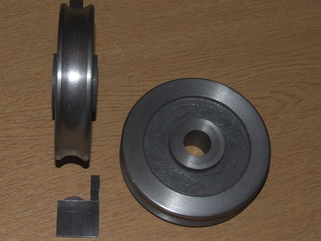

                        More progress, I've marked out and filed a template for the worm wheel throat from steel sheet, and finished the cast iron blanks for the final worm wheels:

                                  Yesterday, while the CNC mill was whirring away cutting the teeth on a bevel gear, I gashed and free hobbed the real worm wheels for my traction engine steering gear. To save space I haven't posted pictures of the gashing and hobbing processes, as they're not much different to the earlier tests; minus the coolant though as the real parts are cast iron. Here are the machined worms and worm wheels:
                                  I made a few changes from the procedure used to make the test worm wheel. When gashing I didn't cut quite so deep, 9mm instead of 9.5mm, the idea being that the hob would give a better looking result if it had to remove a little more from the bottom of the tooth spaces. I also took more care to centralise the hob before cutting. The main change was after hobbing to full depth; I upp'd the spindle speed, to 117rpm, and wound the cross axis over about 1/2" in small steps in an attempt to get rid of the faceting on the worm wheel teeth due to the straight flutes on the hob. Here's a close up of the worm wheel teeth, warts and all:
                                  The picture was taken straight after machining, I need to do a bit of deburring and cleaning up. The finish isn't quite as bad as the picture suggests, but importantly the faceting seen on the test worm wheel has disappeared.
                                  The parts are not perfect sad, but I've learnt a lot, had some fun, and it's now time to move onto other items.

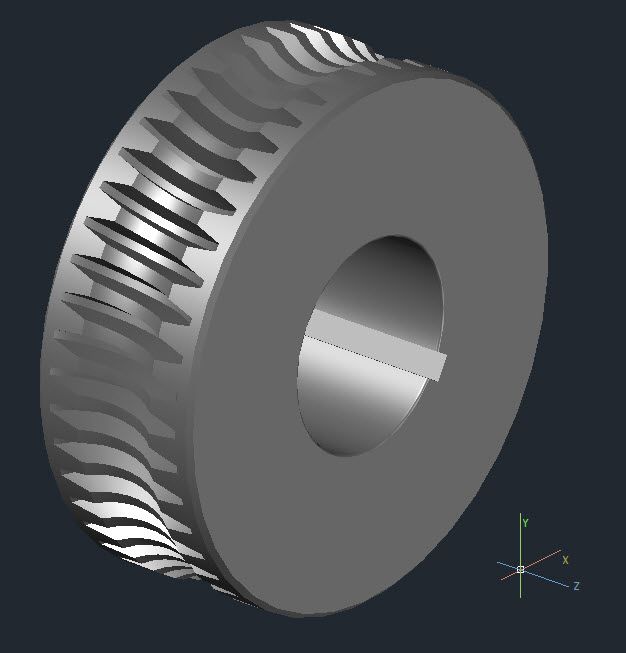

                                    Thanks Mark for the tip re drawing a worm gear.
                                    This one was drawn with AutoCAD as a solid model. it was drawn freehand the geometry is just a guess. Now I will have tor try to get my head around designing proper worm wheels.
                                    Regards
                                    John .
