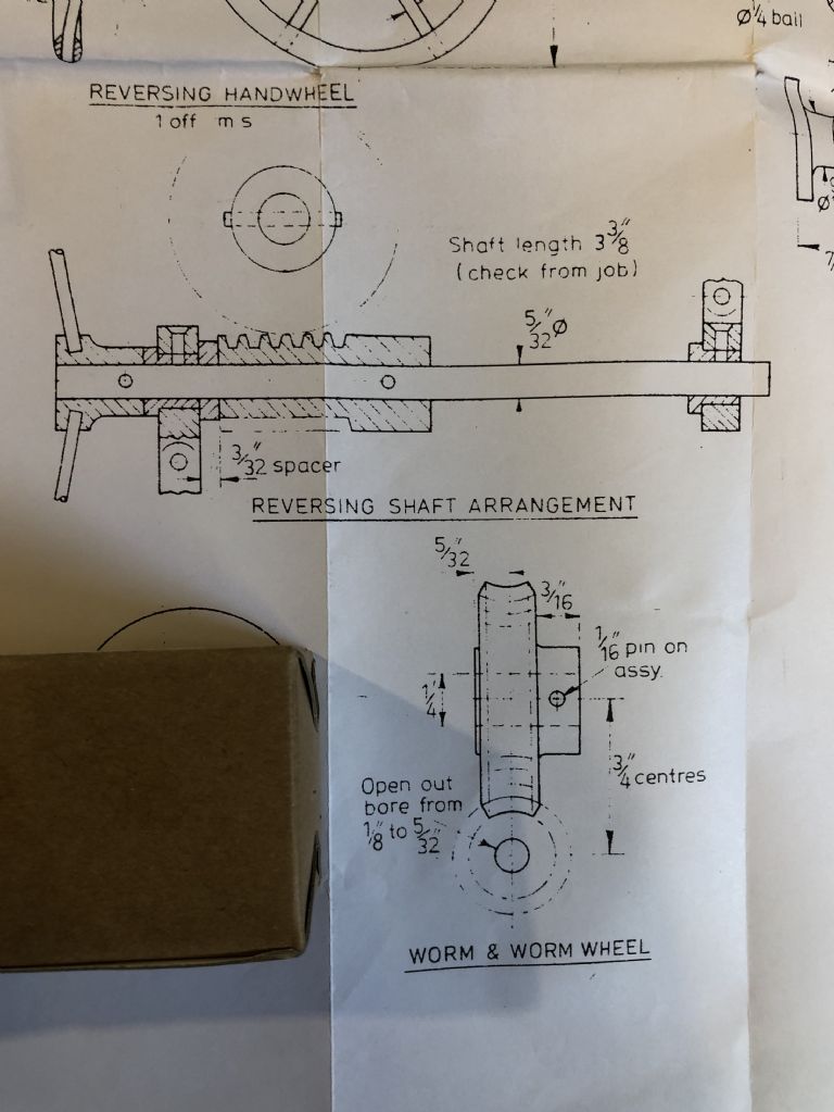

                    So now I am at home, I can properly get my head round making a worm and wheel.
                    The drawing is here, I believe it’s a 40:1 ratio and shown diagrammatically as an acme thread. In reality I guess it won’t matter as long it it looks about right, but I’m a bit disappointed the pitch isn’t specified as I believe I need that to calculate the wheel diameter.
                    If anybody can help me decipher this, so I can get on, I would appreciate it.

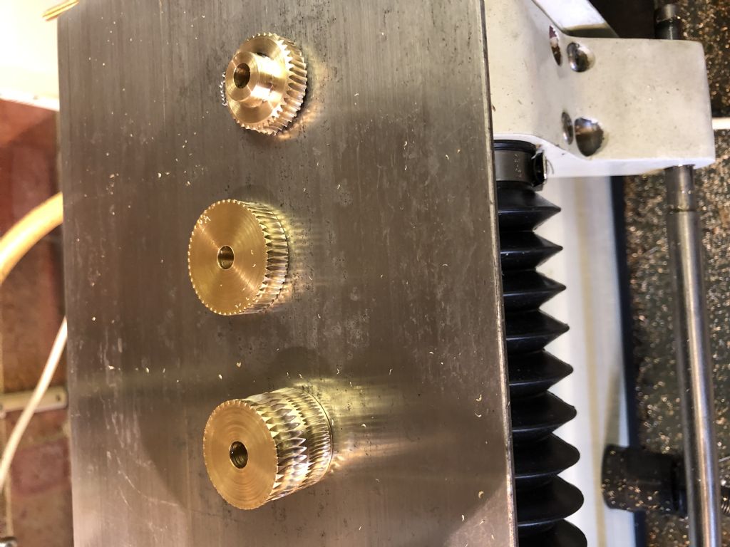

                        a583dd96-9e7c-4842-b40e-8b93957a100d.jpegThanks to everyone that commented particularly by PM.
                        If only I’d known it was so ‘easy’!

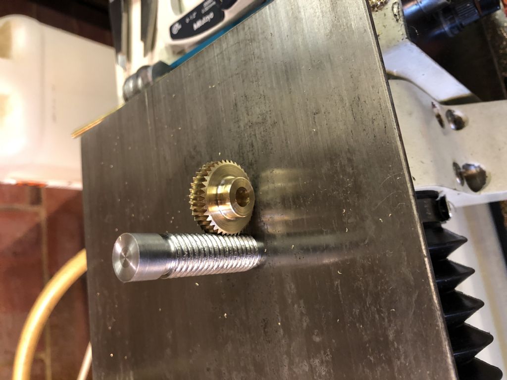

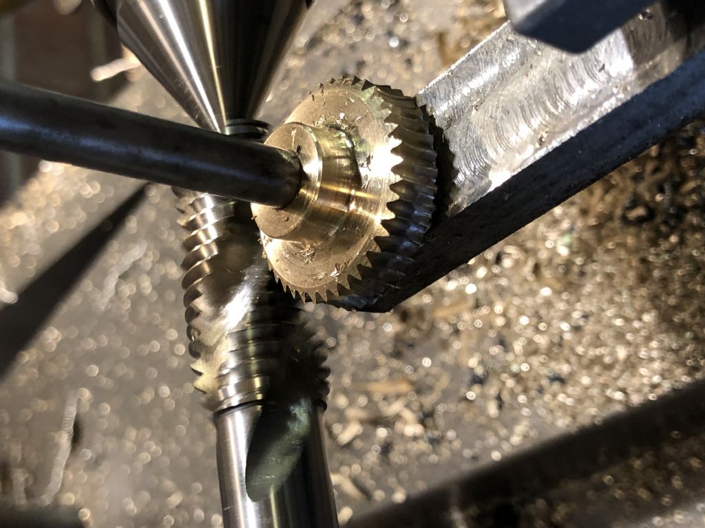

                        I’d bought a 16x2mm spiral tap which recently arrived.

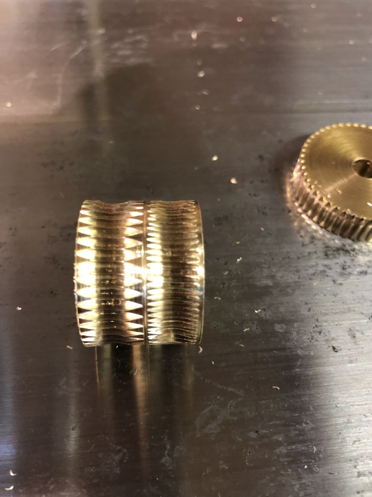

                        I wanted 40 teeth which gave me a .0787” x 40 = 3.148 circumference equating to 1.002” diameter.
                        I tried a couple of bits of scrap first to get the technique, I got the in feed wrong and double cut, if I’d continued to in feed it might have sorted itself out. The larger diameter gave me 47 teeth
                        Once I was confident I tried for real, then cut a 1/2 “ x 2mm pitch worm to see how it looked.
