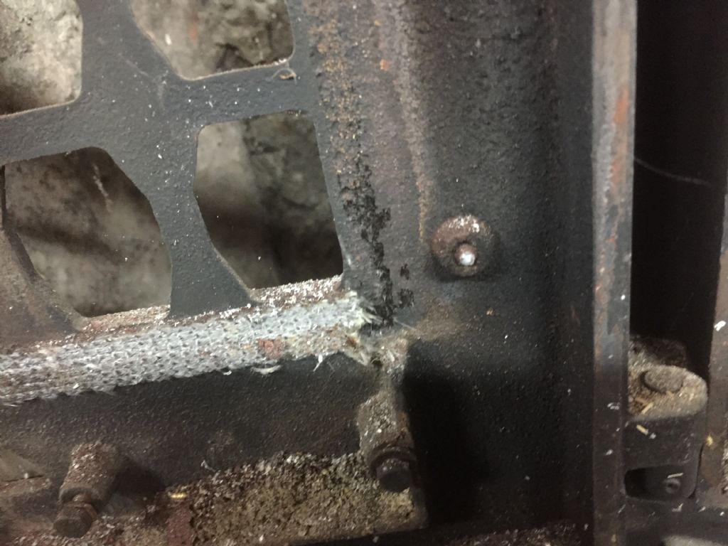

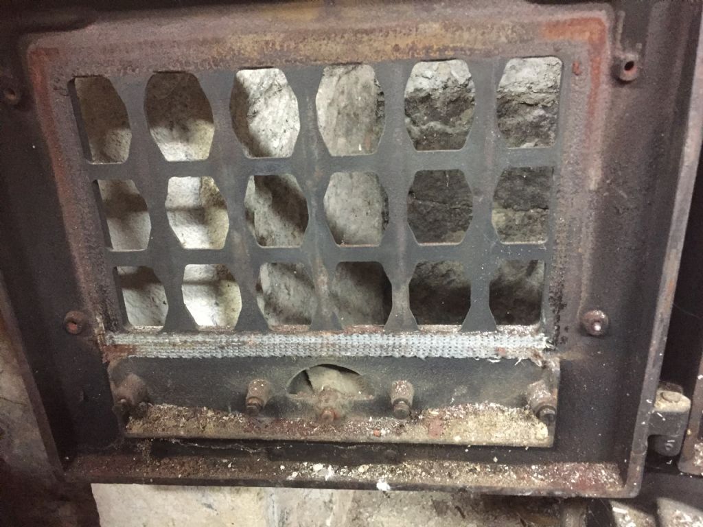

      I have broken the glass on my ancient Coalbrookdale workshop stove. I've sourced replacement glass, but when I removed the four screws which fix the glass-retaining plate to the door:
      one (there's always one!) sheared:
      The 'screws' (bolts?) are 3/16 x 1/2 inch 32tpi fully threaded hex head, so BSF presumably. Two questions:
      • Can anyone recommend a supplier for replacement screws? Searches so far have draw a blank.
      • Any suggestions about dealing with the the sheared screw? It's pretty well corroded in place. The door comes off easily so could be mounted on a pillar drill.
      Robin

          2BA ?
          Drill it out and re-tap 1/4"/ 6mm.
          Weld a nut on top of the remaining screw, penetrating oil and they usually come out.

            As Richard suggests, 2 ba will fit in 3/16 BSF, if you can't get it out without damaging the thread I'd drill right through and use a nut and bolt, appearances matter less in the workshop.

                  Lots of videos on Youtube about removing sheared bolts/screws. yes Most involve heat, or drilling, or both. And penetrating fluid. As an example; you could go to Abom79 and search his videos for seized bolt removal.

                        My "go-to" for broken screw removal after 50 years of restoring and maintaining vintage machinery is left-handed drill bits. Yes they are a real thing. You run the drill anti-clockwise and use a LH bit a little smaller diameter than the root diameter of the thread. So probably about 1/8" for a 3/16 screw to start with. Most often, the broken screw or stud remnants unscrew themselves while the drilling is in progress. The drilling seems to release the tension on the thread as the hole progresses and the anti-clockwise cutting forces do the rest. Sometimes you might need to go up a drill size and redrill closer to the thread roots before it breaks loose.

                          First port of call, every time these days, is my set of left-handed drills.
                          I start with a normal clockwise drill for the pilot (they are common and cheaper🙂 ), then change to larger left-handers progressively. Centring the pilot is quite important, but not generally a paramount requirement – more so on smaller diameters, I suppose.

                            That looks very much like chrysotile Asbestos rope seal around that !!!

                                      Juddy: Very likely chrysotile given the age of the stove!

                                            I made up this concoction and no joy, so I though I'd have a go with the 'welding a nut on' before resorting to drilling. To my surprise (I'm terrible at welding and there wasn't much of the sheared screw protruding) it worked! Maybe the heat had something to do with – it came out fairly easily.
                                            As it would have been a couple of days before I could get down to my local supplier for 2BA screws I thought I'd have a go at faking them up myself, so made some bits of 3/16x32TPI stud on the lathe and welded on M6 nuts. Not pretty, but they worked. It'll be one of those stopgap fixes which never get 'done properly' I suspect. I have only 60 degree threading tools, so maybe not quite right, but the internal threads in the CI are pretty roomy and forgiving.
                                            Anyway, thanks to all for advice – problem solved, and workshop is now running at a tolerable 17.5C.
