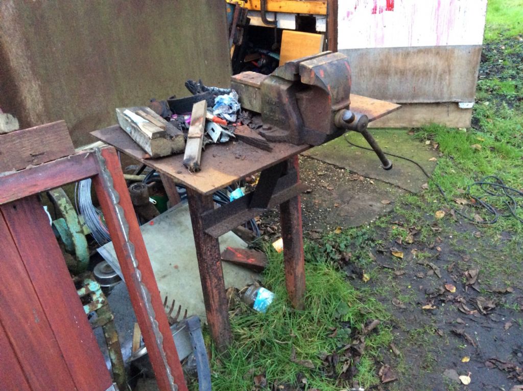

                benchHi It’s very good idea to use your grinder outside,the wind and rain cleans the mess up.
                Easiest way to mount it ,is get a small piece of kitchen worktop or similar and bolt grinder to it then screw length of 4 x 2 to bottom of worktop. This can then be clamped either in either a vice or a Black and Decker workmate.
                I’ve had an outside vice for years for big and dirty jobs also an outside bench Hope this is useful.
