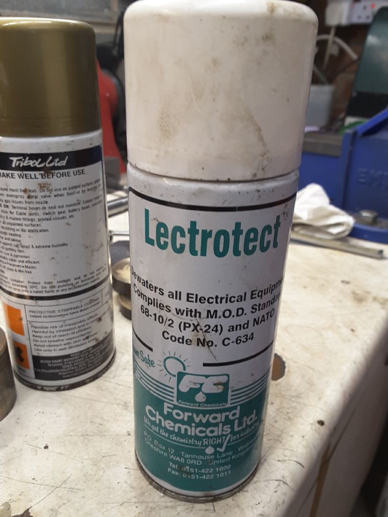

            The military use PX24, with variants called PX32 etc with varying viscosity. The aircraft get liberally coated with PX24 when operating over saltwater.

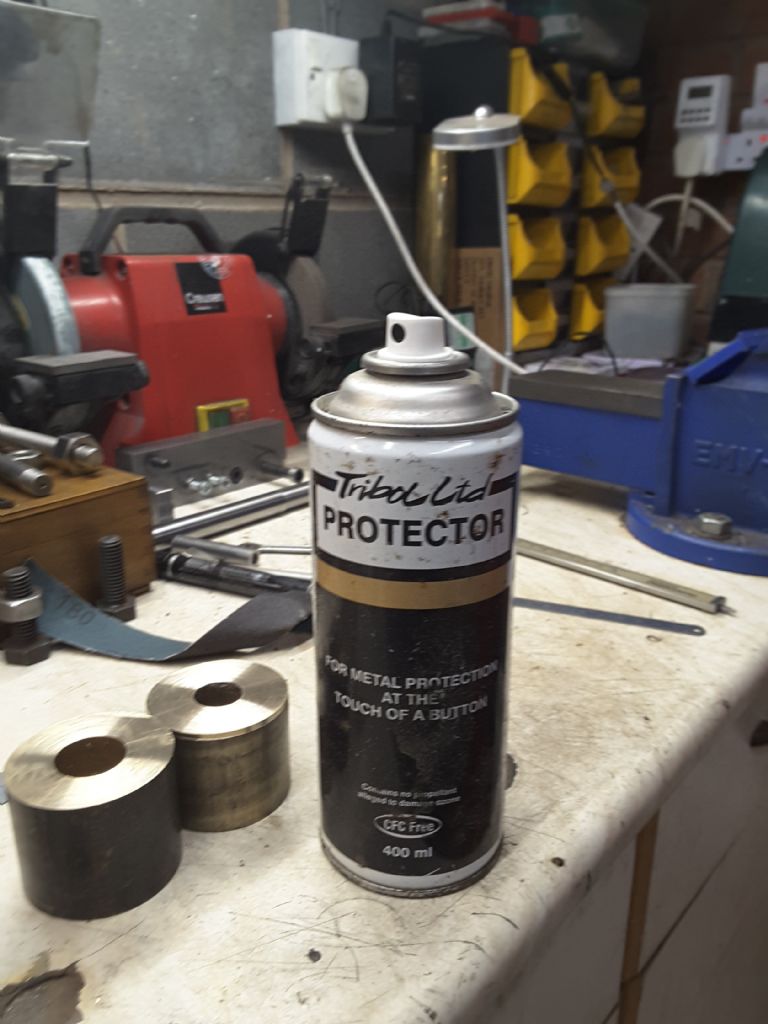

                          Last night I got my go to rust prevention aerosol out to look at it for more information. This morning it was all over my bench spraying my next prodject and drawings etc. I found that the can had leaked about halfway down like a pin hole in the metal. I presume rusted from the outside from a scratch as the can is at least 20 years old. The spray forms a plastic like coating when dried and prevents rusting etc. Still hsve one more can left. I also have a can of dewatering fluid which you can spray on to anything to get rid of moisture.
