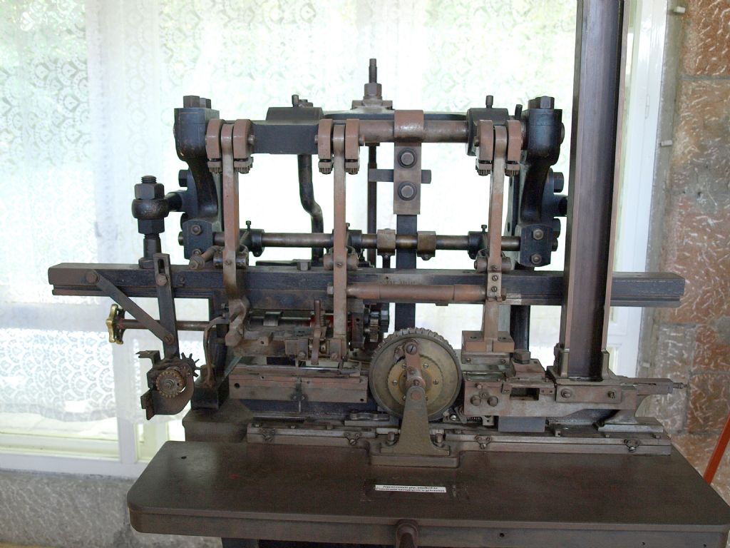

                                          When I was out on your plains in 2008 I took some interesting pics but have no info on the details.
                                          The Loco picture you may be able to identify, if not I have some more images. If you look carefully you can just see the missus peeping out of the first carriage window.
                                          The second is a poser for your or anybody else that takes a look.
                                          It’s a machine found in a station waiting room, not operational, that’s obvious.
                                          It may have been on the kiddies railway but I can’t guarantee that.
                                          It just look a tremendous piece on engineering, god knows how old it is and what it is.
                                          It will be interesting to see what ME browsers come up with.
                                          P.S.There’s no prize for getting it right but then I wouldn’t know if it was right!!

                                            By the way I think the curious machine is a ticket printer. I have seen something similar in the Museum of Transport in Budapest.
                                              I think it is too. I did a bit of checking, and it’s just possible that this is a very old Goebl machine, of which there are supposed to be very few examples. Just in case anybody was wondering, I think you put the blank tickets in the stacker on the right, and they pass through to the left. I presume that there’s some sort of power source underneath – can’t see how it can be driven otherwise.
                                              Bet you needed quite a solid floor to mount it on! (just to keep this OT)
