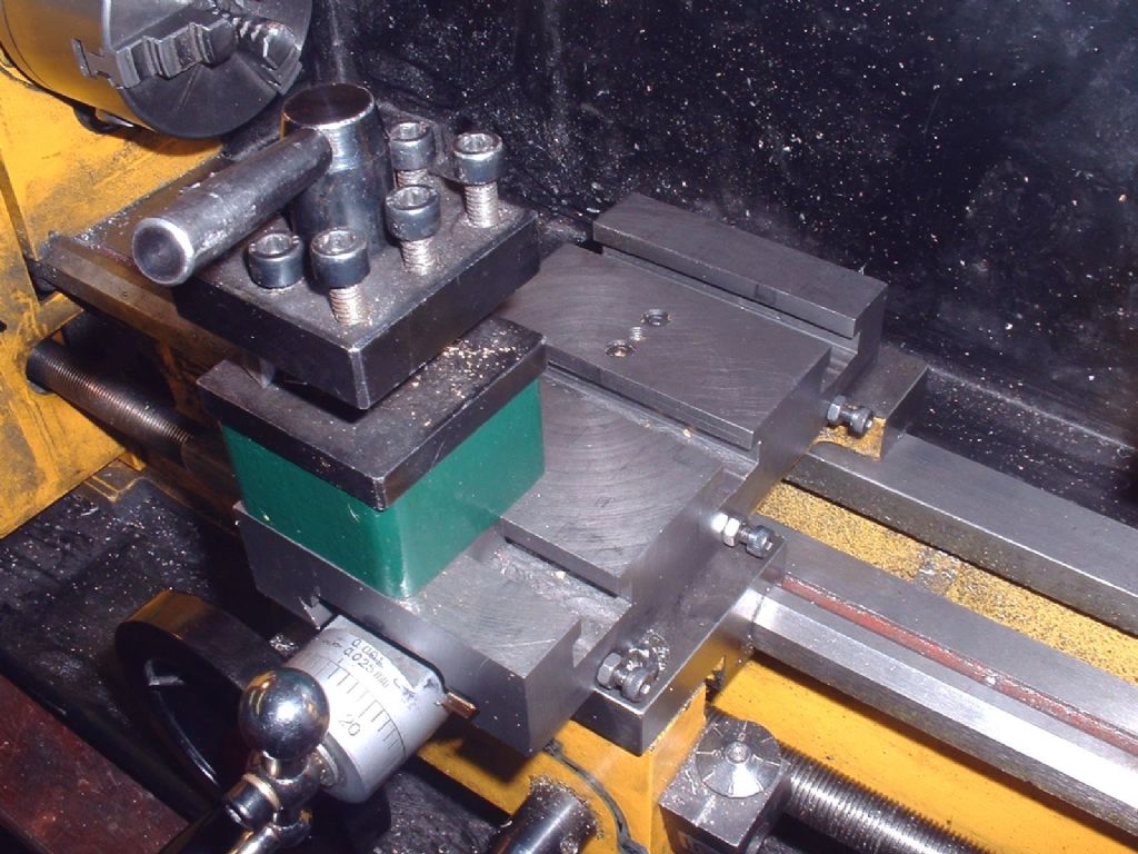

            I have worked block of meehanite. Heat treated, machines beautifully with a gentle hissing noise and produces fine filings. You can machine a satin finish with a round nosed HSS tool. It is resistant to shock and quite strong in tension so good for machine tool slides and components. Here’s a lump for College Engineering:
            And the end result:
            #59363
