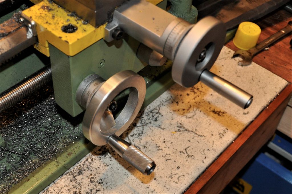

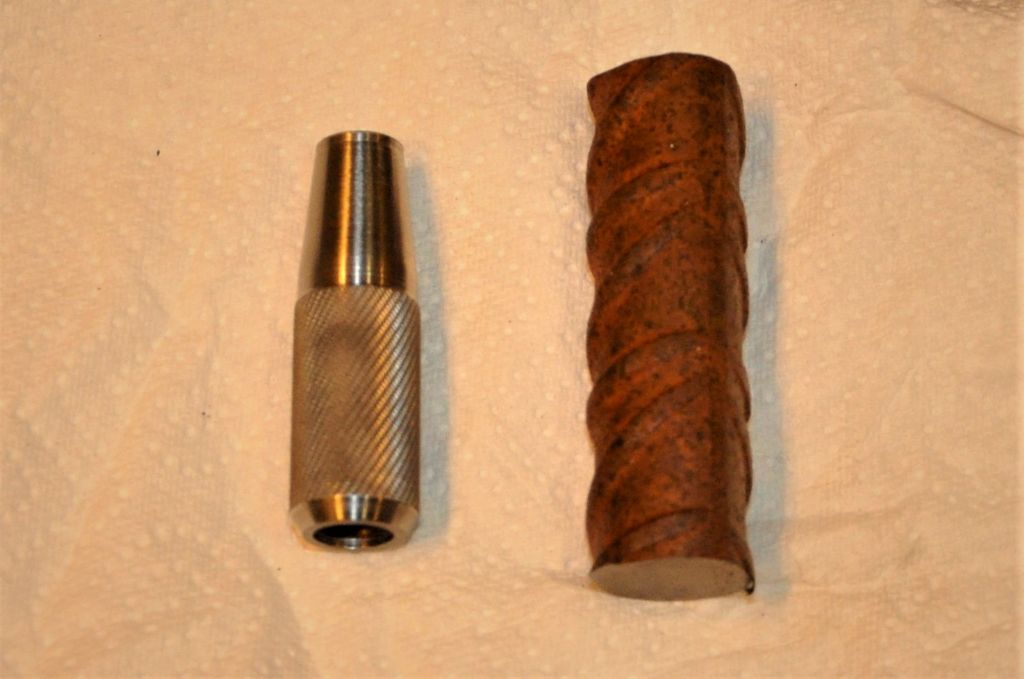

      For my first project on the WM180 I decided after watching YouTube to have a go at turning new handles starting with the carriage handwheel. However the only metal I had available was a bit of rebar so that's what I used. My workflow was as below but I was a little uncomfortable with the last three steps which didn't seem quite right.
      I wanted to ask if there is a more logical sequence to follow, and how should these tasks be approached. As it turned out (no pun intended) I was quite happy with the result, but as I said the method didn't seem quite right and was it more luck than judgement.
      1) Remove deformities from surface
      2) Drill 8mm hole through to take original screw and widen at end to accomodate screw caphead. this widening was made a little deeper so that the handle could be made longer than the original.
      3) Chamfer edge of piece.
      4) Knurl along length for handle.
      5) Set required angle on compound slide and turn taper from knurling towards the chuck.
      6) Measure required length of handle and part off.
      Here are photos to help with the explanation, any advice on this or anything else to do with lathes would be much appreciated.

          Good result Keith, and exactly how I would have done it.
          If you'd hit bother, I'd have said nasty things about turning rebar. Apart from the need to hack back to a smooth surface, the specification of the steel is unknown. Whatever grade of steel is in your particular example, it's structural, not meant to be machined. Using it is a bet, not a safe engineering choice.
          The gamble paid off, but poor choice of metal can cause awful grief! I advise against beginners turning scrap because they can't tell if bad results are due to them, the lathe, tool-settings, or duff material. Easier to work with scrap after building experience with friendlier metals intended to be machined.
          I had a bad experience early on – unknown to me all the scrap in my junk box was Awkwardcussium. For a while I thought my lathe was incapable of cutting metal. So much more straightforward when I defeated my mean streak and bought suitable Aluminium, Mild Steel and Brass from my local emporium.

            My method would be 1,3,4, then 2. But there is always another way to do anything….
            Pete

                      Nice result. You left out last step – setting topslide back to parallel laugh
                      #462570
                        Yep, nice result.
                        That said I always knurl before chamfering etc. because I get a crisper result that way round.

                          The only reason I mentioned Another Way, was to drill the hole (therefore weakening the piece) after the knurling operation. I always find the knurling the tricky bit, so if it goes wrong, just start again, with the least amount of work.

                            Great result mate, I am with Neil I would taper and chamfer after knurling and possibly use a piece of leather to protect the knurled part if needed.

                                I'd probably have followed the same sequence, but I do note the suggestion of knurling before drilling.
                                One thing not mentioned… don't use your best self-centring chucks for turning rough stock. It puts unfair, unequal stresses on the chuck. Use a 4-jaw independent chuck.
                                As for what Dave called Awkwardcussium… I expect we've all been there. In my case not long ago with some 18mm diameter supposedly-mild steel (well, it was rusty outside and silvery-grey inside) from a scrapped cable-drum tie-rod. I thought it is just plain old drawn EN3. Perhaps it is, but it proved as tough as old boots and would not yield a decent finish no matter what I did, and I had to find some better metal. Even so I do have one use for that Mild-Awk~, but requiring only facing, drilling and tapping the ends and simply cleaning and painting the surface.
