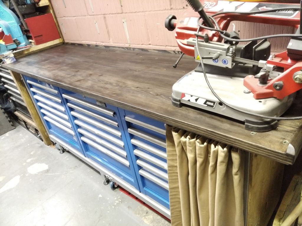

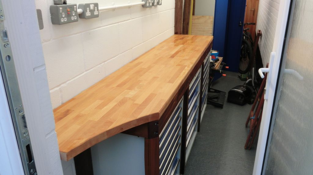

          When building one of my workbenches, being on a tight budget as had to factor in the steel which was all welded to make the frame, I opted to buy 3 lengths of 2" thick planed edge pine timber, although even this wasn't cheap really, it was a while ago now but must have been about £25 each, I put some quadrant around the back edge and sides to stop things rolling off, probably the best thing I ever did, later I made a worktop for my Snap On toolbox because the official one was quite expensive, I bought a 3 metre length of 40mm thick Oak Butchers block style worktop on eBay for around £150 delivered, I'd definitely save the hassle of making a worktop knowing such nice quality worktops are available so cheaply, all it needed was a rub down with some 400g then a wipe over with some stain on a rag, then the same with some Danish oil, obviously had to cut it to size a router the badge bit out.
          Some kitchen worktops might be a bit slippery when working on things, may or may not be an issue, bit something to bear in mind.
          My pine worktop now has quite a few of those metal inserts that sit flush so you can screw machine screws in to hold various things.
          Snap on worktop
