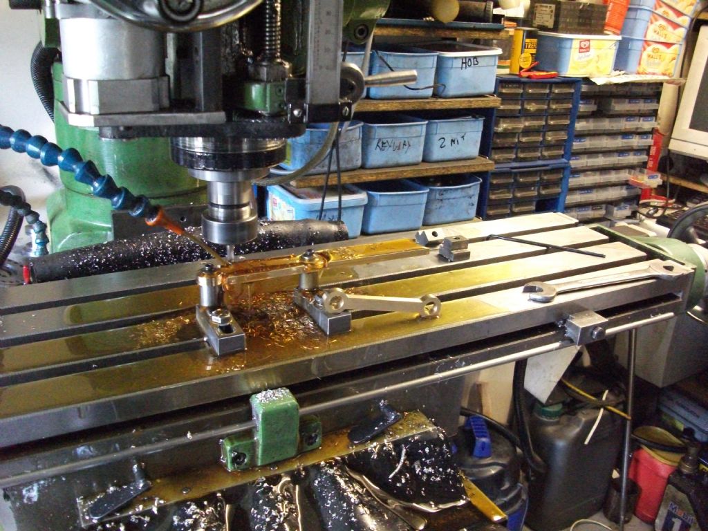

      This is the crankshaft for my Farm Boy engine.
      The big and little ends still need to be bored out to 9/16" and 5/32" respectively. It's about 5" long and 1" wide, 3/8" thick. Having made this on my Denford/Sherline mill I'm not terribly happy with it, partly due to the software – which I can address but also to my work holding method.
      So, how would you go about mounting this on a CNC mill, bearing in mind that it needs to be flipped over since both faces are the same?

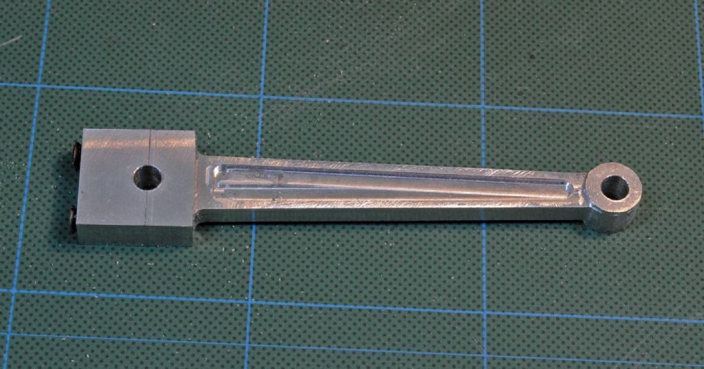

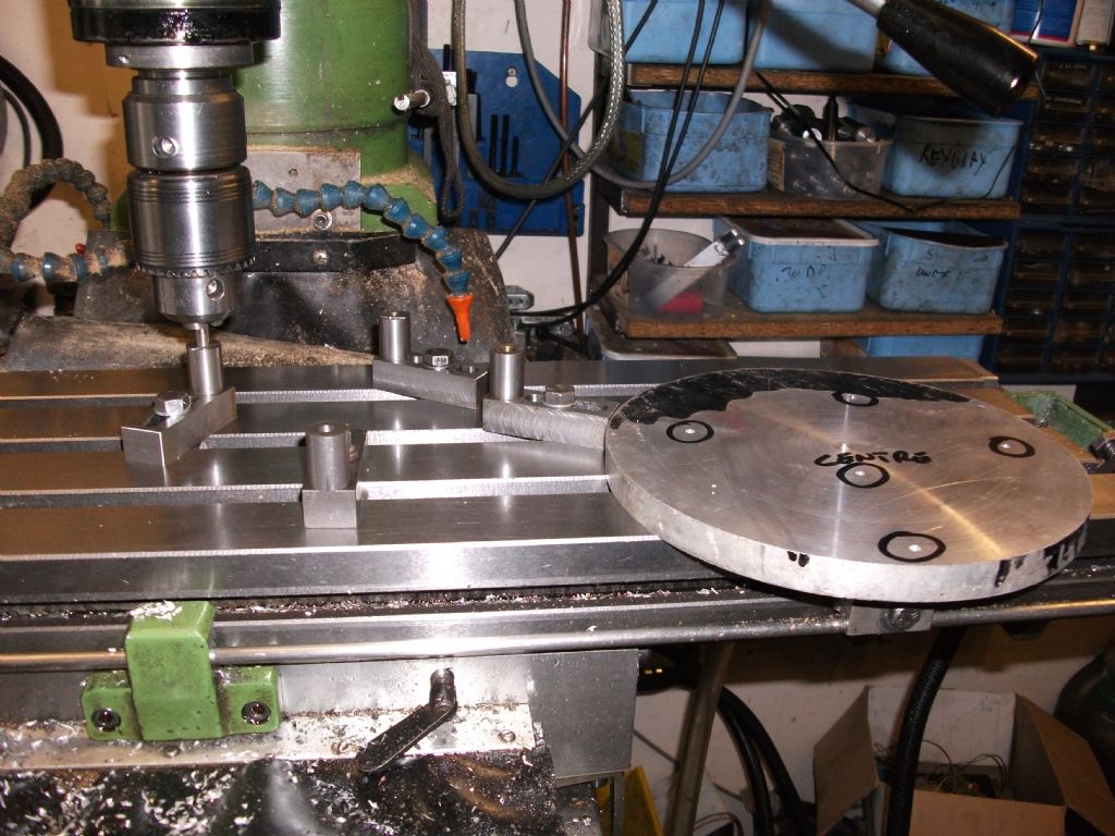

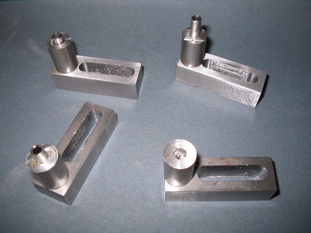

                I use these simple fixtures for these sort of jobs seen in an article
                in Mew January 2015 " Cnc fixings" .The pillar attached to the
                slotted part is sacrificial can be made to any size and has a
                hollow dowel and typically 4mm thread for fixing ,placing these
                on the machine table can be part of the cnc cutting file ,i hold these
                in a chuck and let the machine locate the position.The slotted part
                must obviously be large enough to pick up the nearest tee slot.
                The first photo shows four of these fixtures the second shows some
                brass connecting links for a hot air engine being cut.
                #409332
                Roderick Jenkins
                  @roderickjenkins93242
                  Posted by Martin Connelly on 14/05/2019 18:33:52:
                  Connecting rod?
                  Martin C
                  Brain fart – sorry
                  Thanks, guys, for the comments. I drilled the 2 holes using the DRO on the manual mill and then transferred to tee bolts on the CNC mill table – not accurate enough needs reamed holes and accurate pins but I basically used Jason and Andrews recipe. I like John's fixtures, I'll look out the MEW back copy.
                  The 2 1/2 D CAM from Denford is pretty basic and I had to fiddle around with variations of the DXF file to get the CAM to understand where I wanted to cut. Fusion 360 has a Denford post processor so I need to watch some more of Lars Christensen's videos and dive in.
                  I'm wondering whether the Blue Tape and Superglue method (video here ) might work with a blank which could be drilled (with the end mill) to reaming size, profiled, recessed, removed for reaming and then flipped over onto John's pins (which would need to be set up exactly on the X axis). I might try that out on something cheaper than my precious H15.
                  Cheers,
                  Rod
                  Confession : something went wrong, probably with my depth setting, on the final cut and the end mill drilled a hole in the middle of the web before I could stop it. I photoshopped it out to avoid complicating the initial question. blush

                        #409391
                        John P
                          @johnp77052
                          An additional photo shows the set up for placing the fixtures down to
                          the mill table ,the dowel is held in the drill chuck and providing that the chuck
                          is not rotated during this procedure the fixings will be in the correct place
                          relative to each other.In Rod's case of the connecting rod it would obviously
                          be wise to check the alignment of the position of each fixture .

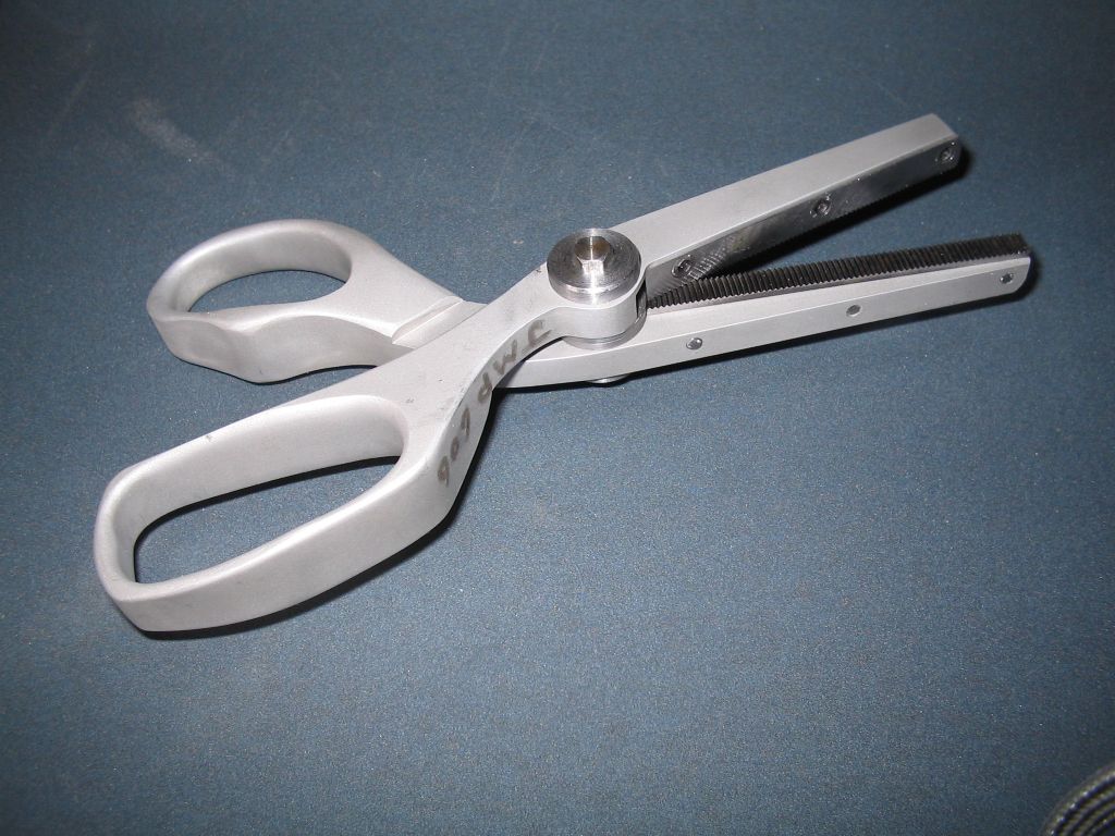

                          A little off topic with this part but for those of you who may have read the original article an opportunity to see the end result.
                          In the original article the subject matter was the production of a pair of
                          shears to make some dummy cover tapes for a model aircraft.
                          I am pleased to show here the model that was featured in the article
                          now completed with the owner David Knott in the centre of the
                          photo.He is the current British national scale model champion with
                          this model at last years national championship.

                            #409530
                            John P
                              @johnp77052
                              Hi Andrew
                              Should have said pinking shears ,here they are ,one of the first
                              cnc type jobs that was done back in 2006 .The blades are
                              gauge plate hardened and only sharpened on the face ,there is
                              no clearance behind the cutting edge but they worked well enough
                              to cut the required tapes from paper.
                              The model Hurricane i think was started somewhere around 2004,
                              when i wrote the article in 2009 all of the main structure was completed.
                              The model was only finished last year such is the level of detail
                              of models of this type ,it has full cockpit detail and many other
                              features that would only be seen on the real thing.
                              David Knott the builder of the model has been British champion
                              many times and has been in the GB team several times representing this
                              country, maybe with this model he will win the world championship ,hope so.
