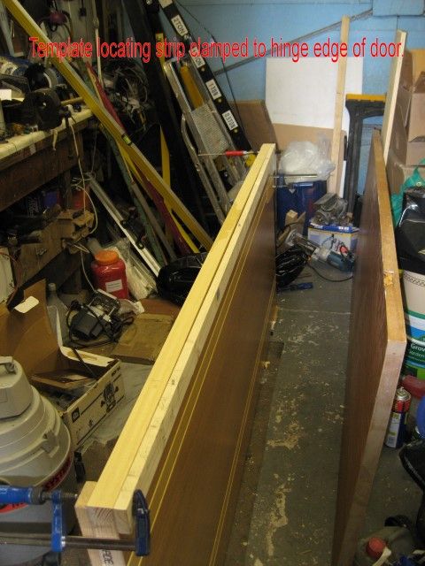

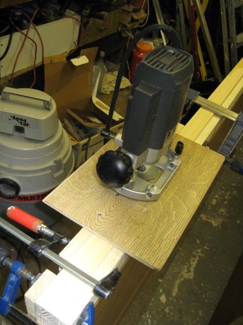

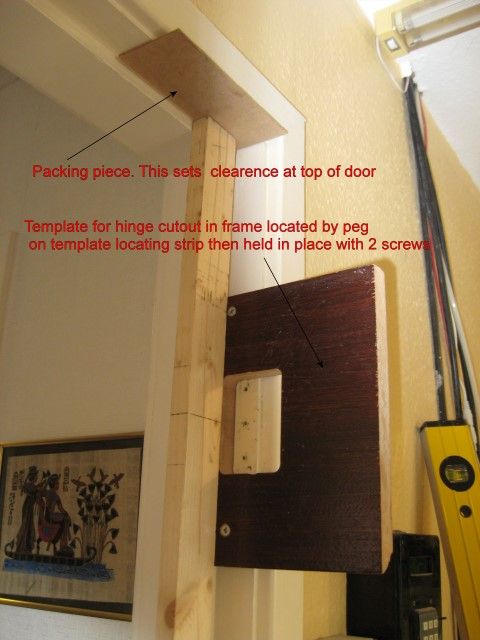

                                          #182444
                                          Les Jones 1
                                            @lesjones1
                                            Hi Wallace,

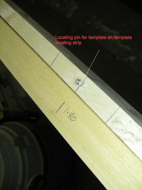

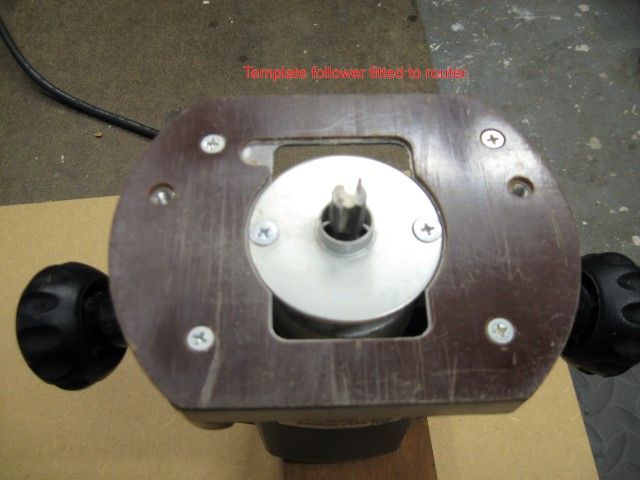

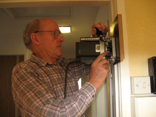

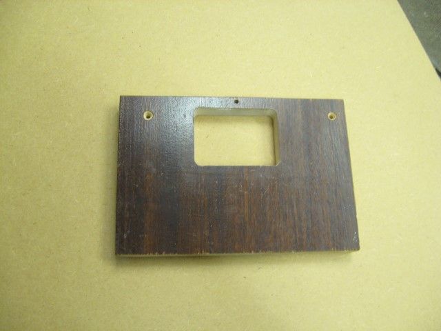

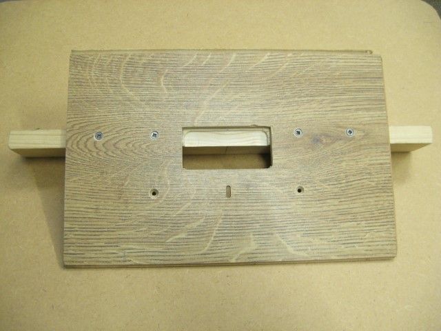

                                            These are the simple jigs I made when replacing the internal doors a few months ago.
                                            I think this is what Jason was suggesting.
                                            Note the reference end of the locating strip lines up with the top of the door.
                                            I did cheat by using the milling machine to make the jigs.
                                            Les.

                                              Hi All, Excuse me, but that seems like a ridiculously complex way to cut the hinges into a door frame. this is the method I use, and which is always used by all the pro joiners I have ever seen fit a door,
                                              Fold hinge to 90 deg and place on edge of door, pencil round and mark thickness of hinge on face of door, Chisel out and fit hinge to door, repeat for number of hinges till all are cut. Offer door up to frame, pack up with hardboard/cardboard to obtain correct clearance at top of door, mark hinges on to door frame, mark thickness of hinge on frame and chisel out.
                                              Fit Door.
                                              Twenty minutes tops and I am an Electrical engineer, A real joiner does it in less than half that time

                                                Really depends on the job. For a single door then marking out and handheld router or chisel is easiest.
                                                Now if you are on a price to 2nd fix a whole house or flat then you use jigs like above and can knock out all the hinge mortices in t taime it would take to just mark them all out using traditional methods. The site chippy who is on this sort of work will have invested in a purpose made adjustable jig which is even quicker than home made ones.
                                                A corner chisel also speeds things up unless you are also using hinges with rounded corners that are specifically designed for fitting into routed mortices which makes it quicker still
