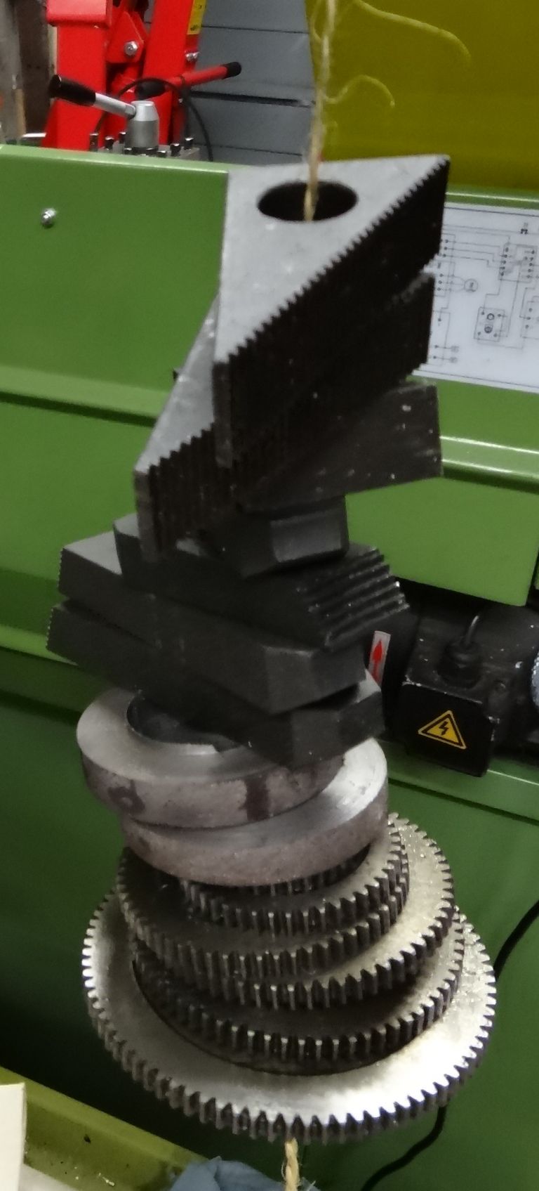

          Posted by SillyOldDuffer on 06/08/2019 16:23:05:
          For sizing the motor, here's what it look to overcome stiction and lift my WM18's head:
          A weight of 6.5kg suspended from the manual winding handle was necessary to get movement. The handle is 55mm from the axle. 6.5kg is approximately 64N.
          T = 0.055m x 64N = 3.52Nm
          The handle turns the screw via 1:1 gearing.
          Th e measurement confirms the 1.9Nm motor recommended by Chris is too small and a 3 to 4Nm motor as recommended by Joe is in the right ball-park. Not sure how typical my WM18 is: certainly raising the head is hard work! Given my figures a 4Nm motor would be needed for my WM18.
          As my maths is awful, grateful for corrections…

                Posted by petro1head on 06/08/2019 16:51:16:
                Thanks for that. Does your WM18 have the gas strut
                No such luxuries on my machine. If a strut were fitted, I'm sure less weight would be needed to move the head!
                There's distinct stiction on my Z-movement and once the head is moving it needs noticeably less torque to keep going. Trouble is the motor has to be big enough to get the head moving from a dead stop.

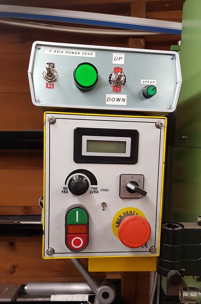

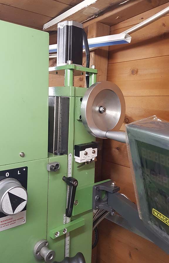

                      #423523
                      petro1head
                        @petro1head
                        I have completed my project. Thanks for the great input guys
                        PS Could a MOD edit the title to add: Finished Project please
                        Edited By petro1head on 10/08/2019 20:10:30

                          #423532
                          petro1head
                            @petro1head
                            Posted by not done it yet on 10/08/2019 20:27:21:
                            Will it move slowly enough to power feed while cutting?
                            Yes

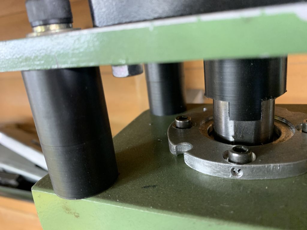

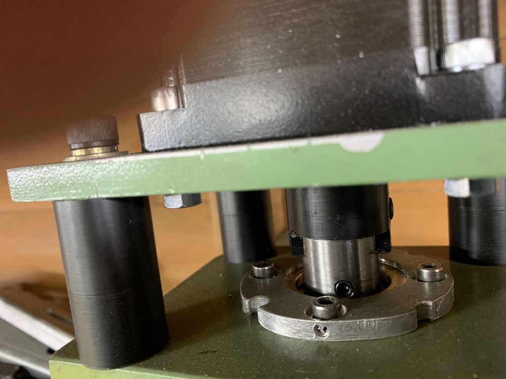

                                #659683
                                Stuart Smith 5
                                  @stuartsmith5
                                  I am going to make one for my WM16. It has the 2 thin nuts at the top of the shaft. How did you couple your stepper to the shaft? I am thinking of removing the top nut and making a coupling with the same internal thread.
                                  Stuart
                                  #659686
                                  Oven Man
                                    @ovenman
                                    Posted by Stuart Smith 5 on 09/09/2023 16:15:47:
                                    Stuart
                                    I have a Chester Champion 20V that is similar to the WM16 and that is exactly what I did. I I remember correctly it is an M16 x 1.5mm pitch thread. There's not a huge amount of thread even with the nut removed but it appears to be sufficient, mine has worked perfectly for the last few years.
                                    Peter
                                    #659688
                                    petro1head
                                      @petro1head
                                      Stuart
                                      I remove the thin nuts and made a new one with a slot. Grub screws to secure
                                      #659711
