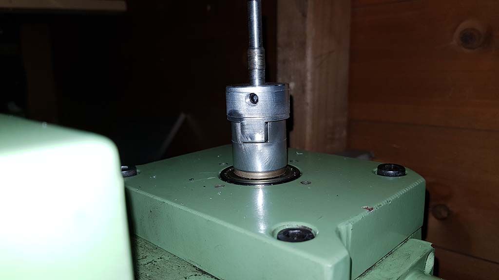

        Looking at the top of the mill the lead screw comes through a bearing with a threaded portion and two thin nuts that lock together.
        What would be the best way to attach the motor motor?
        it i use some sort of clutch does anyone have a simple setup/drawing

          So I think I am nearly there.
          This is how I am going to connect the stepper motor to the mill
          I am going to buy this stepper motor, as reccomended by Chris, thanks – Link

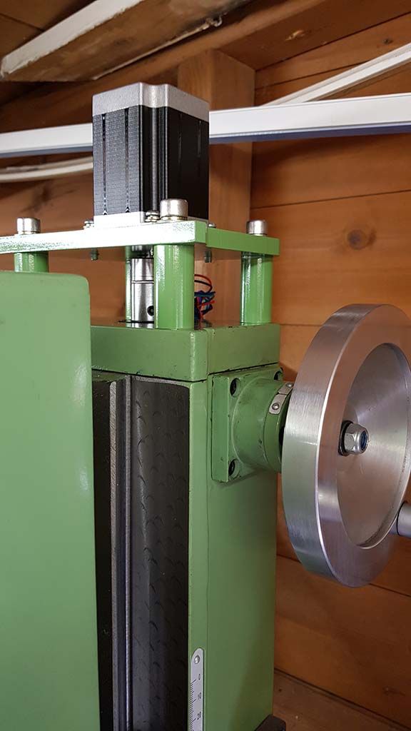

                    Work has started, got the mount, connection and motor installed
                    Just waiting for delivery of the PWM and project boxes then I can start the wiring.
                    Next task while waiting id to fit the limit switched.
                    Re the wiring would it be worth covering the wire metal conduit  What size and where from? Or I could use this stuff Link
                    The motor only put a small amount of resistance on the handle so happy
                    Edited By petro1head on 04/08/2019 13:27:29

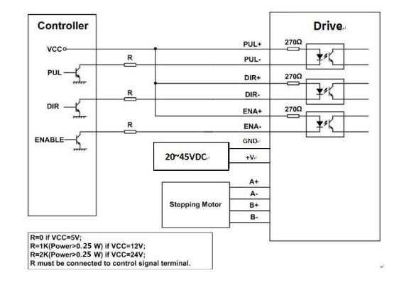

                              Bit late to enter the fray, but…I do think a NEMA34 size would have been better, or at least a motor with maybe around 3 to 4NM torque. The problem is really overcoming the stiction in the system and will be worse on the up..
                              If you are willing to try a few things –
                              Does the motor turn on its own, disconnected from the leadscrew?
                              If so, loosen up the Z Gibs completely and try again, just to see if things move.
                              If not, let me know and we take it from there.
                              Do you have an oscilloscope?
                              Can you post a wiring diagram of how you connected the bits?
                              Joe
                                  Joe
                                  I am starting to feel the 3nm motor may have been better Link
                                  Before fitting I bench tested the motor and it was turning fine.
                                  When I first fitted it the dip switches were set to 1 amp, when I set it to the required amperage, 2.8, it stated working on the mill.
                                  I don't have an occiliscpoe
                                  Wiring diagram:
                                  #422881

                                              Oh no! Looking at your photo showing the stepper on the column and noticed it's a fair bit short compared to the one I have. Checked mine and it's a 3NM NEMA 23…I need to go hide for a while – I'm really sorry!
                                              Down in the workshop, I took a spring scale and measured the force required to move the handwheels on the Z and X axes. The Z axis requires 1.8kg force to break away and around 1.6kg force to rotate the wheel. The X axis on the other hand requires 0.8kg force to break away and around 0.6kg force to rotate the wheel.
                                              With a wheel radius of 5.5cm this gives a torque of 1Nm for the Z axis and 0.45Nm for the X axis. So in theory the 1.9Nm motor should work – but that's just the theory!
                                              #422893

                                                    For sizing the motor, here's what it look to overcome stiction and lift my WM18's head:
                                                    A weight of 6.5kg suspended from the manual winding handle was necessary to get movement. The handle is 55mm from the axle. 6.5kg is approximately 64N.
                                                    T = 0.055m x 64N = 3.52Nm
                                                    The handle turns the screw via 1:1 gearing.
                                                    Th e measurement confirms the 1.9Nm motor recommended by Chris is too small and a 3 to 4Nm motor as recommended by Joe is in the right ball-park. Not sure how typical my WM18 is: certainly raising the head is hard work!  Given my figures a 4Nm motor would be needed for my WM18.
                                                    As my maths is awful, grateful for corrections…
