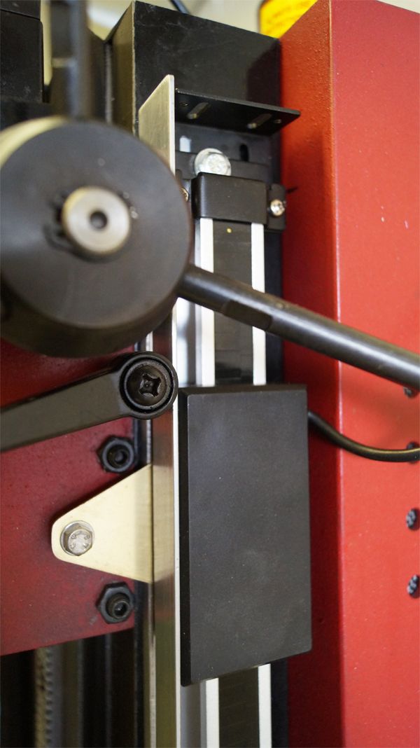

                      Another +1 for the ARC DRO, s
                      I fitted them to the 3 axis on the SX2P they have been 100% reliable and accurate or at least as accurate to what I will ever need.
                      Protecting them against swarf and coolant is easy on the X and Y, I fitted a length of 25 x 25 x 1.5mm alu angle along the top to act as a swarf guard. The Z is not quite as easy but I used the same method and slotted the angle for the reader bracket to fit through and its worked well, picture below.

                          Thanks Ron, I like the trick with the angle too, I have a bit of it that I brought for a job that ended up as surplus to requirements and has been resting in the workshop for a while, now I’m glad I didn’t smelt down!
