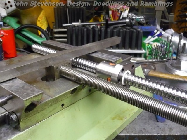

                                I have converted about 5 or 6 of the WM series to CNC, some WM14's, some WM16's
                                There are a couple of problems with these. Main one is mostly you need access to another milling machine to clear under the table to allow room for the ball screw, it is tight.
                                As regards noise, they are noisy, I replace the primary gear drive with timing belt which helped but the main gearbox is still noisy.
                                For operation in a flat I'd go for the SX2 if you wanted to keep to sub 1K

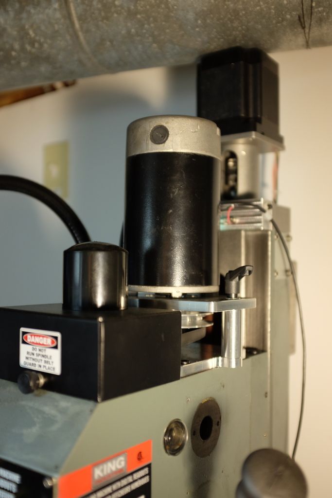

                                  I did not like wearing hearing protectors when using my "King Canada KC20-VS" so I ordered a belt drive from benchtopprecision.com and (when it eventually arrived) made an incredible difference.
                                  It has two speeds, and alters the speed range "up" slightly. It was very well made, but took a while to arrive. Installation was easy – the only issue I had was that the guard cover screw needed to have a spacer turned up to move it "out' slightly – 20 seconds on the lathe with a bit of brass rod.
                                  I'm not sure I'm really happy with the mill itself, but time will tell whether it's a keeper or not. I'm not sure if it was my cutting the slot underneath for ball screw clearance, but my table ended up being warped, and when doing a cleaning cut over the top, discovered a hard spot on it. I should disassemble again and check how it's doing, but… (here's one pic, another one in my "misc" album. Not great shots, but you'll get the idea)

                                    #248072
                                    Another JohnS
                                      @anotherjohns
                                      Posted by Bandersnatch on 25/07/2016 16:42:57:
                                      You just snuck in under the vent there eh?
                                      Good eyes. Yes – would rather have purchased a Tormach PCNC 770 with stand, but did not have the vertical height. Most of my workshop ceiling consists of duct work, and I have maybe 1 square metre where it is higher.
                                      I mention this only because it is easy to look down measure the footprint of possible new equipment (yes, this will fit through the door and sit HERE) but one must look at the height above, too! This is easily overlooked.
                                      I was able to assemble this mill shown elsewhere in my workshop, move it close to its final position, then put the Z stepper in place, then roll it back against the wall.
                                      John.
