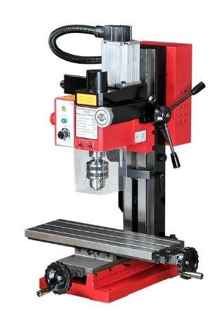

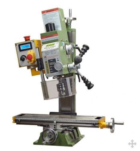

          The Warco (Weiss style)and the Amadeal/LMS (SIEG Style) machines are not the same

                                  It was more the “style” I was commenting on than the actual factory which may not be either.
                                  Your XJ12 , LMS 4962 and the X2 have a similar rack and pinion type rise and fall to the head and the fine feed is stuck on the side.
                                  xj12

                                  But the Warco possibly from Weiss has a leadscrew with handle at the top and the fine feed within the head
                                  wm14
                                  This would make it very unlikely that the kit you or LMS sell for your machines will fit the WM14
