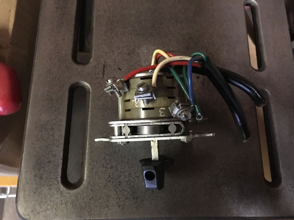

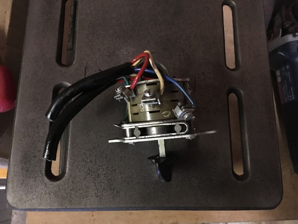

              That said on removing the original switch from within the body (aide from being slight gummed up with grease…and so I took it apart and cleaned) it appears to be functional, but the old cables coming into it have four wires, red, blue and white with the green linked to the drill case?
              I wanted to to give it a try with the motor and see if ts any good and why it had been replaced by an external switch but the external switch only has the standard three cables coming in/out – not the white.
              The original switch has 240v 16a written on it so I assume it should be suitible for single phase? I did read somewhere that the switches used for three phase machines (motors) could be used for 240v. Thats Said Im a little stumped by the extra wire.
              It would be nice to get the original switch going again.

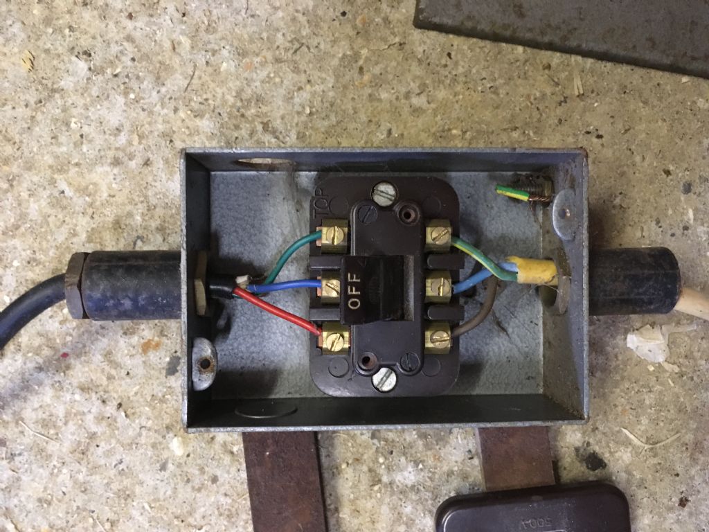

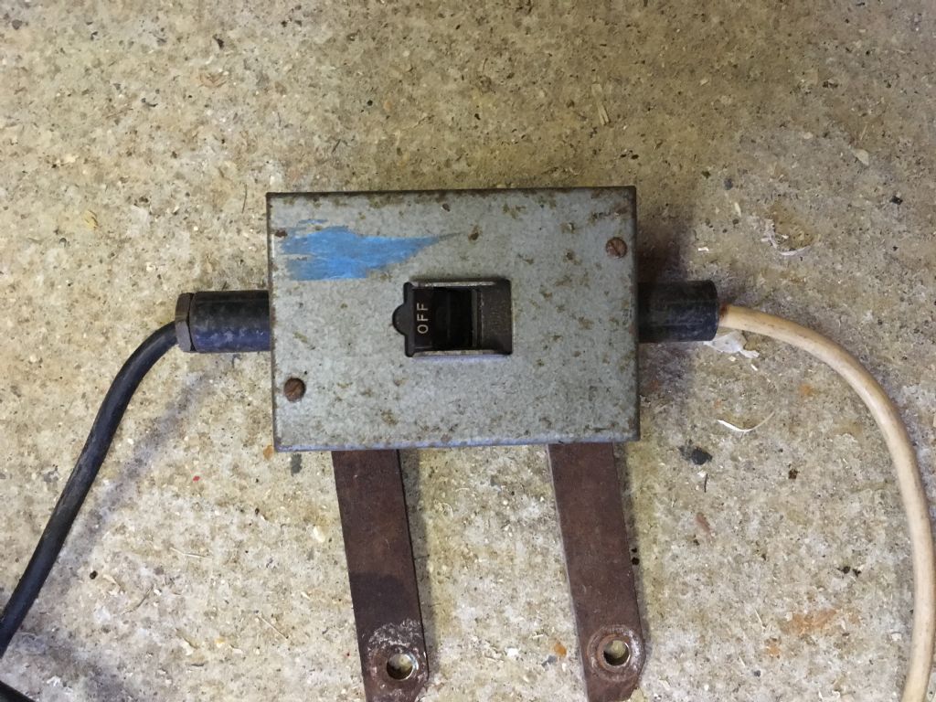

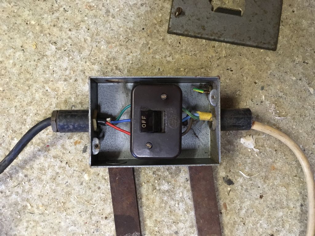

                    I thought some pics would help:
                    Original switch
                    Replacement switch (which I was going to replace with a NVR switch
                    Could the original switch be used, despite only having three wires now?

                        Both of your switches pictured above (old and replacement) are designed for 3 phase use so disregard the colours used.
                        Is ok to just use 2 of the connections for live and neutral but you Must have a permanent continuity for the earth from the plug to the machine body and any load connected ( motor ,light etc). I.e. Don't switch the earth connection
                        #274806

                          With the original switch (you might be able to make this out in the picture) the ear terminals are joined into a a single wire ring terminal which is bolted to the machine body with the the bolts that hold the switch in.
                          I could easily replicate this with the earth wires if I were to wire in the old switch. Can you just leave out the white wire.
                          Or more fundamentally, should I give up on the old switch and go back to the original idea of fitting the NVR switch? Is this advisible from a safety perspective?

                              You would be better off using the NVR switch for safety reasons. I suspect that the original rotary switch was replaced by the other 3 pole switch because it was faulty. If it is a 3 position switch (Forward off reverse) then it may have been replaced to prevent it being used in reverse. If at least 2 of the 3 contact sets test OK (Resistance less than an ohm when the switch is on and greater than 20 Meg ohms when in the off position) then it could be used.
                              Edit. I should have also said that the insulation resistance between the contact sets should be at least 20 Meg ohms.
