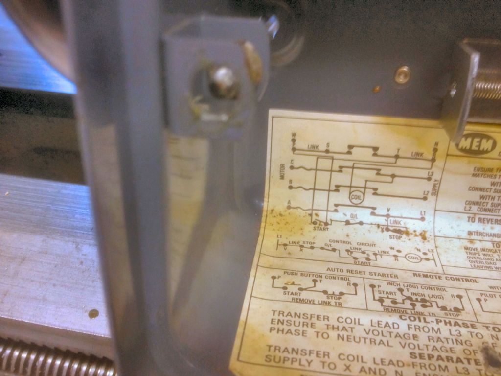

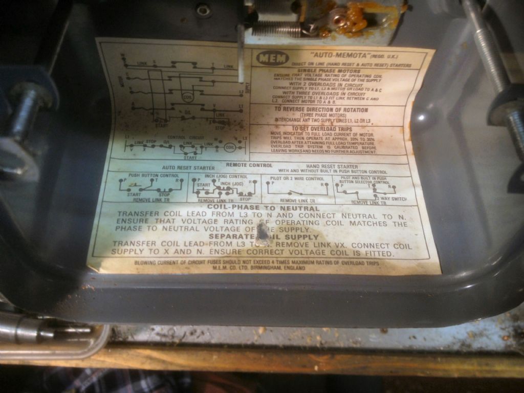

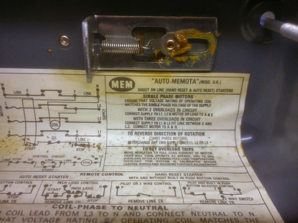

                                                When in the workshop today I took the opportunity to remove the cover from my MEM starter and inside of the lid was what I was hoping to find instructions relating to the use of the starter on a 240v supply/load ! There as been a lot written on how the starter should be wired when on 240V so here's what MEM say should be done, sorry about the pic's quality.
                                                Cheers H

                                                  Presumably it has a 240v coil and not a 415v type
                                                  #143192
                                                  Harry Wilkes
                                                    @harrywilkes58467
                                                    Yes Geoff
                                                    H
                                                    #143201
