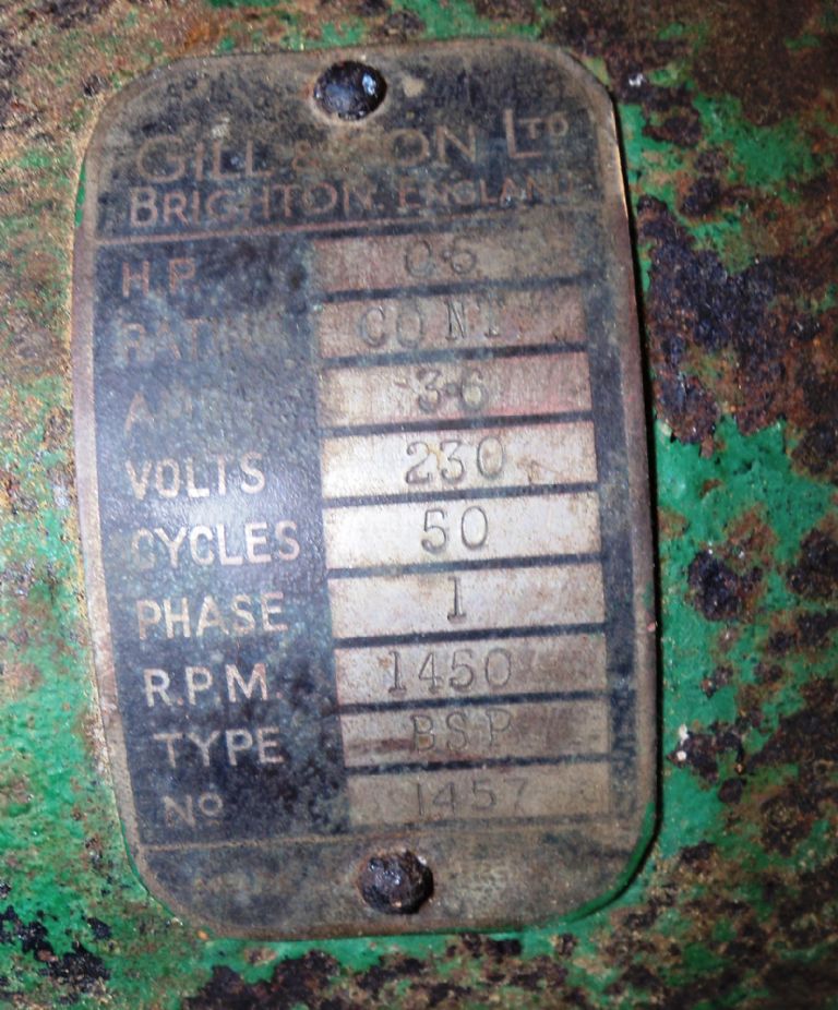

        I'm replacing my 3 phase motor with a single phase (looked at getting 3 phase but way too expensive, 3 phase motor is not the correct type to run single phase).
        I have a single phase motor (0.6 hp, type BSP) which only has two terminals.

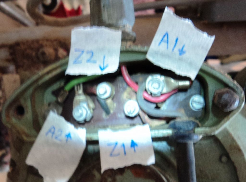

          I'm wondering if it would be best to use a different (single phase) motor.

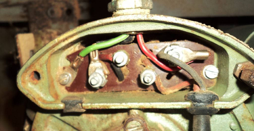

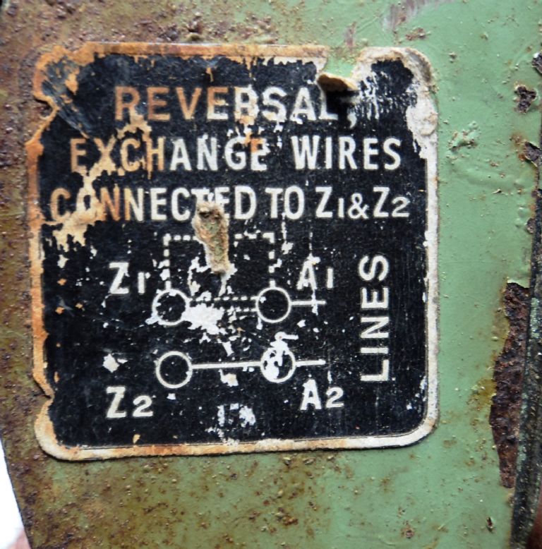

          I have a Gryphon on my bench saw which is 3/4 h.p. and has 4 terminals (A1, A2, Z1, Z2)
          It's capcitor start, but still not sure how to wire it as at present live and neutral (form power source) only go to 2 terminals

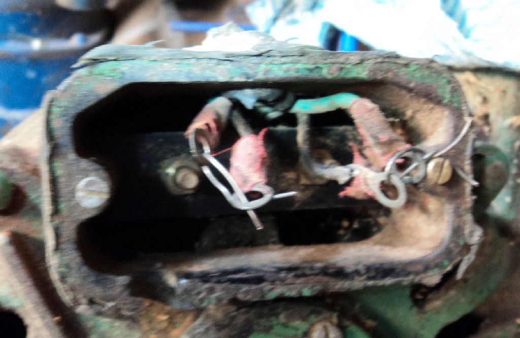

            It will probably be possible to use a reversing switch with either of the motors. On the 0.6 HP motor two of the wires are probably the main winding and two the auxiliary winding. (Possibly via a centrifugal switch and start capacitor.) You would need to do some tests with a multimeter to work out which wires are the main winding. Does this motor have a start capacitor ? You would need to add a connector block so that the four wires (Plus the earth wire.) could be brought out to the reversing switch.
            on the 0.75 HP motor you would need to take a photograph of the connection box on the motor so that the labels on the terminals could be read. (Or add labels to the picture.) I am assuming this is a capacitor start motor and the cable from the bottom right hand side of the connector box goes to the capacitor.

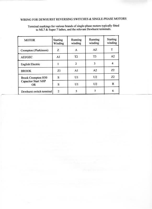

              It will be easier to use the Gryphon with the 4 terminals.
              This diagram may then help.

                The Gryphon motor is 1.25 hp which seems a little grunty for an ML7, it 's also 2850 rpm which may (?) cause issues (not sure about this.
                The other motor (Gill & Son) is 1,450rpm which is what my 3 phase one was. I don't think it's capacitor start (no visible capcitor).

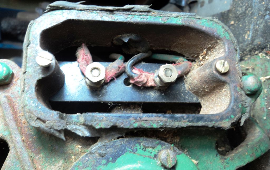

                I've undone the wires on the Gill motor and it looks like there is (just) enough length to attach them to a connector block.
                I have a multi meter, but am not sure how to test which are main winding & which are auxiliary. At present, one black and one green attach to each of the terminals (there are 2 green wires & 2 black).
                On the Gryphon motor the capcitor wires (bottom right of photo) attach Black to A1, and Red to Z1. The power input wires attach Red to A1, and Black to A2.

                  I agree that the 1400 rpm motor is more suitable. The green wires will probably be one winding and the black the other winding. I would expect the resistance of the main winding will be between 5 and 10 ohms and the start winding between 10 and 20 ohms. (For connecting it up to the reversing switch it does not matter which is which.)
                  On the Dewhurst switch connect live and neutral VIA AN NVR SWITCH to terminals 1 and 3 (It does matter which way round.)
                  Connect the main winding to terminals 5 and 7
                  Connect the start winding to terminals 2 and 6
                  If forward and reverse are the wrong way round then swap over the wires on either terminals 5 and 7 OR 2 and 6 (BUT NOT BOTH)

                    the resistance of the black wires is around 3.8 ohms.
                    the green wires don't appear to form a circuit(?) as resistance doesn't read.
                    I'll have a better look in the morning
                    #201862
                    Les Jones 1
                      @lesjones1
                      Hi Grotto,
                      The black wires will be the main winding. The start winding is probably in series with the centrifugal switch (Which should be closed when the motor is stopped.) If the motor had a start capacitor that would also be in series with the start winding. So if there is a start capacitor you would not get a resistance reading between the green wires as a capacitor does not pass DC. If you are sure that the motor does not have a start capacitor then the centrifugal switch is faulty. (Or the start winding open circuit but this is unlikely.) You will need to dismantle the motor to get to the centrifugal switch to confirm that is the fault and if so repair it.
