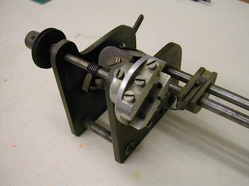

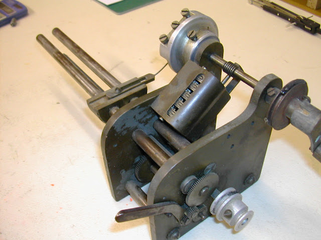

                    Many years ago, I have no idea of the exact period, probably in the fifties and well before any involvement I had with ME there was I believe, a back and forth discussion in ME between (I think) Edgar Westbury and one Ernie Shaw.
                    Apparently Ernie had stated that he thought it was possible to wind small ‘scale’ electric motors that were small enough to fit to the frames of a model tram that would be powerful enough to drive it. I believe ETW disagreed.
                    The relevance this has to Aylingsteamers request is that I worked with Ernie’s son for several years and when Ernie died he passed on to me some of his fathers ME items. One of these was the coil winder he had used for the task above which incidentally  I was told proved successful.  This winder is hand powered, has a forward and reverse tumbler gear on the travelling wire guide and works very freely. The drive belt needs replacing but other than that there is little to do to make it work given the gearing is correct for your needs.The leadscrew is 40tpi. The drive ratio can be easily changed by making new drive pulleys and as you can see there is a mechanical counter fitted (Doesn’t appear to have a zeroing facility though)
                    I have never used it and certainly don’t want to part with it permanently however I’m sure that Ernie and his son Martin would like to think of it being put to good use in the manner it was intended for.
                    Assuming you are in the UK and you can guarantee that you will eventually ensure it’s safe return I would be only too happy to forward it on for you to use if it is suitable for your purpose.
