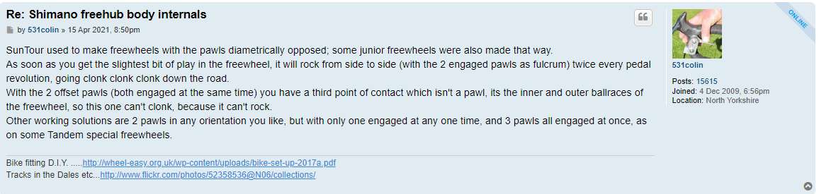

      Here is a freewheel hub off a standard bicycle, there is nothing missing here, there is only two pawls and the empty recess does not take a pawl.
      My question is, why are they not opposite each other?  I guess there is a mechanical reason but I don’t quite understand it (at a guess I’m thinking the offset allows them both to engage better, but far from sure)

            My guess would be that it’s clever enough to result in nine or ten clicks per revolution.
            Edit to add:-
            No, the pawls must be on the outside teeth, which would be many more clicks per revolution, but still arranged to give twice as many clicks as teeth. The shiny areas on the face are, presumably friction surfaces???

              If it is symmetric wear or damage might push it sideways and lock it, maybe, just a guess. Or with two play in the bearings may ensure that both pawls take equal stress but a third one may never actually make contact so proved pointless. The design for 3 would have been tested and then someone got a bonus for saving making ten million pawls a year.

                  Only the designer knows for sure. They can have 2 to 8 pawls. Some explanation here:
                  https://www.bikeradar.com/advice/buyers-guides/freehubs/
                  and
                  https://www.sheldonbrown.com/freewheels.html
                  Of relevance “This particular freewheel has two pawls directly opposite one another and an odd number of ratchet teeth, 15, so only one pawl engages at a time.

                    Is it your own freewheel, or did you find the photo on the net somewhere?
                    A remarkably similar image is on This Cycling Forum, where a possible answer is provided just below by Colin

                        Is the third pawl missing?
                        There seems to be a space for one

                          Certainly looks like there should be a third latch
                          Could there be any advantage in an unbalanced system?
                          edit. aha, it’s a cheap/sneaky way of stopping clunking in worn setups
