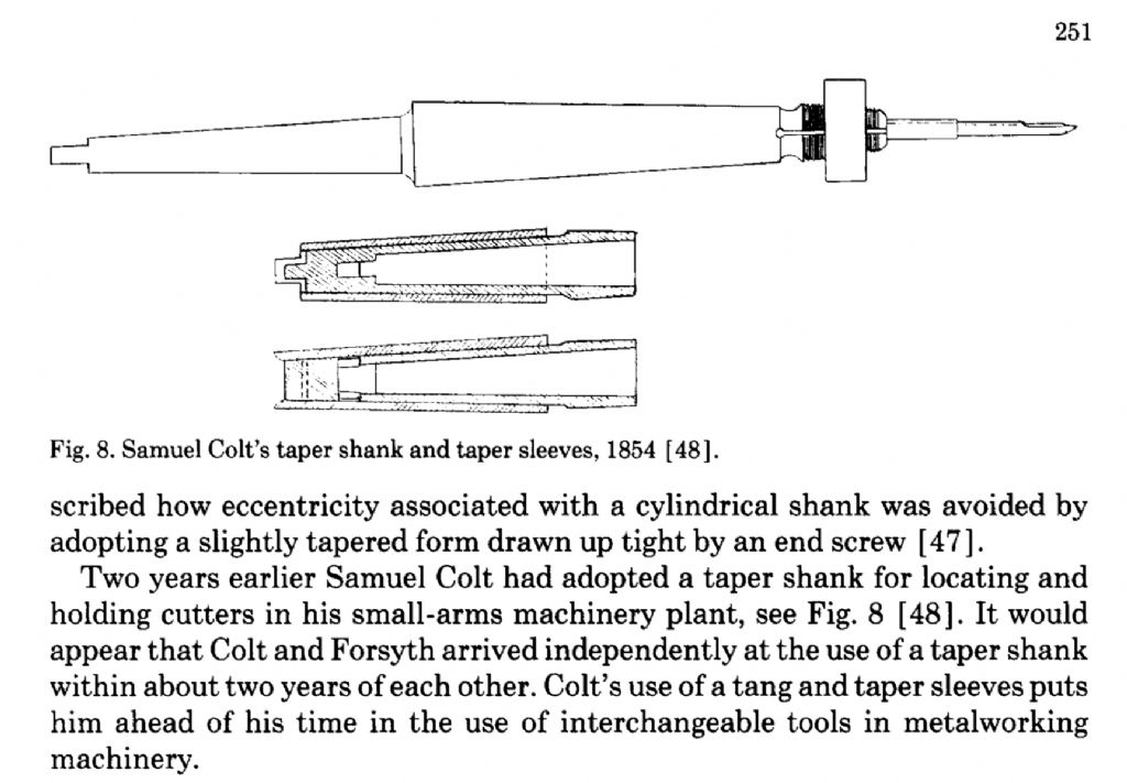

              I’m not really all that interested, but it looks like a search naming Samuel Colt might be more fruitful.
              Edit: But I have just found this reference:
              [48] S. Colt, British Patent No. 861, 1854.
              Edited By Michael Gilligan on 16/09/2020 16:40:13

                  Duly noted, john yes
                  The best I can offer is this [which may, or may not, be copied from the patent]:
                  Note: I sincerely hope that this small extract counts as ‘fair quotation’ from the source document.
                  Ref. https://www.sciencedirect.com/science/article/pii/0378380489900752
                  Edited By Michael Gilligan on 16/09/2020 17:13:46

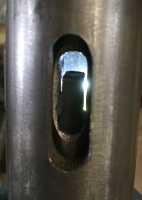

                    To amplify the suggestion of an extended plain diameter; Some of my MT shanks, with tappings have pieces of 3/8 BSW studding inserted so that they will, be ejected from the Tailstock on the lathe.
                    A taper drift is effective in breaking the taper in the Mill.
                    The main thing is that there is something there that can be subjected to forces to eject the Morse taper.

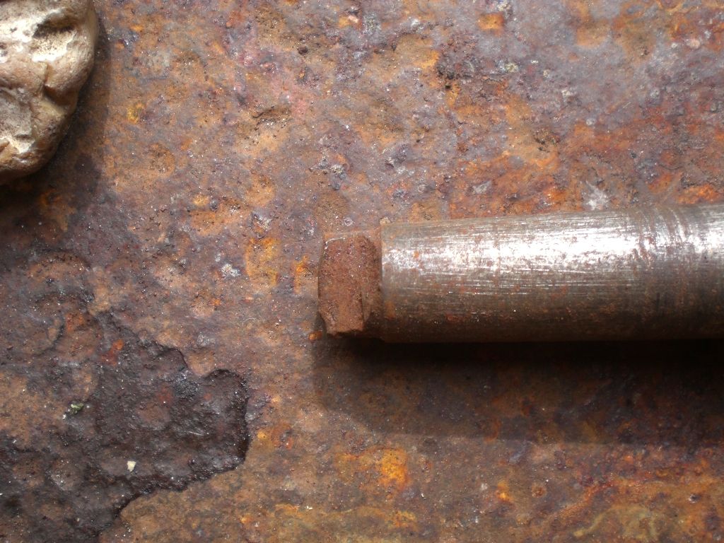

                            Hi, if the tang was designed to be driven or even partly driven, why is it not tough enough to resist twisting and wringing completely off? I don't believe it's there as a warning or any kind of safe guard, as by the time it's wrung off and the drill bit stops turning, it is already starting to do damage inside the quill and this will accumulate the more times it happens.
                            Tang#1
                            They are not particularly hard as you can use a file on them without any real trouble and who would design a drive dog with such a sloppy fit, as the chances are if it started to turn in the quill, you would get an impact load onto the two opposite corners of the tang and that to me is not good engineering design.
                            Tang#2
                            The drill makers tell you that the tang is for ejection purposes only, so why don't people believe them, and I'm sure manufacturers don't make their machines with abuse as a given thing to do by not keeping tools in good order and not discarding damaged ones.
                            Regards Nick.
