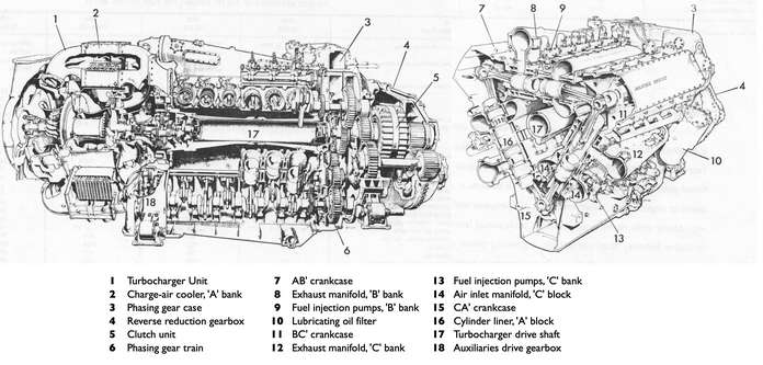

                                        duncan webster 1
                                          @duncanwebster1
                                          So have a look at
                                          Deltics in Retrospect – Part 1
                                          Scroll down near the bottom and there is a cutaway drawing of the engine. The blower is at the opposite end to the generator with 3 outlets connected to the ports on the sides of the cylinder blocks. This is the loco, not the boat. If you’ve got a working design in the boat you wouldn’t redesign it without good reason. I’ll go for the blower on the end of the auxiliary generator being for cooling the main generator

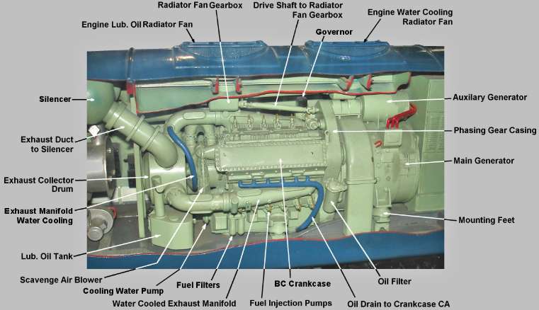

                                          Hopper
                                            @hopper
                                            Click HERE to download a PDF of the information sheet from “The Model Delta Locomotive at Riverside Musuem”, or Google that phrase. It shows the mechanically driven blower at one end of the engine and the mechanically driven auxiliary generator at the other on top of the main gen.
                                            The tech info with it is an interesting read. I read elsewhere the aux gen doubled as the exciter for the main gen as well as supplying 110 volts for lighting and controls etc. In answer to the original question, why not use the main gen to power these things, the main gen put out widely variable voltage DC depending on load and speed etc, so not suitable for running auxiliary plant such as pumps, compressors, lights, controls etc.
                                            There is even a steam boiler shoehorned in between the engines to supply heating to passenger carriages so it was all quite the arrangement and components did double duty wherever possible. The fan on the end of the aux gen appears to be used to cool the main gen through the trunking/ducting at the end .
                                            Starting on the loco Deltics, it says, was by running current from a bank of batteries through the main gen so it acted as a motor.

                                                    This is the diagram pinched from Duncan’s Railway Matters link:
                                                    delticlayout
                                                    Problem is, it labels the engine only, and doesn’t identify A and B in greensands’ photo.   I’m fairly sure the turbo-charger unit has been removed from the greensands engine.
                                                    This image is from hoppers link:
                                                    delticHopper
                                                    Now this is interesting because it shows, top right, an auxiliary generator mounted on top of the main generator, and – exactly as Hopper said, it’s driven by a drive shaft. (Connected to the ‘Radiator Fan Gearbox’.)  Makes sense to me, except it doesn’t match the greensands photo!  That there’s no sign of a drive shaft might be because greensands’ photo shows the engine with the input blower on the right, whilst all the others have the blower on the left;   the shaft could be hidden behind, or possibly it was removed before the engine was put on the pallet!   But there’s no sign of the big blower mounted as in greensands’ photo.
                                                    Duncan’s article mentions there being about 90 variants of the Deltic.  The greensands photo doesn’t seem to match anything else we’ve found so far, and, because there are only a limited number of examples on the internet, it’s possible his example is unique.
                                                    At the moment, I like the idea that greensands’ photo shows a motor driven fan that helps cool the engine by drawing air over it, before blowing it out through a water filled radiator, also removed, with much else, from the greensands engine.   Could be wrong, and what I think is a motor, is an auxiliary generator.
