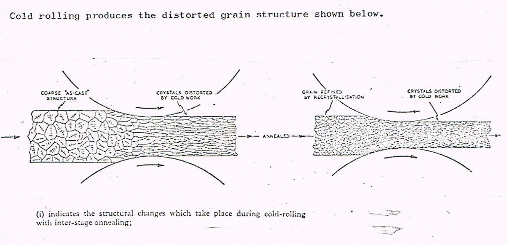

        Hi, cold rolling produces stress though-out the the metal that is rolled, not just at the surface of each side, although the stresses are greater on the surfaces of each side. The only true way to overcome the situation is by heat treatment.
        It can be seen on the graph above, that normalising is slightly hotter than annealing, and normalising will be a little stronger than annealing, but the temperature has a narrow window, so a controlled temperature environment would be needed.
