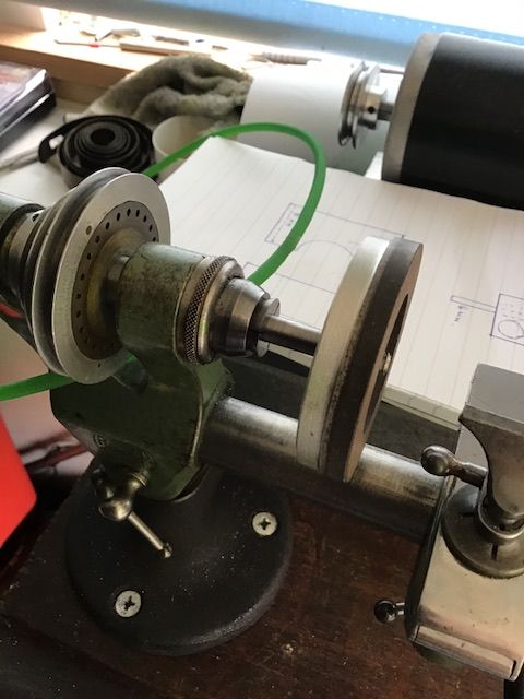

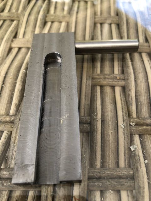

      I am in the process of making a copy of Levin’s diamond watchmaker graver sharpener ( see first picture), I started by making the arbor to mount the diamond wheel to my Pultra then moved onto the base that fits onto the mounting point where the tool rest goes.
      I started by milling the steel square ( or should that be oblong ), then cut a slot 4.8mm deep X 8.6mm wide then to cut the T slot I had to use a woodruff cutter because I couldn’t get a T slot cutter small enough, very slow going on my very small Warco WM12 , as I am going to nickel plate to guard against rust I needed to sand to remove tool marks but when I offered it up to the sander it only sanded the edges not the centre it’s not a problem with this part because it’s only the base but for future reference it would be nice to know if cutting the T slot was the cause.
      I haven’t been able to find anyone with the tool to be able to get measurements so I am having to do it best I can.

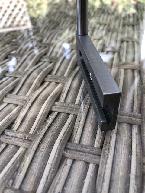

                                            As I said in the original post , I squared it off meaning I milled all four sides and both ends but it looks as though I didn’t milk enough off both sides to release the stresses.

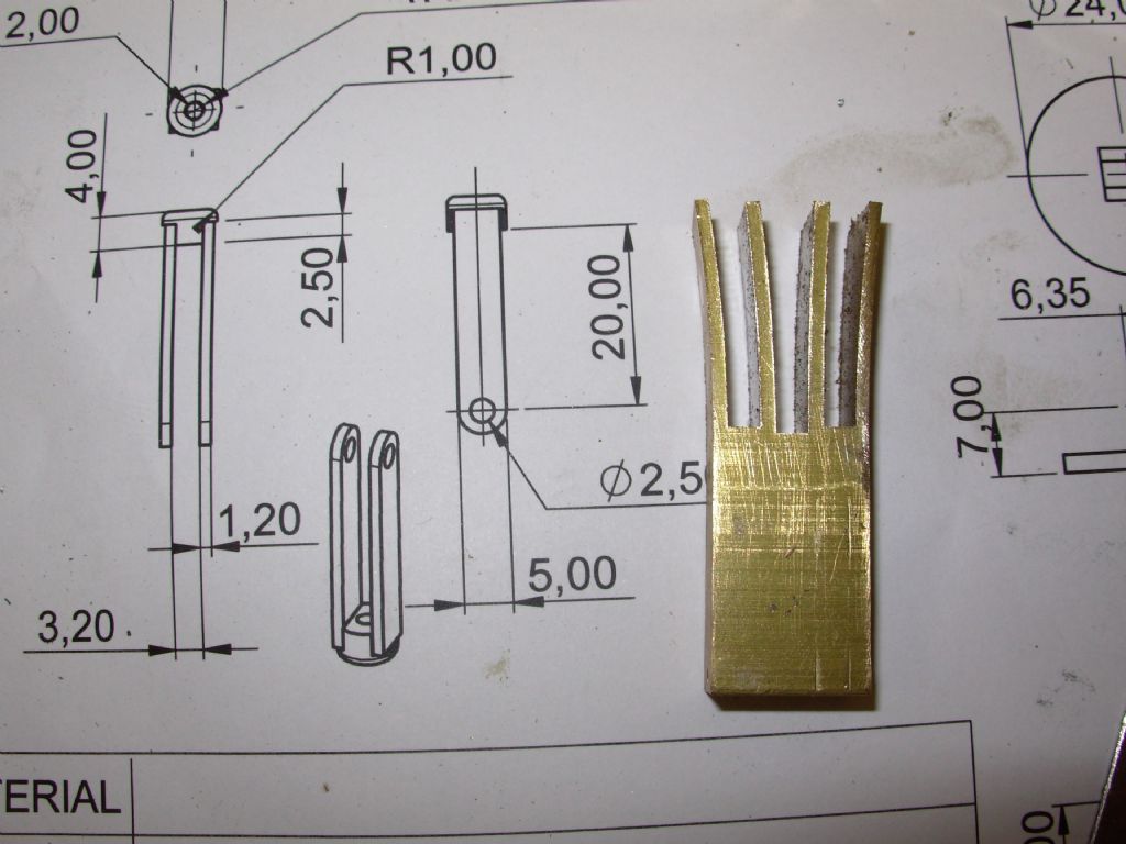

                                                It also happens with brass.
                                                Fortunately I was able to batter it straight again and use it, but it does illustrate the locked-in stresses at the surface of drawn material.

                                                  It wasn’t along its length it was is the side to side that dished ,as I say it’s not a problem with this part , I was just wondering for future reference when something more critical in size is needed, I have since measured and the slot I cut in first 8.6mm wide now measured 8.67, although it is less the further in towards the closed end but that would make sense as more material there. so not a great amount but if it was some critical part 0.07mm could make a difference between fit and not .

                                                      Dell's deep cut of the tee slot is what was the main cause and is something I would have expected to happen if done without allowing the stress to ease by lighter machining and releasing from the vise for those stresses to ease gradually.
