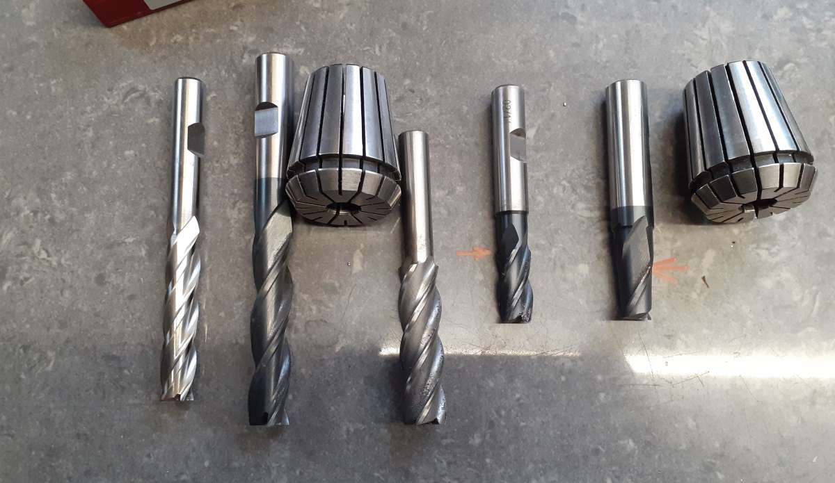

            #702147
              20231228_102719
              So here we have a cutter with a smaller shank in the middle, in this case a 1/2″ 4-flute on a 3/8″ shank.
              The two on the right are commercial “necked” cutters, a 2 and a 4-flute where the flute only extends to where I have drawn the arrows and the rest of the coated area above is approx 90% of cutter dia so the 10mm cutter reduces to 9mm but has a 10mm shank and still has plenty to hold.
              On the left are two long series cutters the main thing to noe here is that there is enough shank to completely fill a collet but when the reduced shank one is extended to a similar length you don’t have  alot to get hold of so starts to get a bit risky.
              If you really want to pull a cutter with a small shank and larger flute diameter out of the collet to extend the cut then use the proper ones that have extended shanks so you maintain full grip, I don’t have any but this is the type of thing.
              PS also check the spec before you order that mus have 14mm cutter as some have 16mm shanks and some have 14mm shanks not all are 12mm shank.

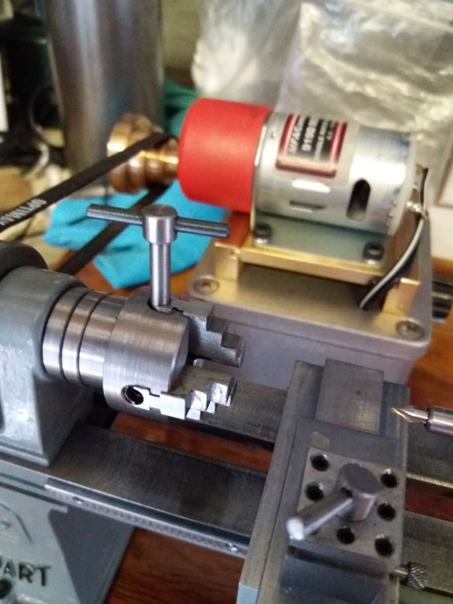

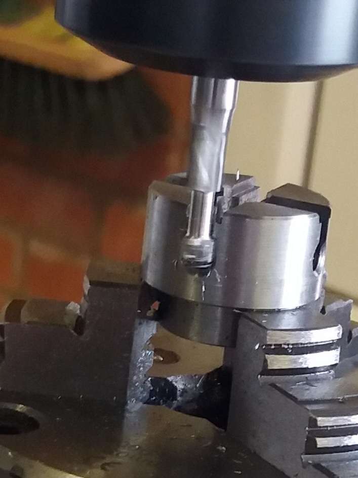

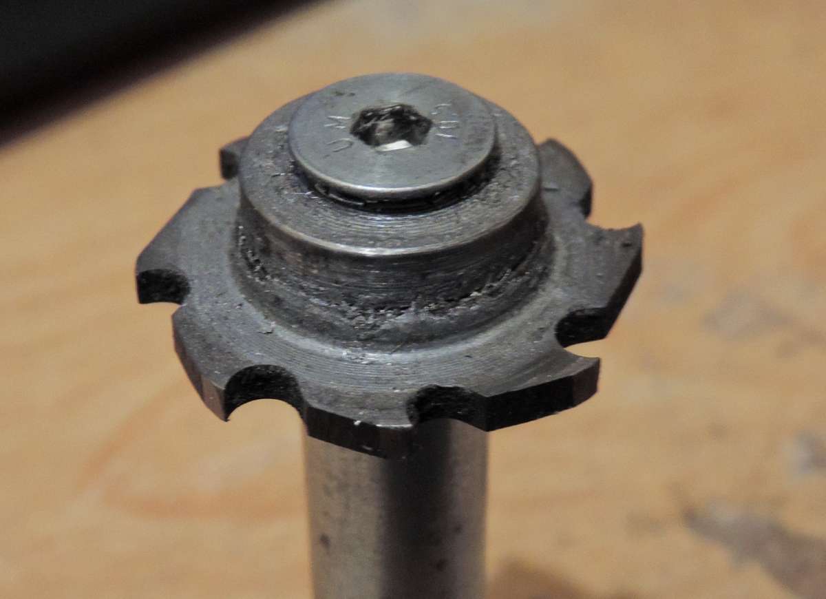

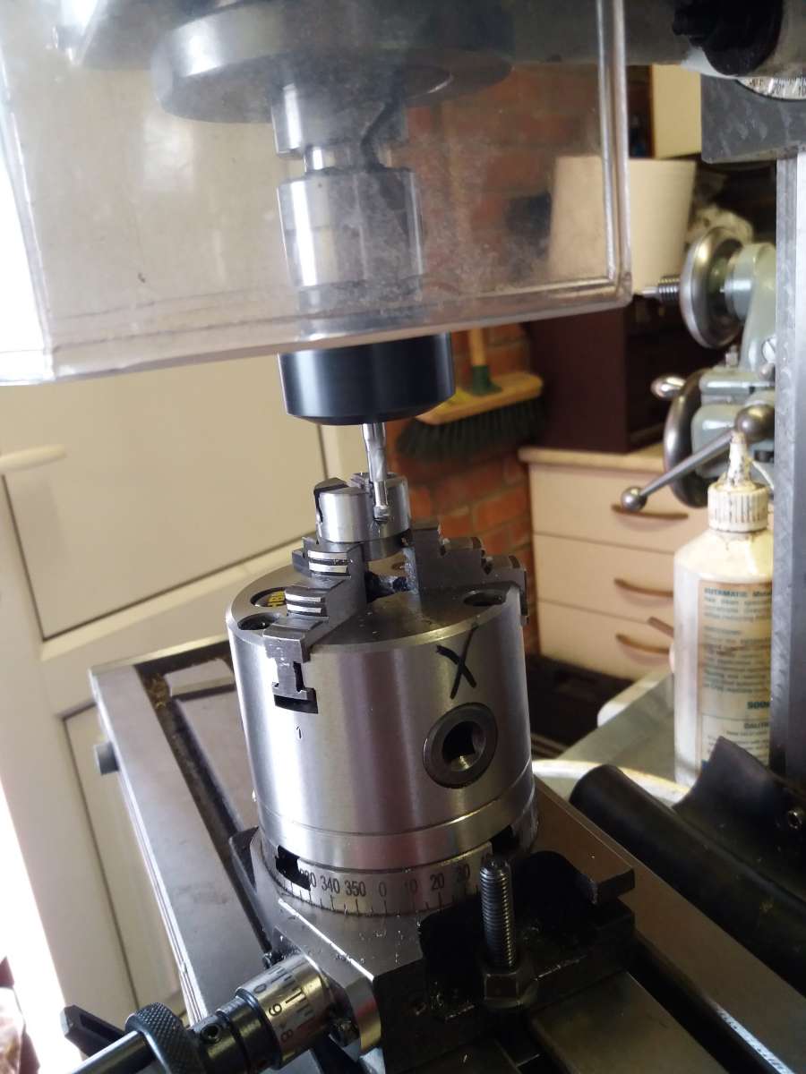

              David George 1
                @davidgeorge1
                A while ago now I decided to make a four jaw chuck for a Stuart lathe I was making and needed a 6mm diamiter woodruff cutter to cut the jaw slots and struggled to buy one so decided to make one. A friend has a cutter grinder which made the job possible and ground one to suit slot. The cutter was ground to the slot sizes with no clarance and the cutter head was finnished thickness so one cut through to finnished size which worked very well. I drilled a 6mm tapped hole through first and finnished the top of the slot to size first.
                David

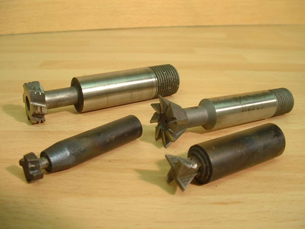

                #702645
                  I’ve made a such things from silver steel by turning and filing. They are far less elegant, not perfect, but work.
