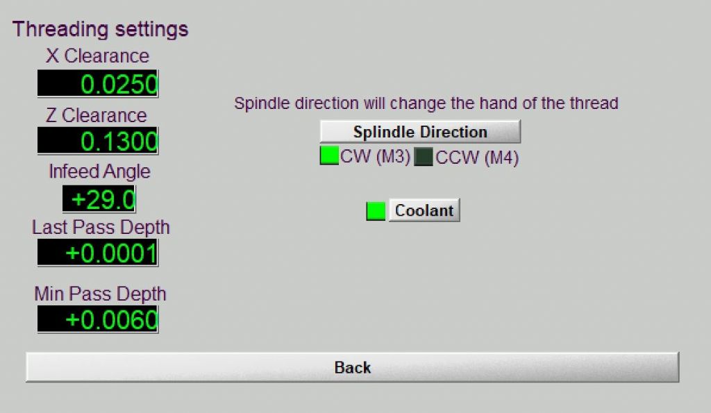

                                      Just to add to the confusion, for CNC threading on the lathe (at least in Mach3), the conventional threading direction is labelled "clockwise" – did you ever see a lathe chuck rotating clockwise when threading an ordinary thread? Apparently this is because the lathe CNC axes are derived from the mill by laying the mill over on its left hand side and the mill spindle of course rotates clockwise viewed from above by the operator.

                                        Not sure why that is confusing John, the controlled point that is the tip of the threading tool is rotating clockwise relative to the work.
                                                    regards Martin
                                                    Hmm. Well it got me puzzled the first time I threaded in M3 and I know others have been confused too from postings on M3 Support. One is used from milling to the CP being the centre of the rotating tool, the lathe is different. Part of the problem is that the M3 thread wizard isn't remarkably clear. This is "settings":
                                                    As a novice to Mach3, what "splindle" direction would you select for a RH thread? The correct answer is CW but for a lathe user that's reverse. Clearly the UI was designed by a software engineer.
