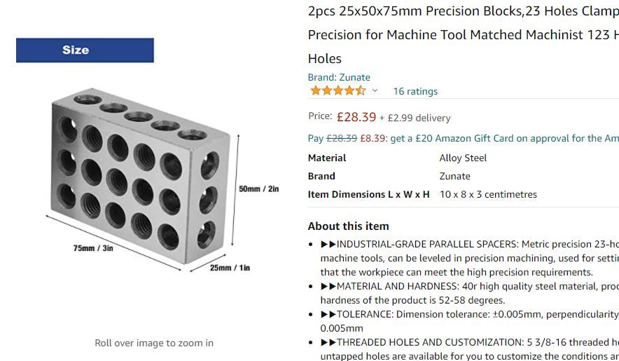

      If you search for 25 50 75 blocks you will find them with 3/8"x16 threaded holes, clearly 123 blocks that have been ground just a little bit more. So if you are making a single base part that is then finished to suit different markets a UNC thread would make sense as the USA would not want a Whitworth thread form.

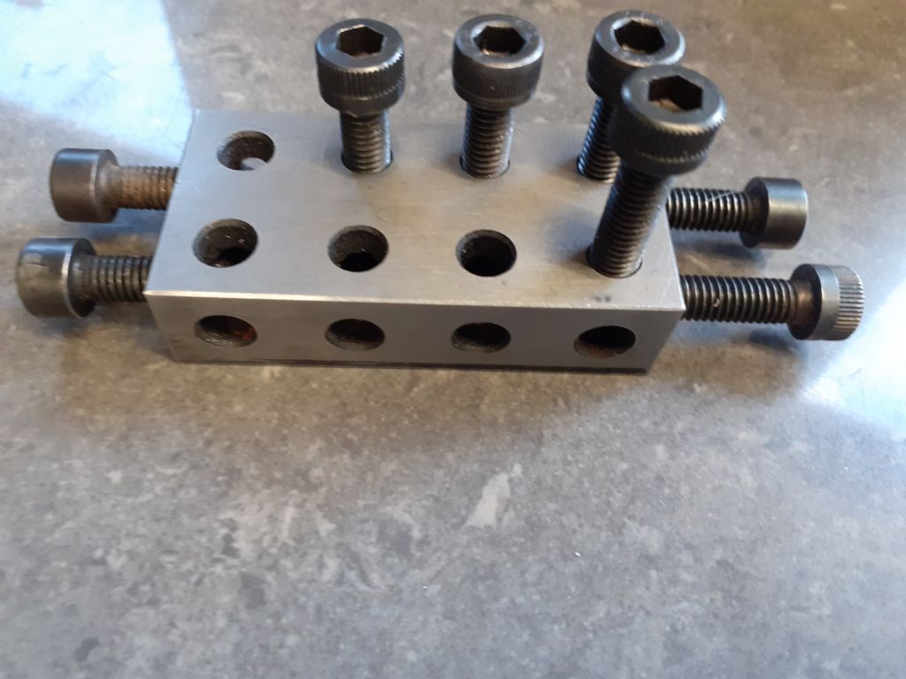

            The other thing to watch is a lot of 123 blocks are not drilled clearance size for whatever thread is used in the other holes so if you intend to bolt them together at some time get ones that have suitable clearance holes such as the metric ones from ARC. I don't screw them together often but it can be a useful feature some times.
            Also be very cautious about 25x50x75 blocks if searching the net, these for example could be one of 3 different sizes and good luck to your tap if you want to thread the "hardened" steel

              Hi, JasonB is correct, the unthreaded holes in my blocks are 5/16", but there are only 5 holes centrally placed as you would find the five dots on dice and they are only through the 1" thickness. You can of course use threaded rods or long bolts to hold two together, but you would have to use 1/4" or 6mm for alinement purposes and you would of course have bolt heads and nuts sticking out, but in my opinion 1-2-3 blocks don't really have much or little use bolted together, unlike the ones that Arc sell, as they were designed for bolting together.
              Regards Nick.

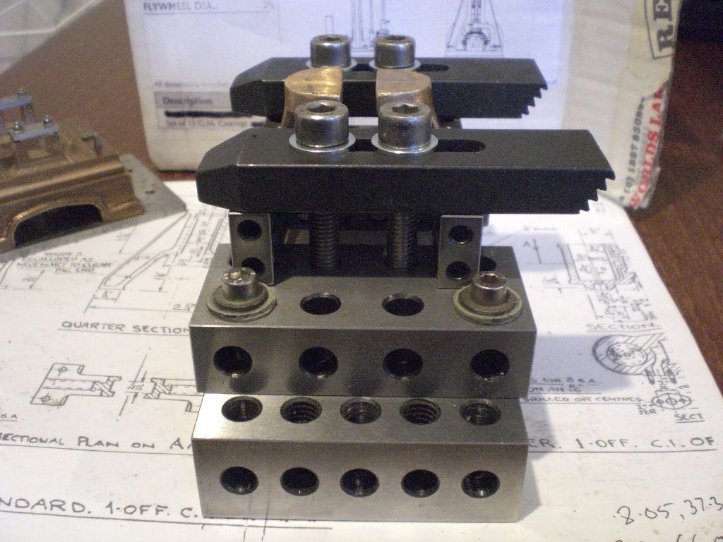

                      Posted by JasonB on 18/11/2020 11:02:55:
                      Very many thanks for taking the time to photograph the block and post it.
                      In my view, that's an odd combination.
                      With best wishes and thanks again.

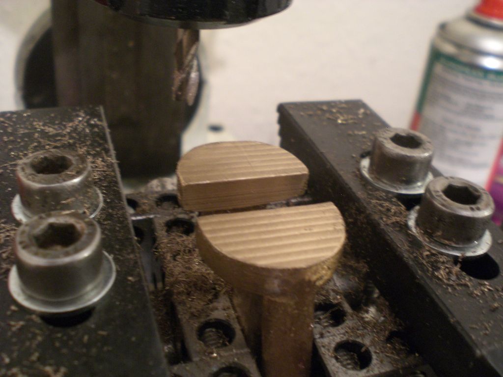

                            Hi MC, yes you might think it's an odd combination, but it is surprising how versatile the combination actually is. Below are photos of a set-up I did some while ago, using six 10-20-40, two 20-40-80 and two 1-2-3 blocks and it was all built up before setting into position on my mini mill.
                            If you look between the two hold down bars, you should see there are four bolts, two from each direction, nipping the two bronze castings between two of the 10-20-40 blocks.
                            Regards Nick.
                            P.S. you can actually only see three bolt heads, one on the left as the other is hiding behind one of the other small blocks.
                            P.P.S. corrected my 30 mistake to 40 after reading JasonB's post. embarrassed
