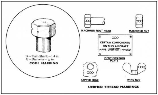

                  In the UK aircraft industry, unified threads were seen as the spawn of the devil. Purely due to the potential for mismatching resulting in dangerously reduced strength. All aircraft grade fasteners with unified threads had to be specifically marked with a symbol with three circles.

                    Any Unified nuts made for MOD were marked with the circles above, the hex bar before issue to machine shop was pushed through a rolling die which marked one flat for the whole length, that was back in the 60's.

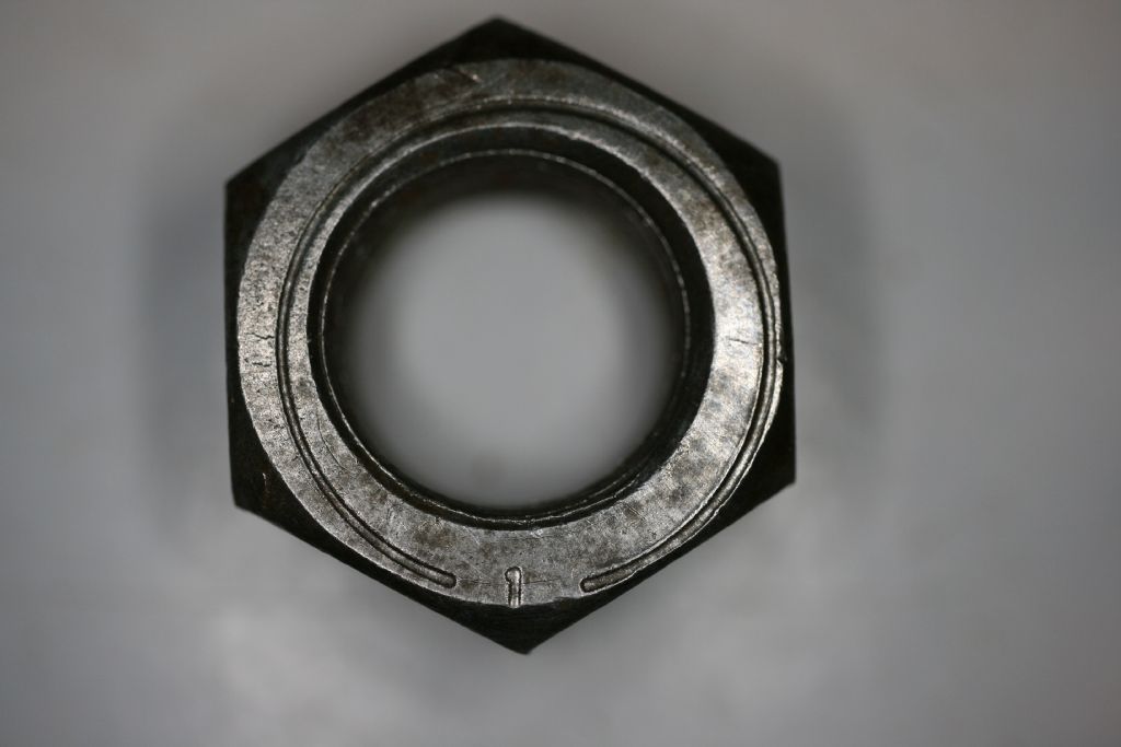

                                              Hi MC, my 1-2-3 blocks have 3/8" UNC threads in them, but 3/8" Whit bolts will screw into them OK, although they will wobble about slightly more than a UNC bolt does. I would say that for the most work that a home workshop is likely to do, a Whit bolt would probably be OK to use.
                                              Incidentally, the almost complete circle with the figure 1 in the gap as seen in the photo below, I have only even seen on UNF and UNC nuts.
                                              3/8" UNC threads will go tight into a normal 3/8" Whit nut.
