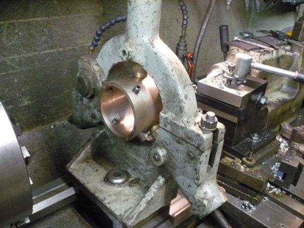

        It’s done for now. Wouldn’t score 9/10 one or two non-functional errors, but reasonably pleased with the outcome.
        I now need to address some shortcomings in my lathe! Whenever I do a job that’s harder /more complex than the last one, it always seems to flush out an improvement need…
        Steve
        #73347
        John Stevenson 1
          @johnstevenson1

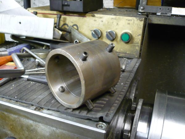

          Steve,
          Use a variation of a cat head steady.
          Simple tube with 3 or better still 4 set screws so you can get the OD running true.
          Then run the OD in a steady.
          Obviously scaled down to suit your machine.
          John S.

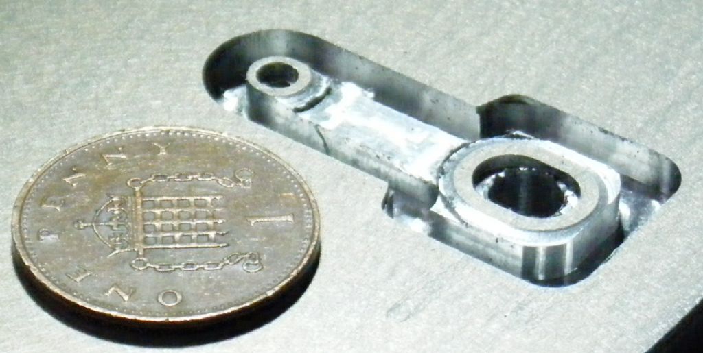

                                On my copy conrods are in section 6. To make it easier to find i added the main subject as part of the file name.
                                I would say your crank looks pretty good but there is no picture! Keep the tips coming. I’m doing the barrels via cnc, I don’t have Mr Whittles patience!
                                I am pondering the crank, do I do it the JS way or on the lathe?
                                Cheers Mike.

                                            I have been chugging along with my version of the Whittle V8.On my last attempt at the crankshaft I didn't bend it but I did manage to remove to much metal with the mill crying 2, and that was being careful! I gave up on the idea of CNCing the crank it was making my brain hurt. I am now working on the conrods, getting there slowly. The cap bolt holes were off to one side, think I've got that sorted now. I was hoping to do them M2 but there isn't enough metal so I am going to try M1.6
                                            Michael
